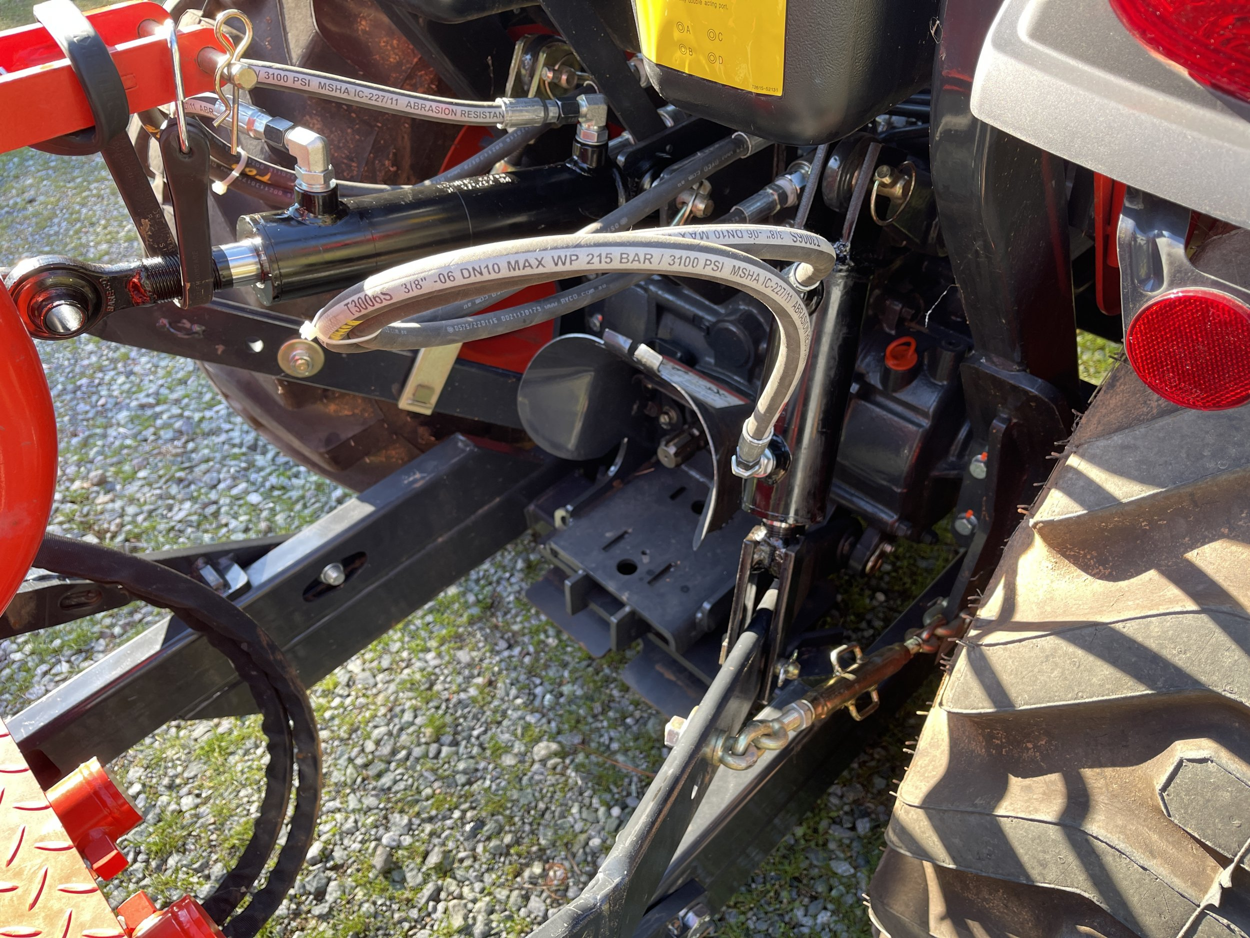

Just to close this out, because I just now installed another tnt. I went to a different kioti dealer to have one built. Picture of said assembly while adjusting hose angles. I have a .pdf that I created for the dealer with all pertinent measurements if anyone out there with a CK wants it.
   / Top n Tilt questions #13
As recommended by others on TBN, instead of a hydraulic link on one side and the OEM fixed length link on the opposite side, I replaced the OEM fixed length with the OEM adjustable link for extra tilt when it's occasionally necessary. Can't see which was used in the picture but it kinda looks like the fixed link.
#14
It’s the adjustable. That was also recommended by the kioti dealer mechanic.

To build the side link to be able to adjust an equal amount to the left & right sides like the OEM adjustable link and maintain the OEM lift heights, you need a 3" stroke cylinder.
With the (3") stroke extended to the mid point...the LOA should be the same as the solid side link...IMO...!
   / Top n Tilt questions #18
Exactly. CK10 series links are very short. There is not a lot of adjustment even with the manual adjustable link.
