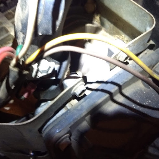

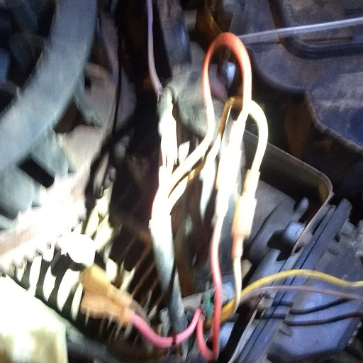

I'm starting to wonder if someone made some changes to this tractor before I owned it. I bought the new 32-707-01-S conversion kit. I started to work on it this morning. When I removed the "good" coil that I hadn't replaced, the number on it is the same 24-584-36-S on the coil I purchased for the other side. Tomplum, you mentioned the distributors portal shows a different number. Perhaps both coils had been replaced previously. If so, they worked perfectly fine up until one failed.
Next, the 2nd instruction asks you to disconnect both 3 pin connectors from the DSAI modules. My modules have two wires connected with spade connectors. They look nothing like what is in the picture. I am guessing the picture is of a different Courage engine, but wonder if what I have is original.
Last, the rest of the instructions are easy until I get to the instruction about cutting the white lead off of the three pin connector on the number 2 cylinder. As I mentioned I have only two wires. Neither one is white. When I look at the wiring that goes to each module. Each side has a brown wire. The number 2 cylinder's other wire is red. The number 1 cylinder's other wire is yellow. Could the original wiring harness have been replaced? Either way, which wire do I connect to the new duplex lead.
I hope all this makes sense. I appreciate the help.
   / Toro GT2300 bogging down #18
Of the wires that go to the ignition system, white is the wire that gets grounded when the ignition switch is turned off. What you don't want is any power going to those leads. If unsure, grab a multi meter to know which will be your kill wire and use that one. Out of curiosity, what is the part number on the coils inside the kit? A cursory check on your 24-584-36-S coil shows a Command engine for an application, not a Courage. I'll look further to see if I have any good info.
   / Toro GT2300 bogging down #19
Of the 2 wires that go to the module on the cover, that white wire should be the correct one. Best practice would be to check with a meter. You wouldn't want to confuse this with the regulator :)
#20
The number on the new coils is 32 584 08. There are also numbers 32410-02-6 and 1827209. I'm attaching pics of the wiring coming off of the smart spark module. There is a red power wire coming from the rear of the tractor along with a white ground. Both are connected to the smart spark using pin connectors. From the smart spark there's two short wires, red and brown that went to the coil on #2. Yellow and brown wires go to the coil on #1. I'm still not sure which of the wires to clip and connect to the new lead.
