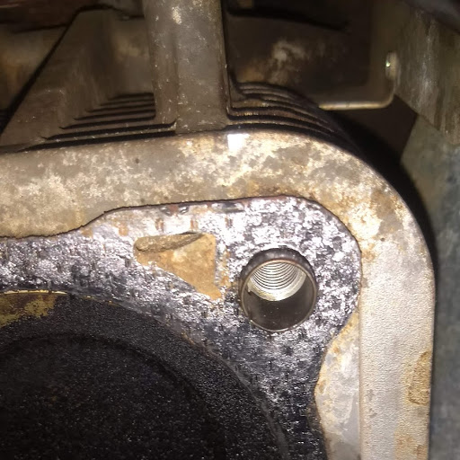

Of course when I looked up new push rods on ereplacementparts.com, I found two different numbers. My engine model 735 is listed, but the 4 numbers after the dash (0011 in my case) is not listed.
I also examined the cylinder. I do not see any obvious scoring of the cylinder walls. I am attaching a picture of the cylinder. I'm curious as to what the light brown substance is in the upper right hand corner is. It appears to be a blocked hole. View attachment 625676
maybe gasket material. you certainly have an oil fouled cylinder there, maybe you do need to have it looked at..
