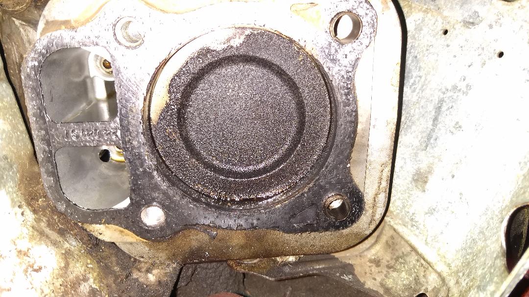

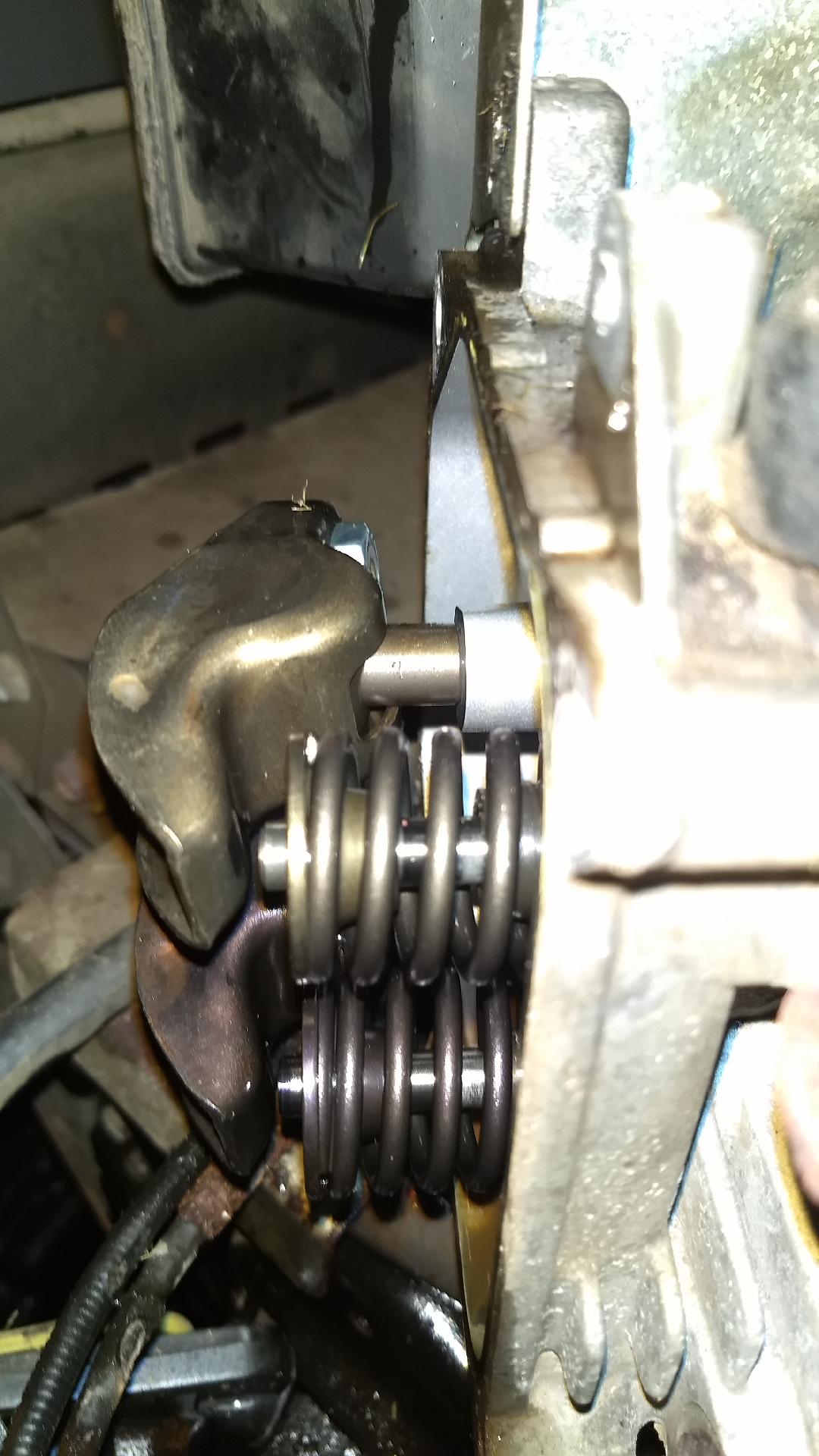

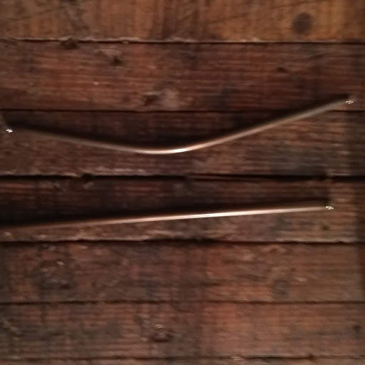

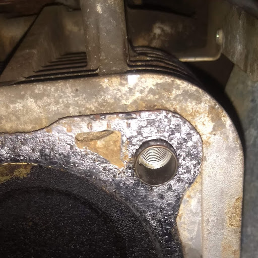

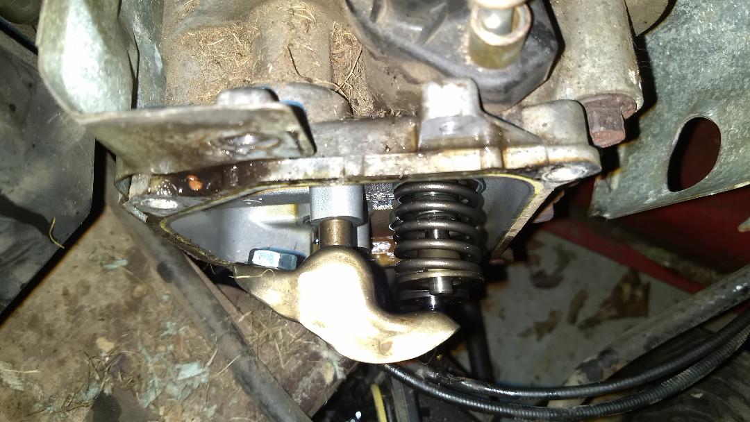

I got to work on my problem this afternoon. I removed the valve cover (1 broken bolt) and both push rods just fell out. One of them is bent. I also pulled the head off (2 more snapped bolts from the heat shield) I'm attaching some pics of the pushrods, the valves, and the piston. My first guess as an amateur is one of the valves is stuck badly enough to bend a push rod. Where I go from here, I'm not quite sure of yet. Obviously I'll be doing some research, but all help is appreciated. tor2.jpgToro1.jpgtoro3.jpgtoro4.jpg

What sometimes happens is if you have a loose rocker and one push rod drops out, the other will bend from the compression. Other times the valve guide migrates forward so that the spring keeper hits the guide and bends the rod. It could migrate rearward holding the valve open also. Tying this in with an intermittent runability issue may indicate that the exhaust seat is loose. Now the valve not able to close drops the 1 rod and the other bent. The Courage has solid lifters so there shouldn't be an issue there. The need to move freely.
What I would do: Disassemble the head. The springs are light enough that you can do it with your fingers if you support the valve head. Check that the valves move freely in the guides and that the guides are in similar positions. I seem to remember that they are slightly different, but the manual should reference that. Next check out the seats to note if they are secure or show signs of being hammered due to being out of position. Decarbonize the valves and give them a roll on a smooth surface to check for trueness. I can't see from the pic if the cylinder bore shows signs of wear, but you will want to check that out too.

I also need to get the broken bolts out of the head. The valve cover bolt should be no problem. The two from the heat shield bolts don't look like fun. My success rate with easy-outs and small bolts is near zero.

I also examined the cylinder. I do not see any obvious scoring of the cylinder walls. I am attaching a picture of the cylinder. I'm curious as to what the light brown substance is in the upper right hand corner is. It appears to be a blocked hole. toro5.jpg
   / Toro GT2300 bogging down #50
You didn't really say what else you had found with the head. Kohler heads do not come loaded and you have to buy just about everything. Maybe a used head that looks good if you need one? If the cylinder walls look ok and you find no obvious slop where you can rock the piston sideways in the bore- that at least leans towards being fine. You certainly want head and exhaust gaskets. Others are bonus but good to have .
