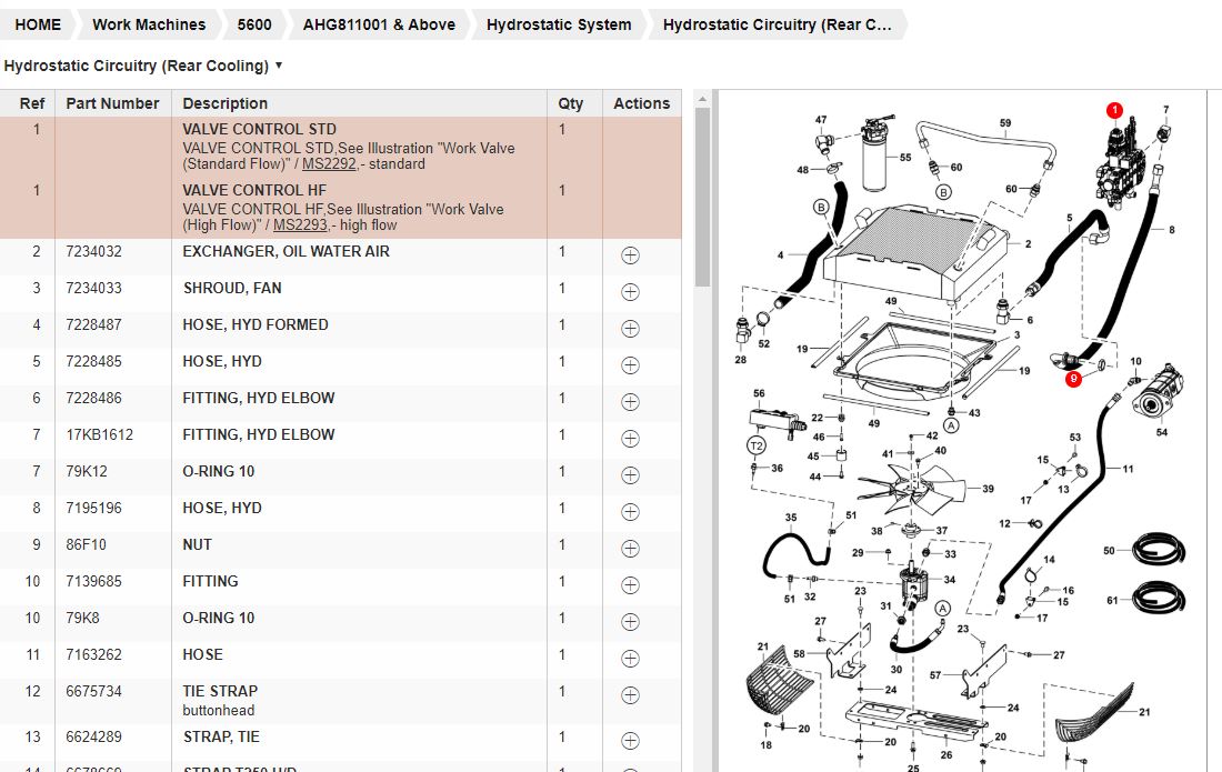

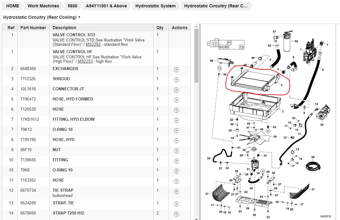

Honestly if you have a bunch of other equipment that has 3 point and pto I dont know why you'd go with the 5610. As far as overheating goes I wonder if anyone actually has a problem with a current 5600. It looks like they significantly increased the hydrostatic radiator with the AHG8 (2014+?) machines. See attached. I wont start mowing with mine til the grass starts growing this spring.

Great post. Thanks for the diagrams on the early/late designs.

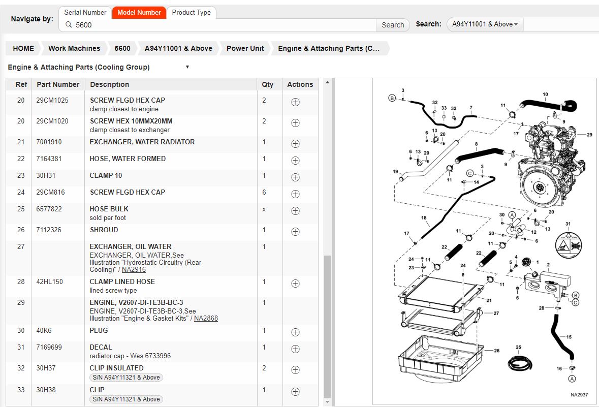

I dug in it a little further. The A94Y and older machines have two separate radiators, one for engine coolant and one for hydrostatic fluid. In 2014 they combined those radiators into one so now the hydrostatic oil and coolant are an oil to water exchanger and then both cooled by air. A94Y radiators.JPG
