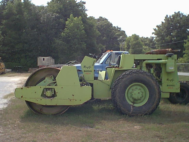

Here are some basic ideas, our vibratory rollers are approx. 2 tons, some models are 3. Our static steel wheel rollers are in the neighborhood of 6-8 tons.
I'll attatch a pic of our 3 ton unit. a yellow yardstick is included as reference. ( the 2 ton unit is just a smaller version, and seems to work fine )
"foot drive this way, but I could benefit from a roller going over it. That is why I would like to know how much pressure is required to roll the crusher run into the hard, ready-for-paving surface I have described? Can I do it with the roller I have described in my earlier post? I doubt it will work without a vibratory device, but what about with one?? "
Soundguy
