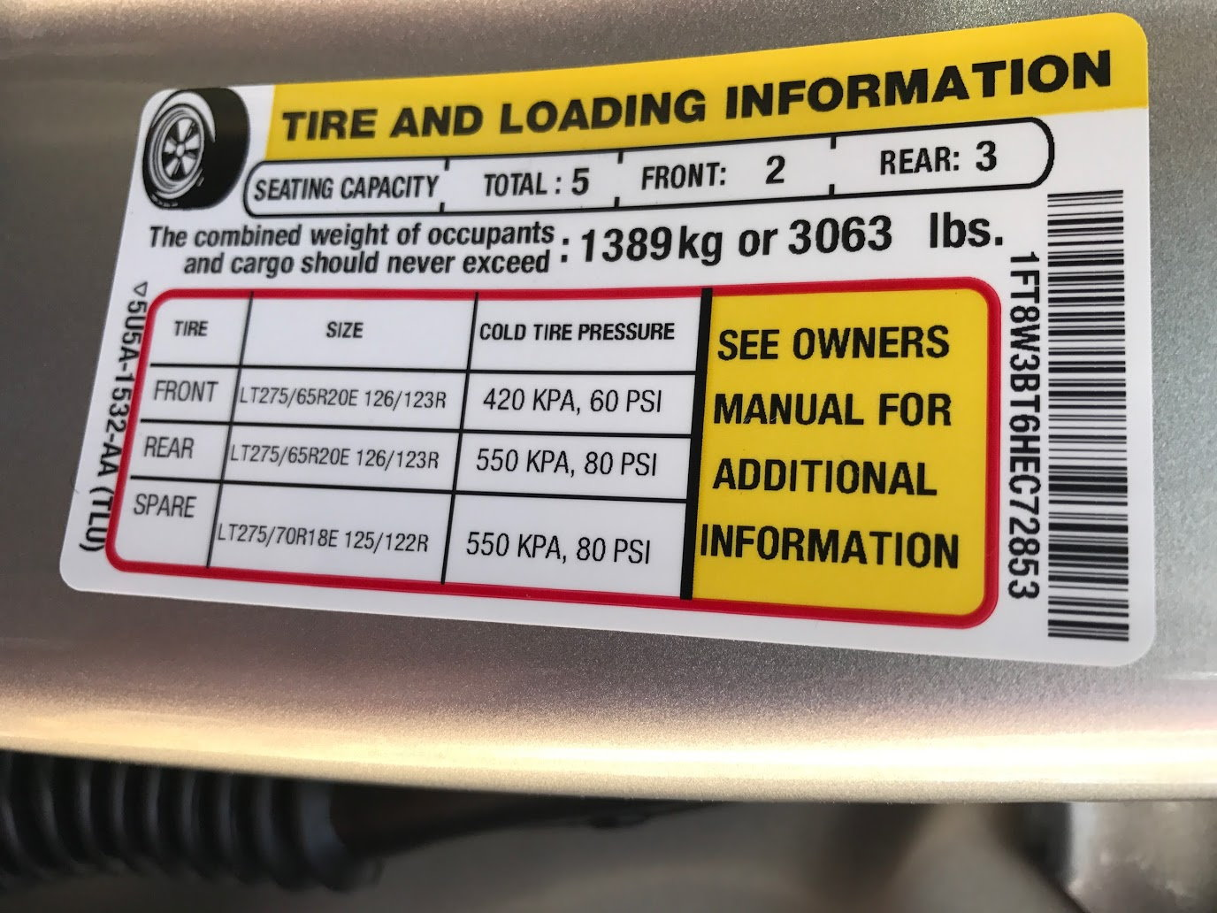

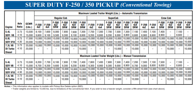

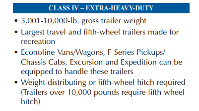

When shopping for tow capacity one must download a couple PDFs from Ford and become a good student of the contents. Not all F-150's with HDPP and Max-Tow are capable of 10.1k or 13k towing.

I use a 2014 F150 Ecoboost for loads under around 8,700 pounds. It does fine, just get hit with a MPG drop. Truck is rated for 10,500 hitch pull (with weight distributing hitch).
That is the number printed on the hitch receiver. That is not the tow rating for your truck. To get actual tow rating requires research and calculation. For some reason Ford won't say it outright, nobody does for their trucks either.
The 10.5k rating F-150 will be a single cab with HDPP package. Unless you have 7 bolt wheels you do not have HDPP.
