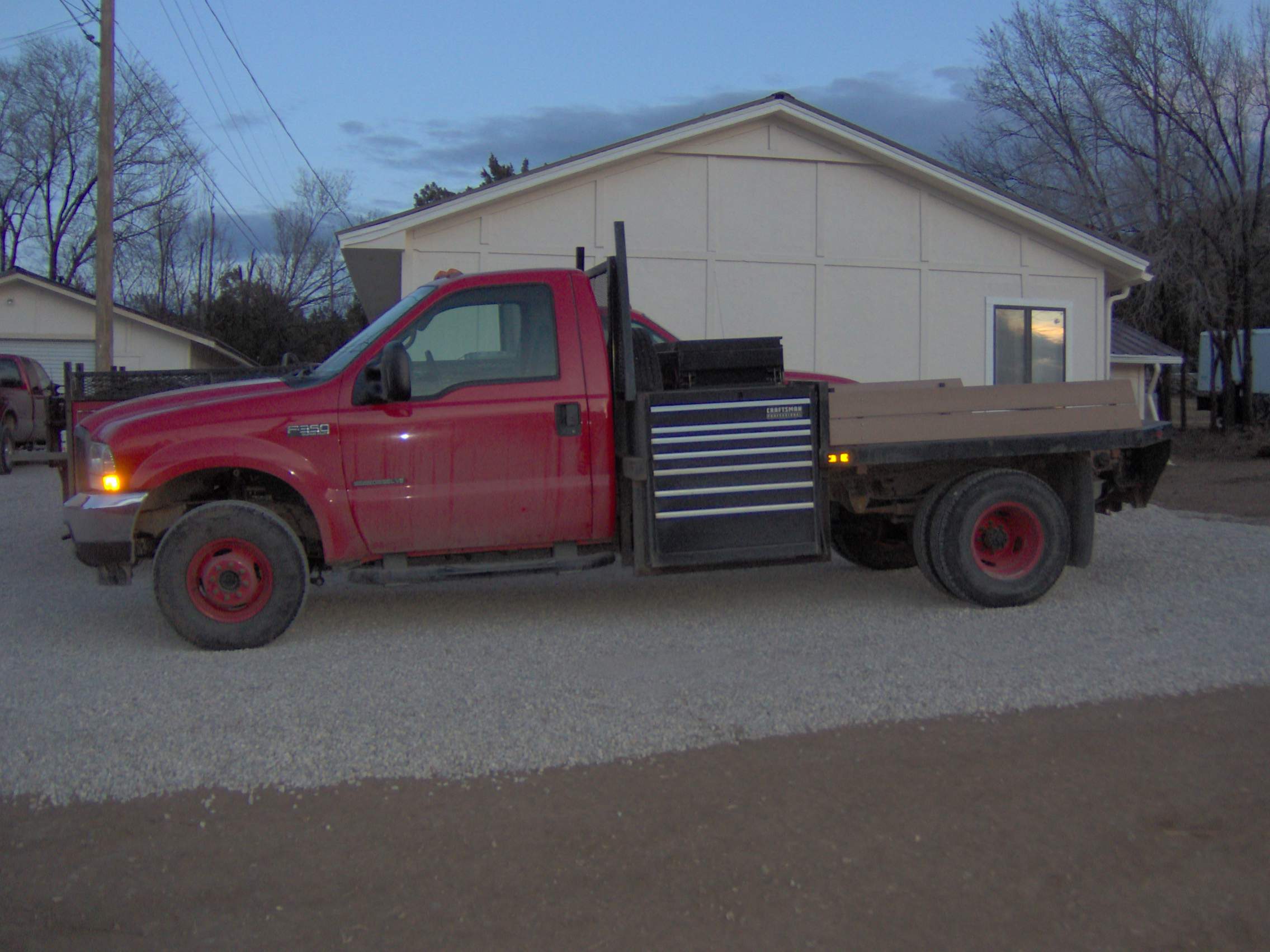

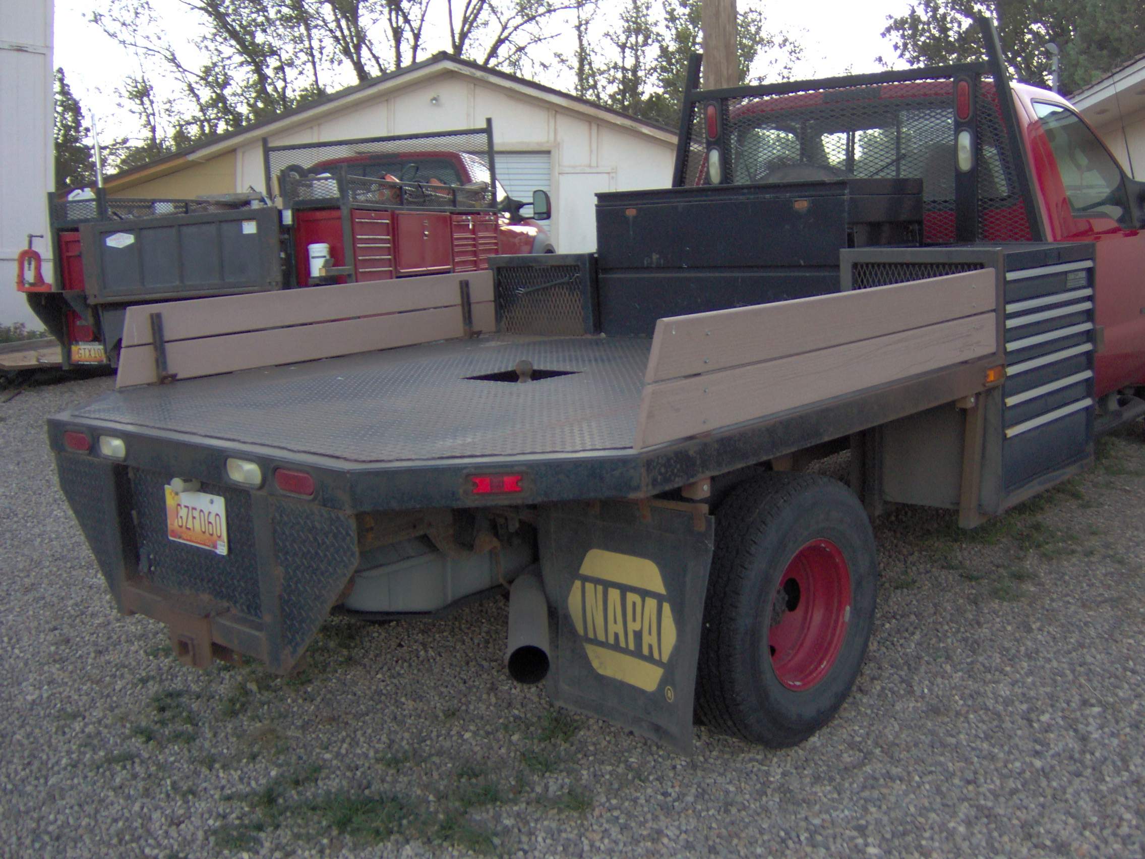

When I built this flatbed I clipped the corners to allow more clearance as it is a full 8' wide. You mentioned tool boxes on your bed, make sure everything works before buying the camper. This bed is 11' long and tight turns I still have to watch out for the center jo box. Most of the CC beds are built with a 48" overhang rear of the axle but a measuring tape will help you more than any of us can. How far forward of the axle the coupler is positioned is a big factor too.
