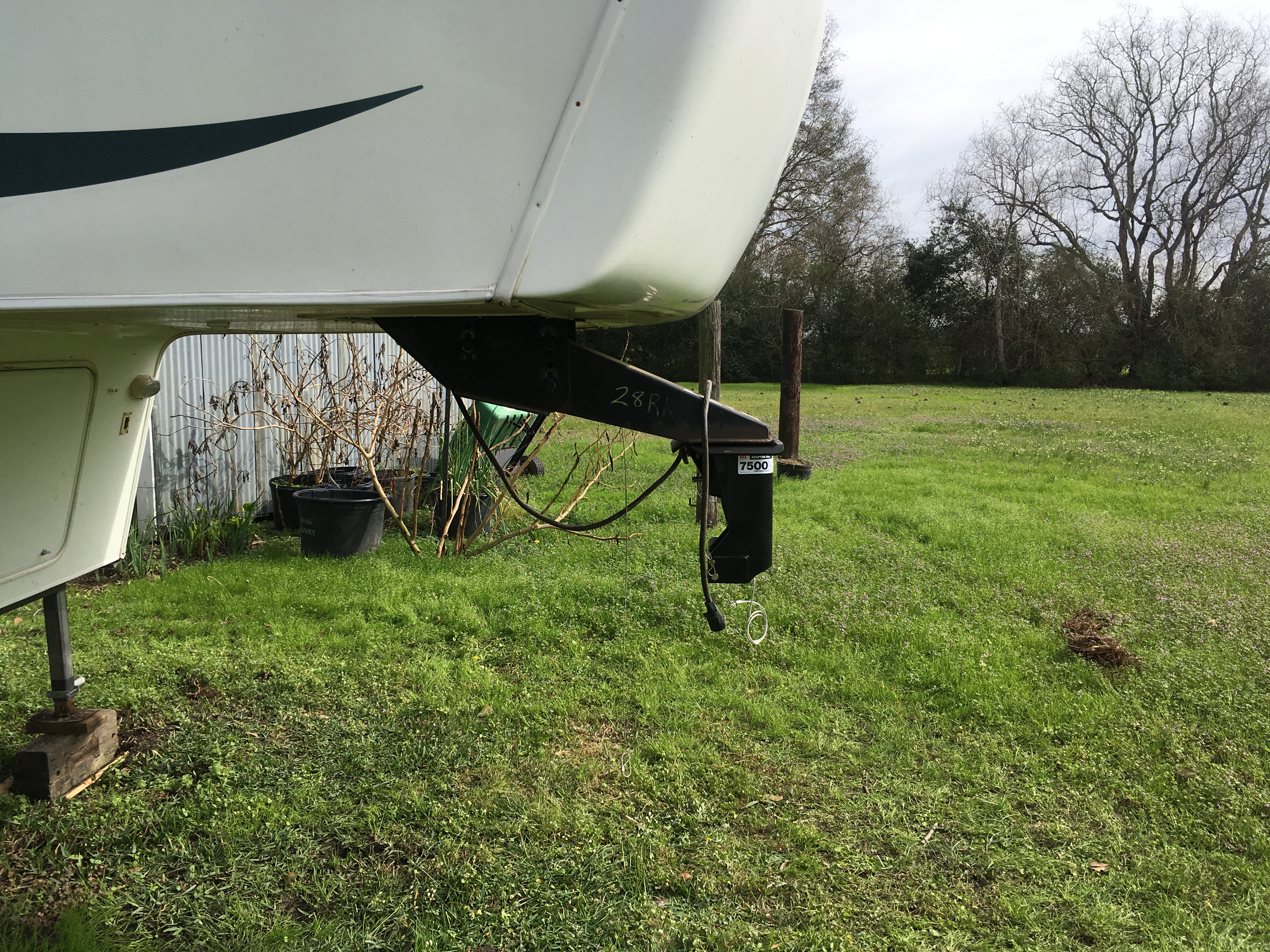

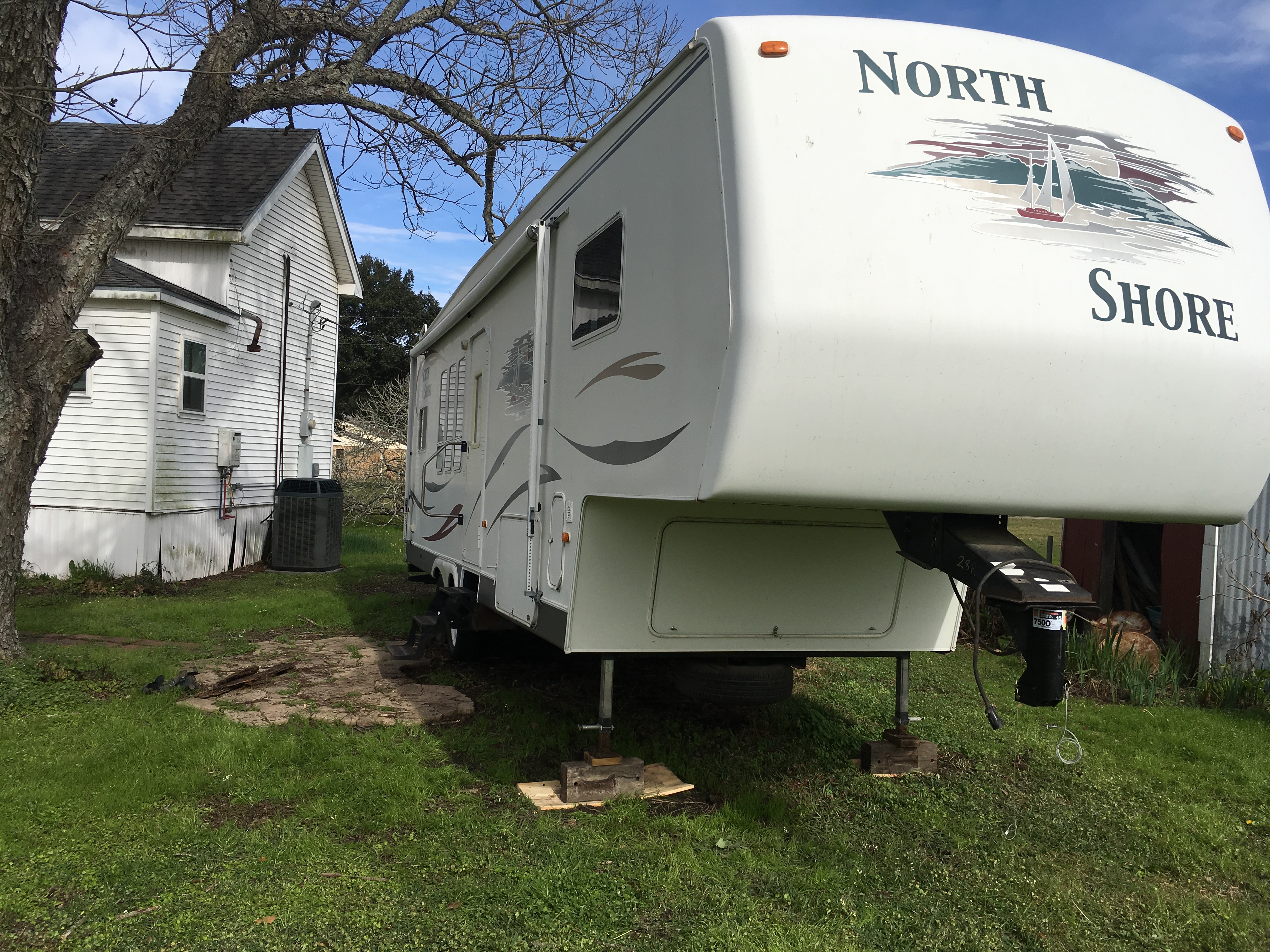

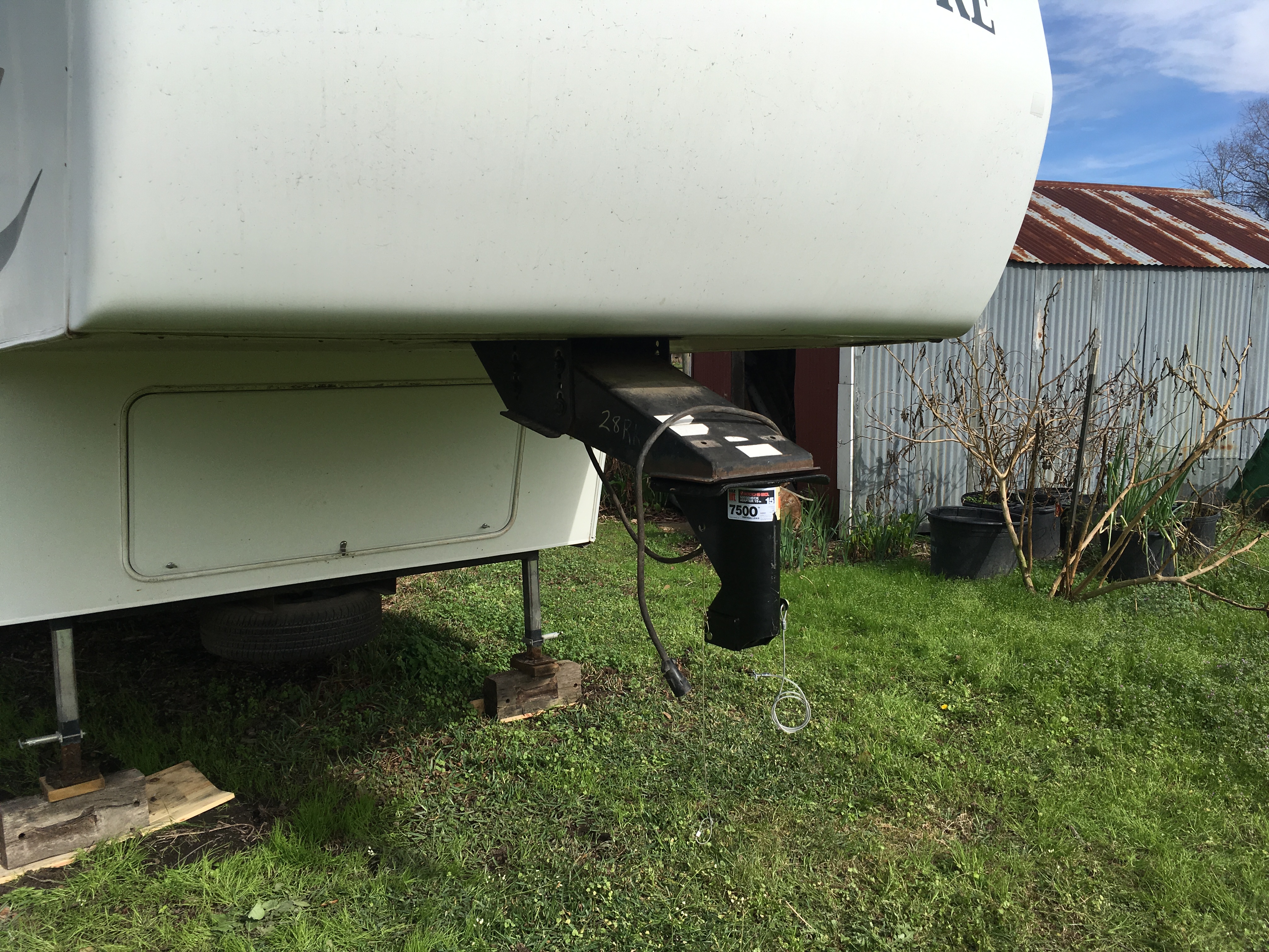

Today, I went and installed 2 new tires. The ones I replaced had blown out while parked where it is now. They were the original 2004 tires that came with the camper. I went with 10 ply rated trailer tires. The originals were 8 ply.
And, I got the gooseneck adapter installed. Since we were going to move the kingpin down to the lowest hole anyway, we removed it to install the adapter, which made things much easier.
Now, I have about 27" from the bottom of the gooseneck adapter to the bottom of the camper. This should give me about 6" clearance over my toolboxes. But, this will also make the camper ride higher in the front while towing.
I'd rather have it ride high in the front than take a chance of it hitting my toolboxes while towing.
It's still to wet to get to it with my truck and attempt to tow it. Maybe later in the week it will be dry enough to try.

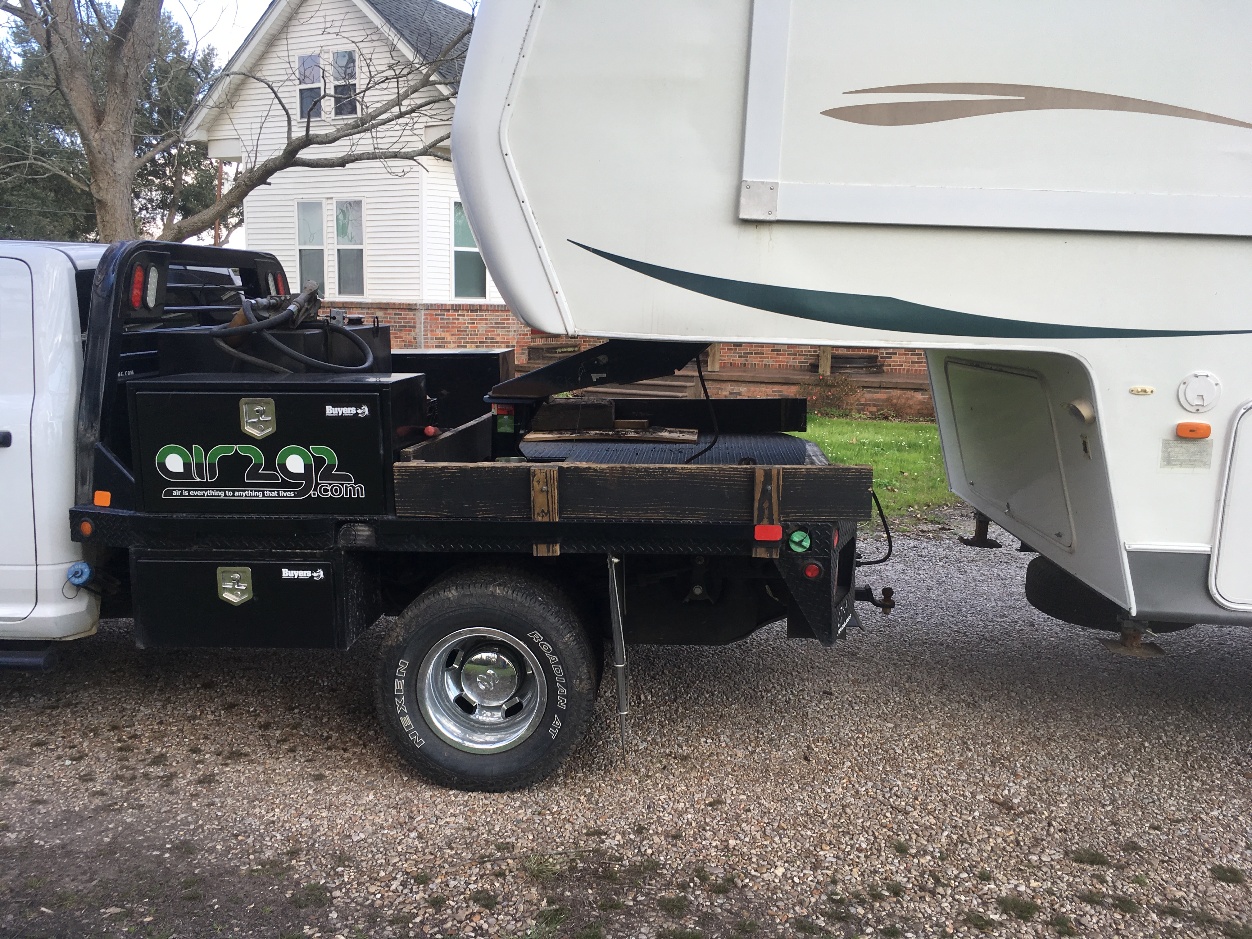

Success!!!
Weatherman says rain tonight, so my brother called and said "Come get it TODAY!!!"
So I stopped by my trailer dealer and picked up 2 new tires and rims and hooked it up and got it out, then changed the 2 rear tires and headed home. Everything went well. All of the lights work and the brakes work. Clearance above my tool boxes seems to be plenty. The trailer is traveling with the nose up slightly, and I'm OK with that. If I were to get at a full 90* angle while hooked up, it might get to my fuel pump.

I love my EZ-Lift adapter, and hopefully you'll like it too!
Judging by the picture, I don't think you'll have problems with that setup, at least not for limited towing. The extended pin box on that trailer is not ideal if you're going to tow it a lot, but it'll be fine for a few trips a year or less. Both the extended pin box and the gooseneck adapter put more stress on the trailer frame than a standard 5th wheel pin box would, and lippert frames are not really known for being overbuilt in the area of the pin box... Just be gentle with the brakes and throttle, and slow down if the road is rough.
No need to worry about being a little nose high. On a trailer with spring axles and equalizers between them, the weight stays relatively even between the axles until you start getting the equalizer really out of level, like near the limit of its travel. (That's why it's called an equalizer...) The ones to worry about are trailers with multiple torsion axles, where there is no equalizer, only the limited "suspension" of each axle. Torsion axle trailers MUST be level to keep the axle loads even.
Hope you enjoy your new hunting "cabin"! :)
