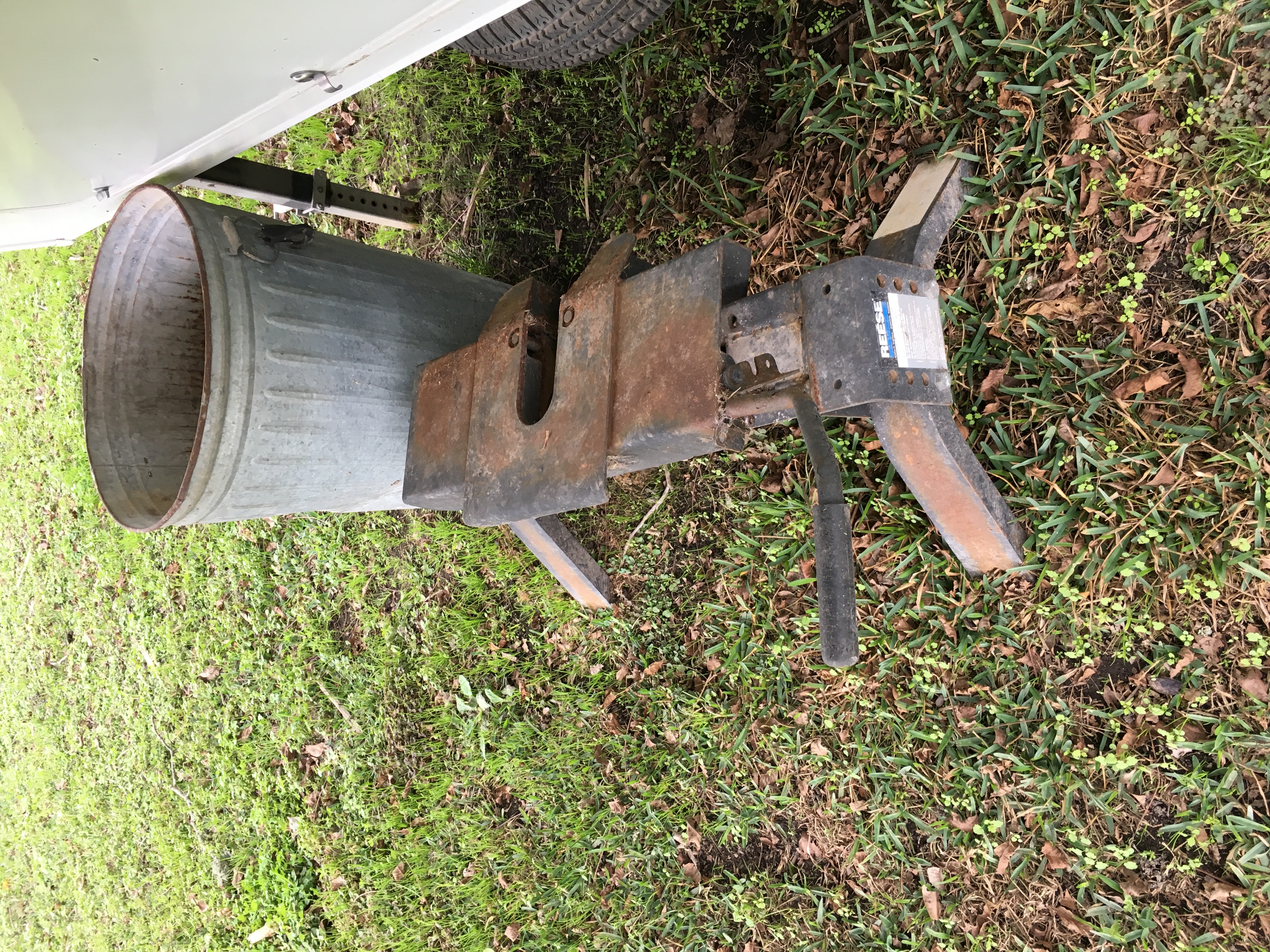

With all the rain today, I had time to make it to the camper for some measurements.
I think that my bed is short enough that it will not be a problem. The distance from the kingpin to the camper is about 78" and the distance from my ball to the back of my bed is 60" and from the ball to the corners of my bed is about 69", so I don't think that will be a problem.
However.....as the camper sits now, the bottom of the 5th wheel plate on the camper is 41" off the ground. My truck bed is also 41" off the ground. I'm afraid that if I get a 16" adapter, I won't be able to tow the camper in a level position.
And, I'm afraid that if I get an 11" adapter, the camper won't clear my toolboxes.
As the 5th wheel hitch is on the camper now, there is about 11" of clearance between the bottom of the hitch plate and the bottom of the camper. There is room to move the 5th wheel plate down about 1", which would give me about 12".

Not to rain on the parade. Does the front of the 5er angle forward as it goes up? If so check the clearance there. Worst situation is going over a sharp rise (tail of trunk moving up) and in a turn. I have seen a lot of 5ers with damage to the underbelly of the overhang, and dented truck bed corners as they did not have clearance between the 5er and truck bed. I have 8" and that is not enough at times (I have the dents on the overhang too). Also the other part that will interfere is the truck bumper or hitch.
So measure carefully at the angles .
BTW I doubt you would get into you tool boxes with the trailer as the front sits behind the king pin. only chance would be at a 90 degree jack knife, and you can prevent that.
Hope this helps
OOPS - I just noticed in the picture of the king pin housing. There appears to be bad damage to the wiring on the back side of the king pin. Take a look - this is the primary wiring bundle and can be an expensive fix if I see what I think I see.
   / Towing a 5th wheel camper with a 9' flatbed?
#38
I think what you are seeing in the pic in post #33 is grass from a bird's nest that was built up in the housing. If you look back in an earlier post (#23) the wiring seems to be intact.
