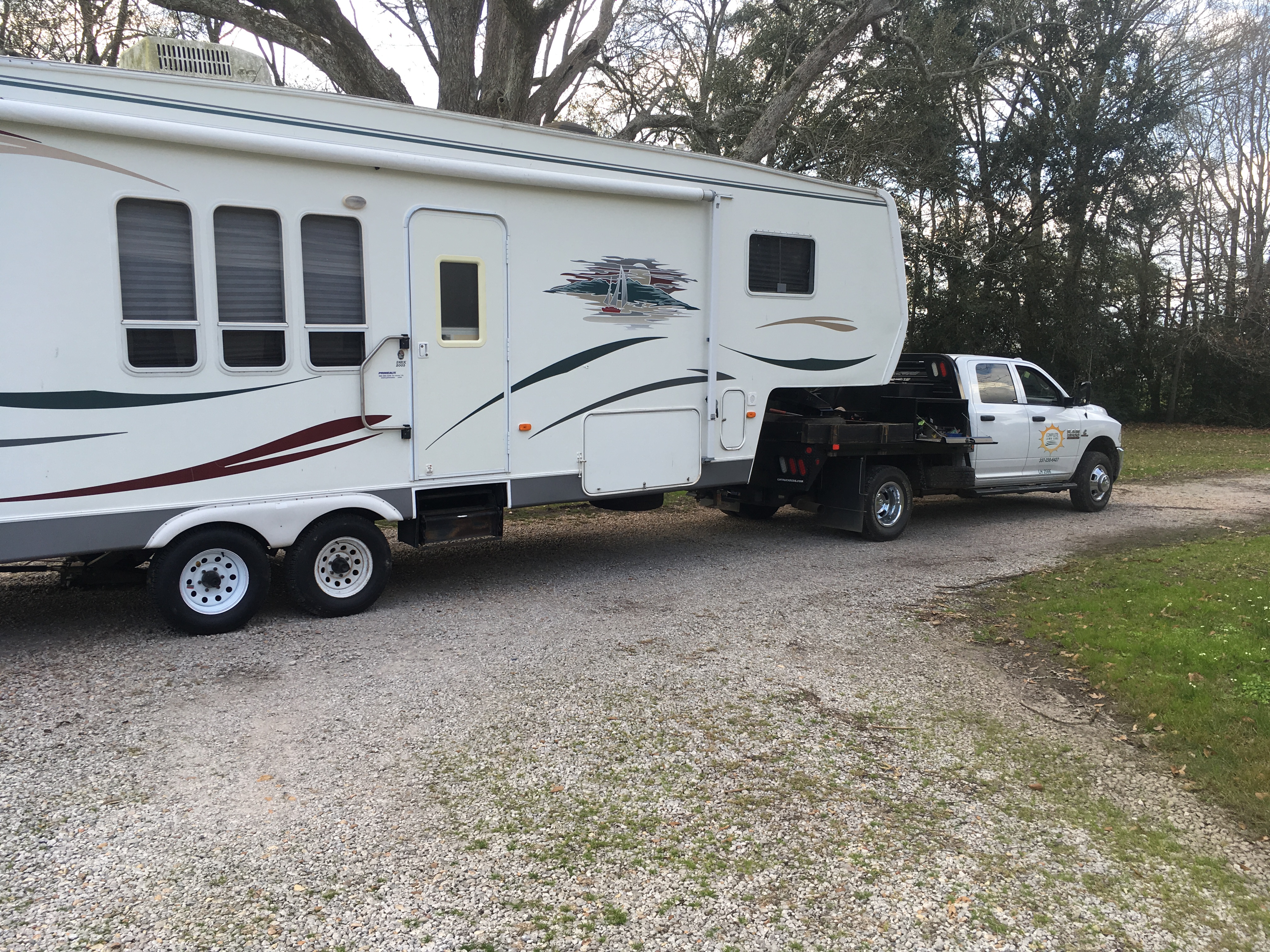

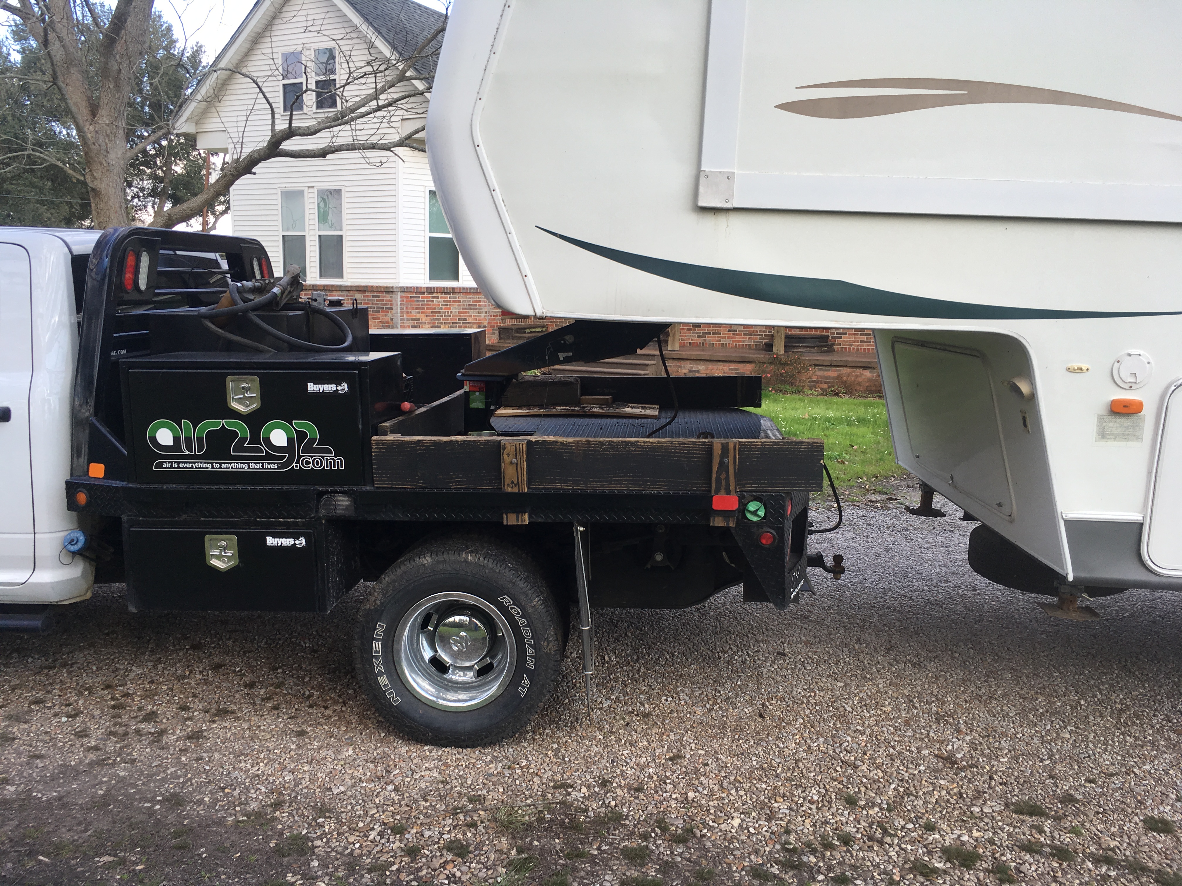

   / Towing a 5th wheel camper with a 9' flatbed? #57
Success!!!
Weatherman says rain tonight, so my brother called and said "Come get it TODAY!!!"
So I stopped by my trailer dealer and picked up 2 new tires and rims and hooked it up and got it out, then changed the 2 rear tires and headed home. Everything went well. All of the lights work and the brakes work. Clearance above my tool boxes seems to be plenty. The trailer is traveling with the nose up slightly, and I'm OK with that. If I were to get at a full 90* angle while hooked up, it might get to my fuel pump.
Thanks again to everyone for your advice. View attachment 497375View attachment 497376
I can't tell by the pics but it looks like the camper will clear the boxes on level ground but if you get on some uneven terrain it may be different.
