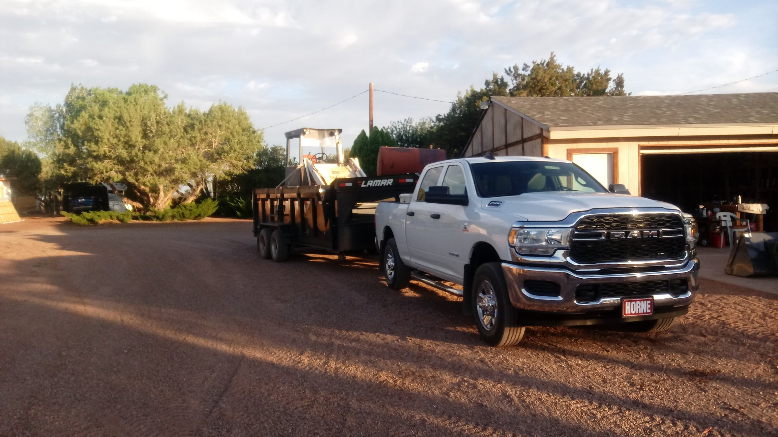

Around 2" is just right for my 2500HD also. 5-6" would be ridiculous and have my headlights aiming into people's faces. Note, if you have a 1500 pickup, you might need a 5" drop to have safe tongue weight.
   / Towing capacity #112
I disagree. 5" or 6" is way too much. 2"-3" is enough. If my new Ram 2500 dropped 5" it would be on the axle/frame stops.
Note the gap in the front/rear fender wells, I am down in the rear about 2.5", truck is maxed out. If the rear went down another 3" it would be ugly.
Agreed, the manufacturer actually puts most trucks a about 2-3in high in the rear and they should be about level when loaded.
If you look at the front "leveling" kits for p-ups they typically add about 2-2.5in of lift.

With a 5th wheel towing arrangement you are in a totally different circumstance. The exact same load on an identical trailer (but one with a hitch ball tow arrangement for a receiver hitch instead of a 5th wheel pad) WOULD lower your rear bumper by a lot more than 2-3 inches.
   / Towing capacity #117
I don't have a 5th wheel... I only bumper tow. My '03 2500HD has ~3200 lbs payload capacity, so 1000 lbs of tongue weight doesn't slam it down very far. With all due respect please don't assume you know more than someone else's experience without understanding their towing setup whatsoever.
   / Towing capacity #118
My apologies -- I mistook you for the #111 post guy who shows a photo of the 5th wheel he is using. Don't assume what I assume, with all due respect...
