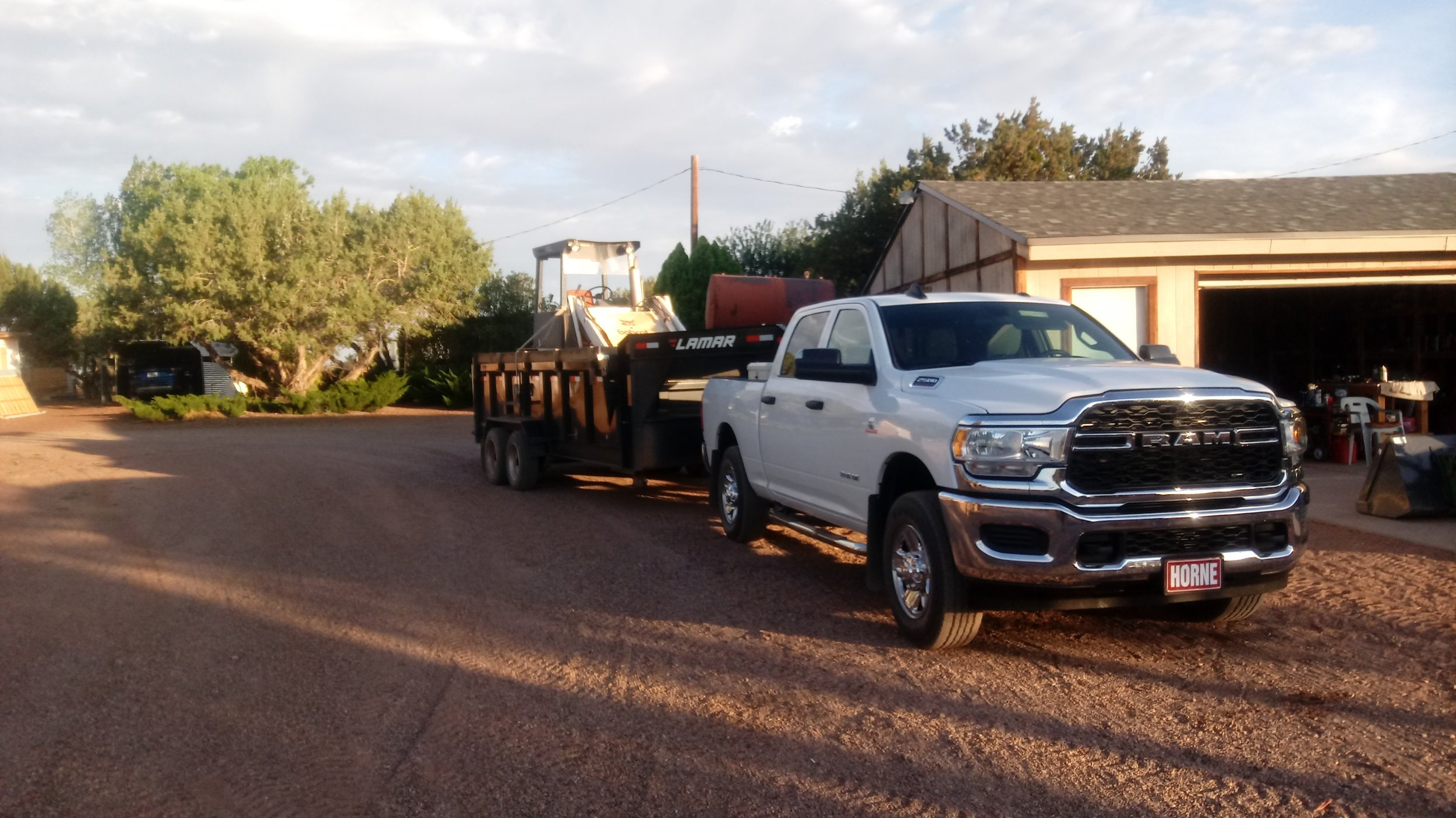

I disagree. 5" or 6" is way too much. 2"-3" is enough. If my new Ram 2500 dropped 5" it would be on the axle/frame stops.
Note the gap in the front/rear fender wells, I am down in the rear about 2.5", truck is maxed out. If the rear went down another 3" it would be ugly.
