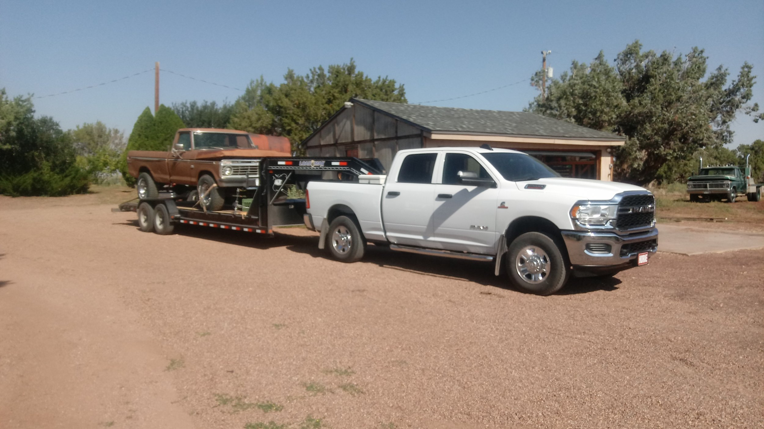

Now that I am loaded, the truck is perfectly level. 8.5" fender well gap front to rear. So about 10k gvw on the truck, 19k gcw. Going on a 3 day truck pull in Willcox, Arizona:)
