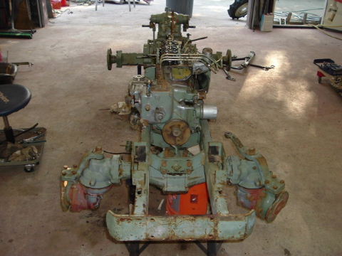

   / Tractor advice #15
found pix of what I suspected were FWD parts not original to the tractor. After the tare down and parts inspected, we found many items needed replacement.

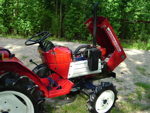

   / Tractor advice #16
picture of finsihed product.
