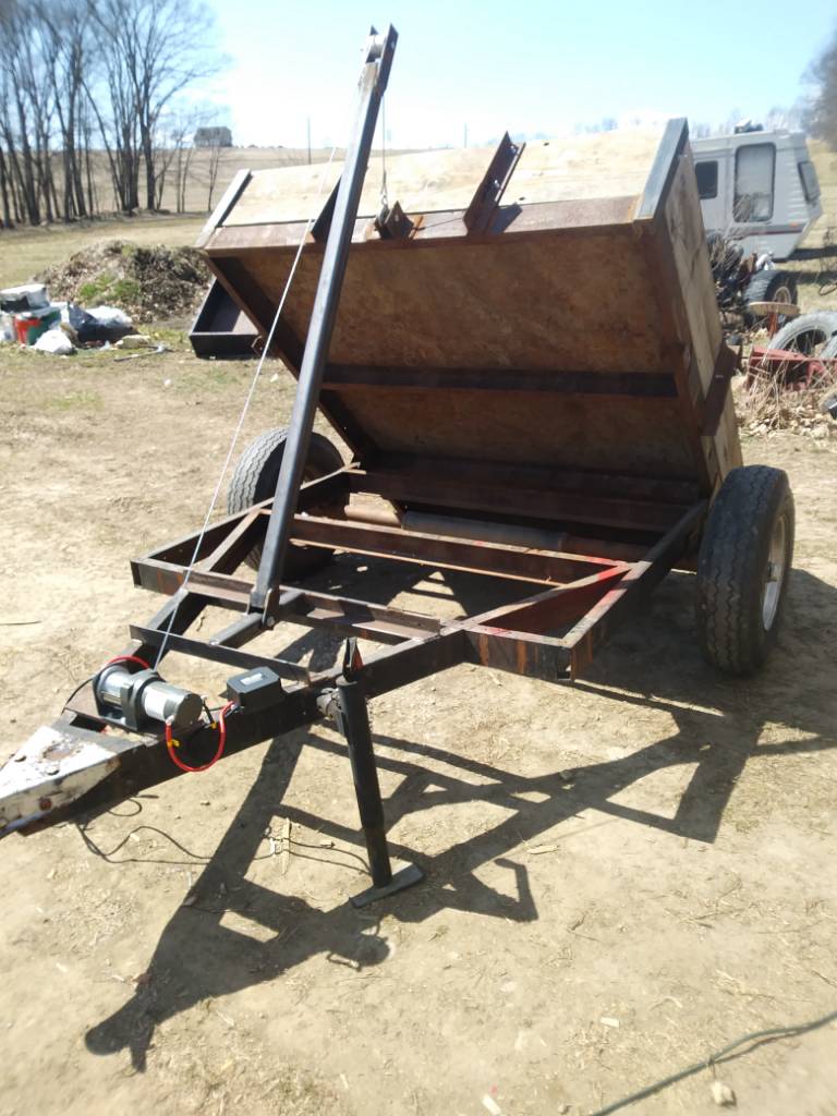

Pretty much ready for testing. The goal will be able to dump 3 bucketfulls from the BX of dirt or rock. We will see. 0403191412.jpeg
   / Tractor/Atv dump trailer #26
nice. you could use the pole and winch to drag a tree stump or piece of equipment up there too. I like it.

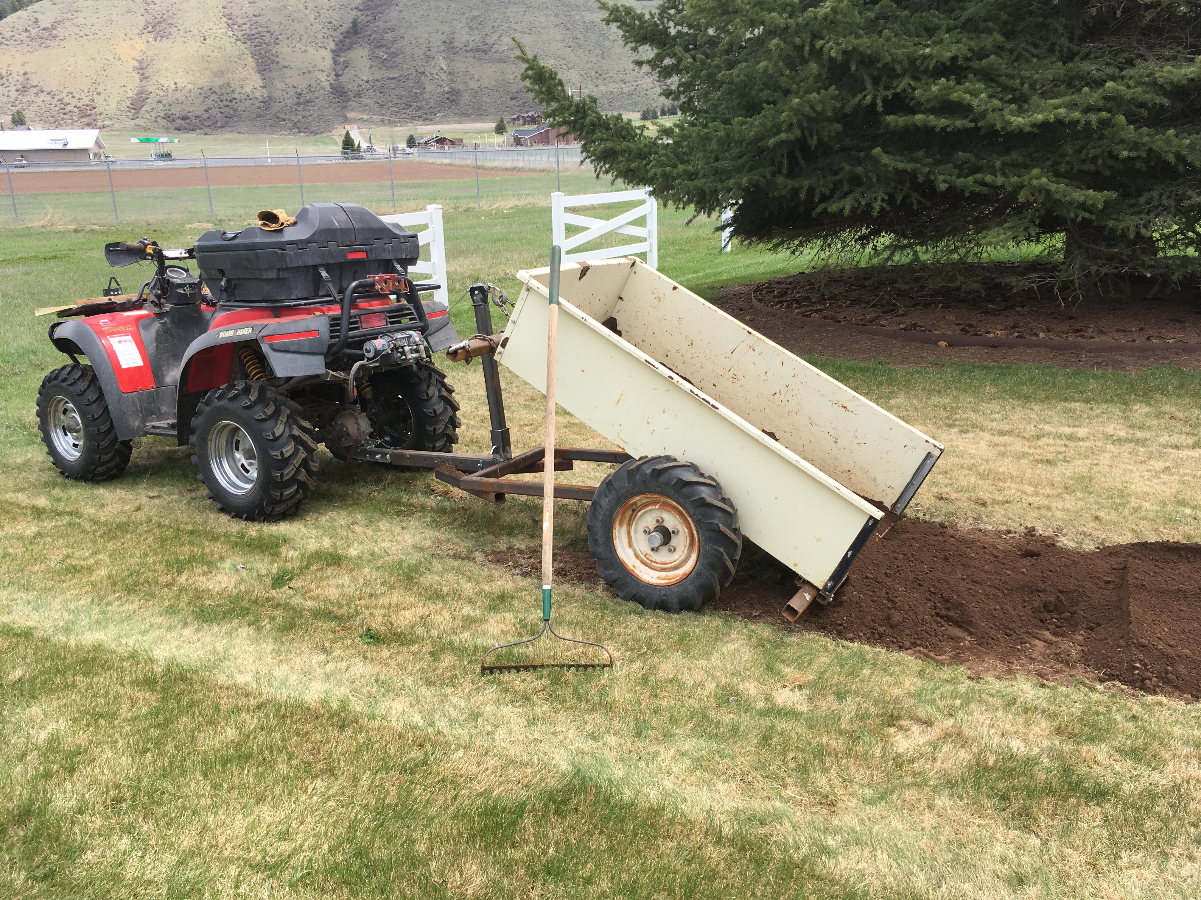

You did pretty much the same as I did on my ATV trailer.
The difference is I have the Warn Multi Mount system on my ATV so I can move the winch from the front to the back of the ATV. I do need to change mine so I can tip the trailer up a bit further. To do that I will build a scissor system under the trailer.

Are you using an on board battery or something else?
I was wondering the same thing... But I like it. Looks good. I don't think I will be able to use much of your design for mine because I am really trying to go the stand alone hydraulic route but we will see it I can actually make it work. I may have to use the winch even if I don't want to.

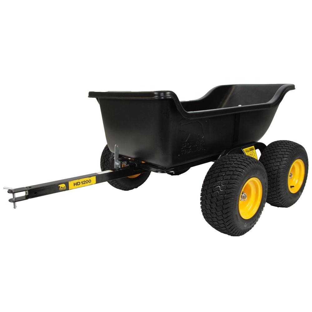

I have one of these, Polaris made it, pretty indestructible..
