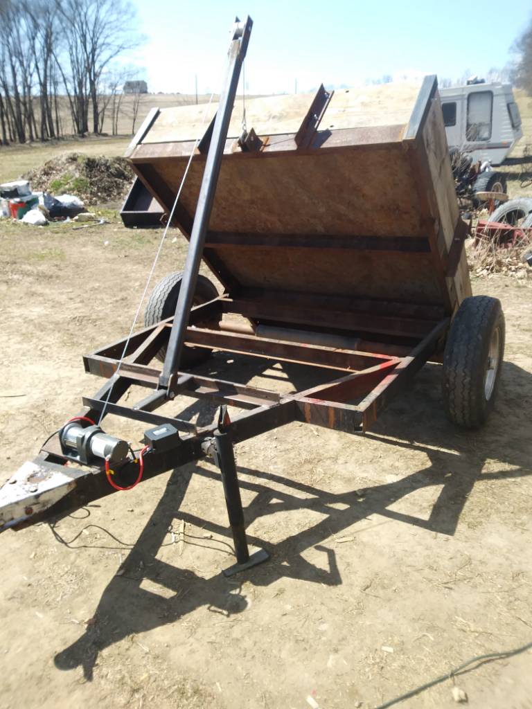

Pretty much ready for testing. The goal will be able to dump 3 bucketfulls from the BX of dirt or rock. We will see. 0403191412.jpeg

nice. you could use the pole and winch to drag a tree stump or piece of equipment up there too. I like it.

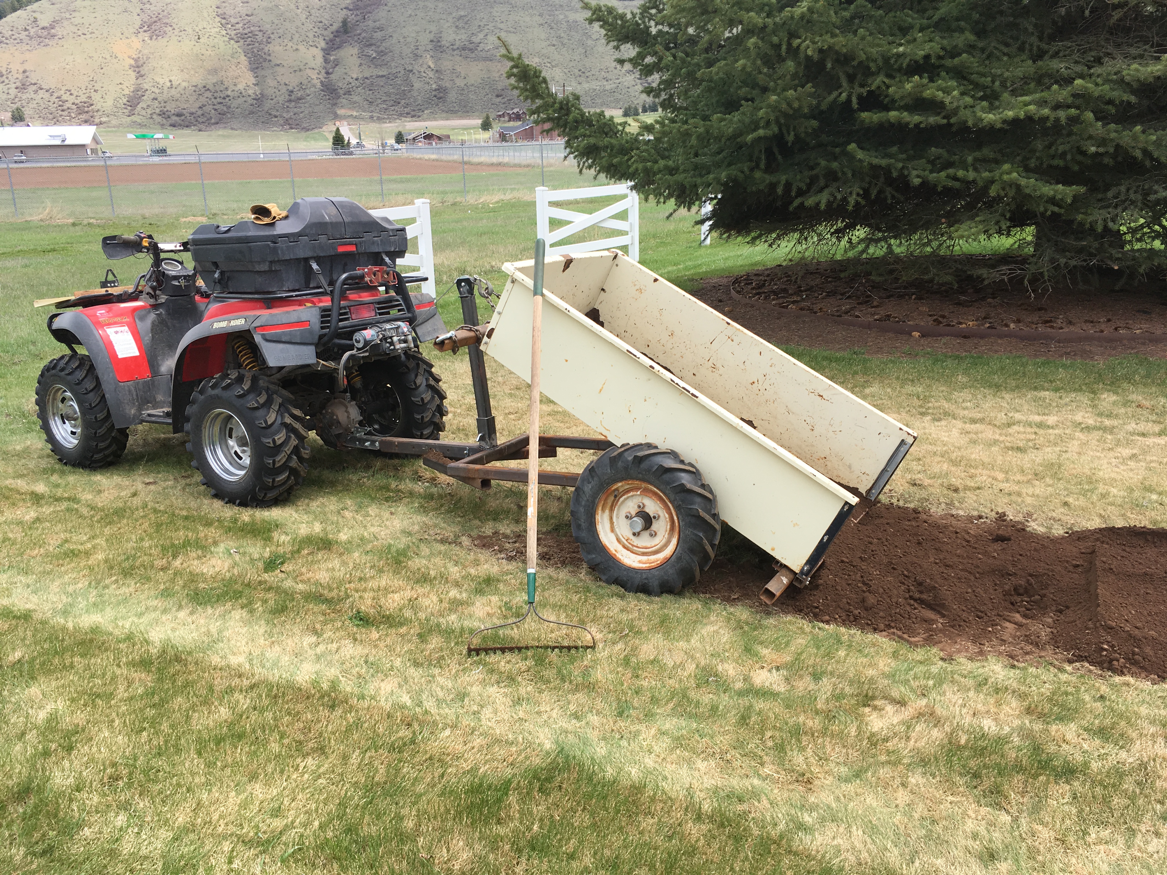

You did pretty much the same as I did on my ATV trailer.
The difference is I have the Warn Multi Mount system on my ATV so I can move the winch from the front to the back of the ATV. I do need to change mine so I can tip the trailer up a bit further. To do that I will build a scissor system under the trailer.

Are you using an on board battery or something else?
I was wondering the same thing... But I like it. Looks good. I don't think I will be able to use much of your design for mine because I am really trying to go the stand alone hydraulic route but we will see it I can actually make it work. I may have to use the winch even if I don't want to.
Currently all I have is a stand alone small mower battery to test and it's condition is suspect, I was able to lift 2 buckets of dirt on the initial test with no problem at all,,,,, so why not try 4 buckets, again lifted it.
I suppose what I would like as a permanent setup would be a dedicated battery able to be connected to the tow vehicles charging system to extend run time when necessary.

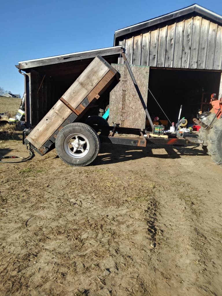

Pretty steep dump angle shouldn't have issues getting material to come out.0403191749_HDR.jpeg

I used it yesterday to haul about a dozen loads of rock and found some issues which I hopefully remediated today. Most pressing issue was breaking the bottom bolt on the pole, I used a 7/16 bolt initially and have gone to 1/2 diameter. Anytime the bolt broke I found the winch cable between the upper roller and the side plate, put the roller in the lathe and cut a groove for the cable to ride in. Another thing I didn't like was the winch cable, unspoiled it and cut half of it off. Other than that it worked as planned.
