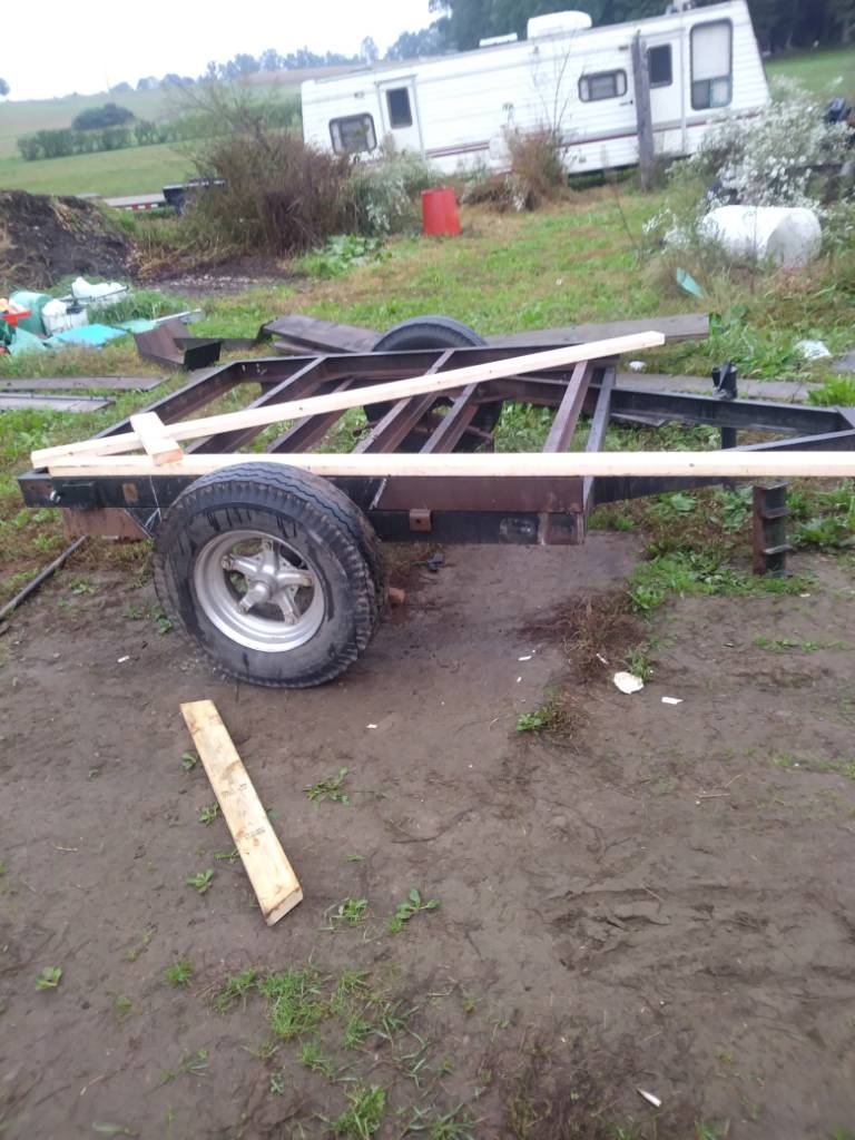

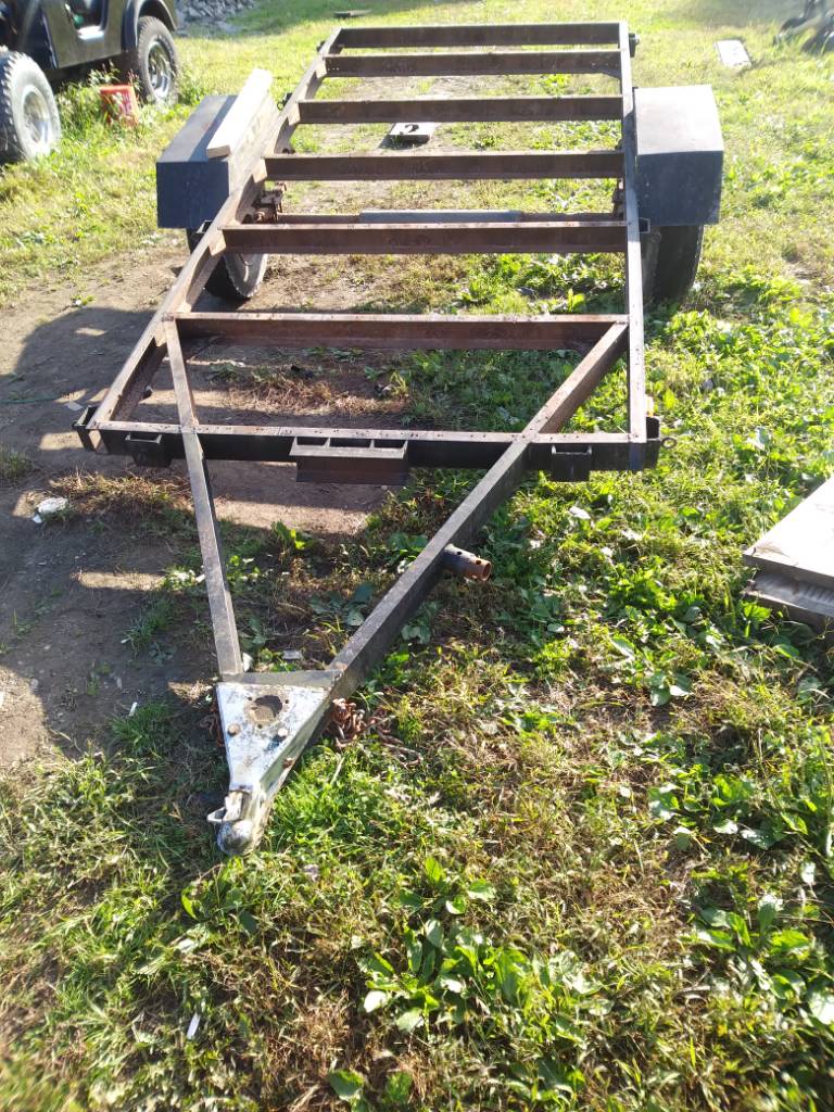

I was all set to build something on the order of a Muts or Versa trailer for the tractor/atv, had most of the materials priced out (over 1k) and I got a phone call from a bud asking me if I knew anyone interested in his old trailer to send them his way, well 100 bucks later I had me a 5x12 single axle project.

So what's the plan?

That's an awfully good start for 100 bucks !!

So what's the plan?
The plan,, well I had several but I chose the path of least resistance. I should end up with a 5x6 dump I instead of the 4x6 I originally wanted, I just can't see spending the labor cutting everything apart for 1 foot. If I had wooded paths yes but I am all open ground so I will forgo the extra effort. Progress so far.

Yes it was to good to pass up and although I had to change the end look and size of the trailer it is a better option. Actually my bud offered it to me for 50 bucks but I refused and we settled on 100.

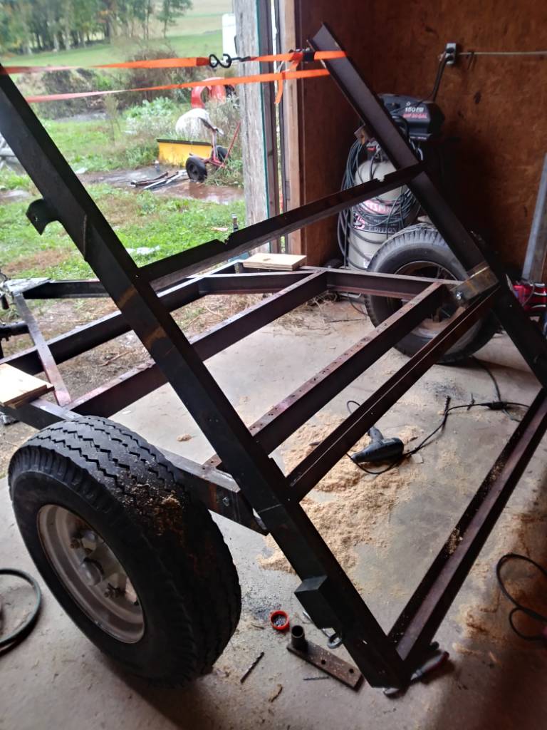

Well a bit of progress. So far additional coin spent,,, 23 bucks for 3 bolts and a spool of mig wire.View attachment 5746081013181028_HDR.jpeg

You could convert it to deck over and shorten the axel which would probably be less work than cutting a foot out of the trailer.

I think you would be correct, and I thought about doing just that but the bed and hitch height would increase a lot which I really don't want. In fact I removed the suspension and was able to lower the unit by 6". I haven't done the research yet but I wouldn't mind changing out the hubs and getting a set of shorter tires to lower it even further.
