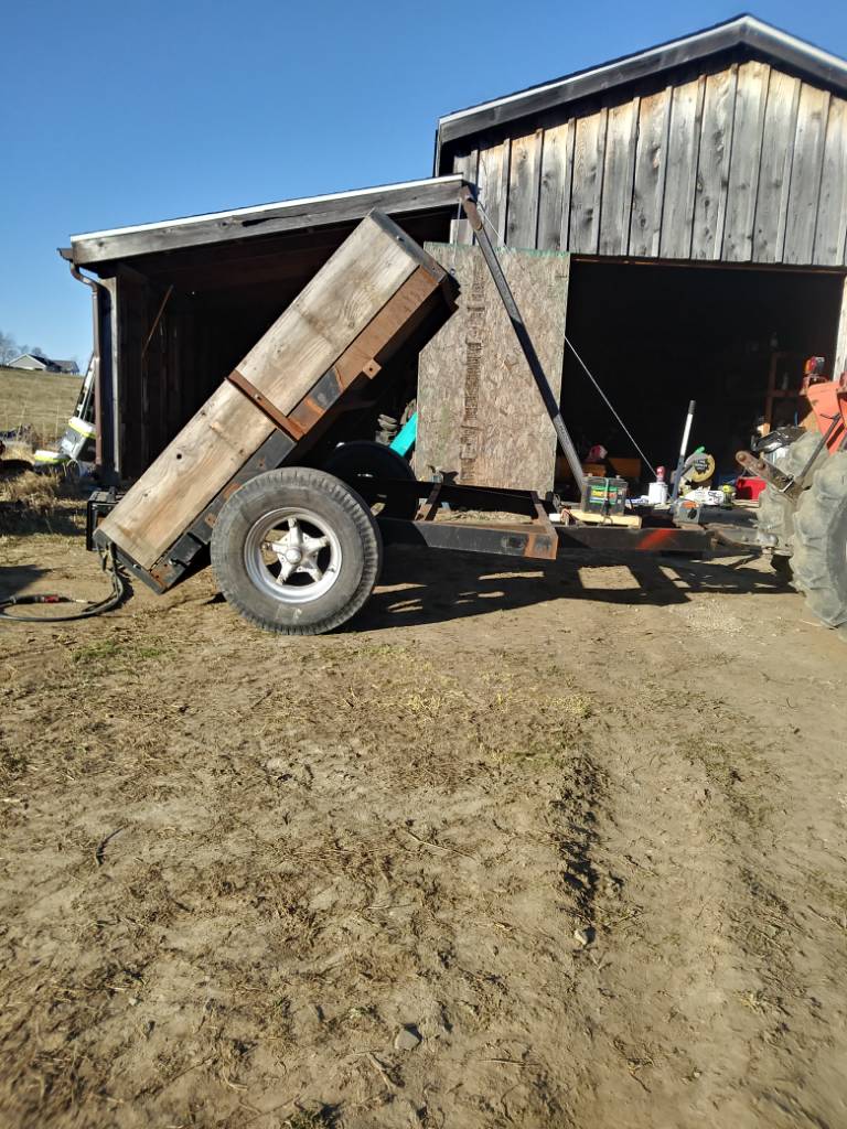

Pretty steep dump angle shouldn't have issues getting material to come out. 0403191749_HDR.jpeg
   / Tractor/Atv dump trailer #34
Pretty steep dump angle shouldn't have issues getting material to come out.View attachment 598708
Looks like it turned out pretty nice. I have considered overhang on the back side like you did, but I don't know if I should do that either. Thanks for posting pictures.

I used it yesterday to haul about a dozen loads of rock and found some issues which I hopefully remediated today. Most pressing issue was breaking the bottom bolt on the pole, I used a 7/16 bolt initially and have gone to 1/2 diameter. Anytime the bolt broke I found the winch cable between the upper roller and the side plate, put the roller in the lathe and cut a groove for the cable to ride in. Another thing I didn't like was the winch cable, unspoiled it and cut half of it off. Other than that it worked as planned.
