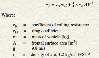

There is simple physics behind the mileage. To double the speed you have to increase power 8 times. Rolling resistance increases linearly while aerodynamic drag increases with square of speed. Multiplying those together results in cubic relationship.
Your initial statement here is correct, but ... nope.
Rolling resistance is linear with velocity, and air resistance goes by the square, but you don't multiply them together but add them:
