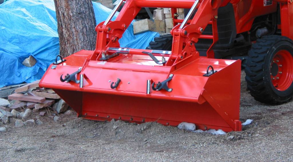

Looks very nice! Good choice on the tires...I see on Kubota's "build your own tractor" site that there is a choice of 4 different loader buckets. Which one did you go with?
For some reason, no FEL bucket comes with chain hooks - but whichever bucket you choose, it will need some chain/rope hooks welded or bolted to the top - unless you plan to do that later. Rather than look at ugly welds on my bucket, I elected to use bolted-on hooks. That also gave me a chance to include a backing plate to spread the stress out on the center hook.
luck,
rscotty
