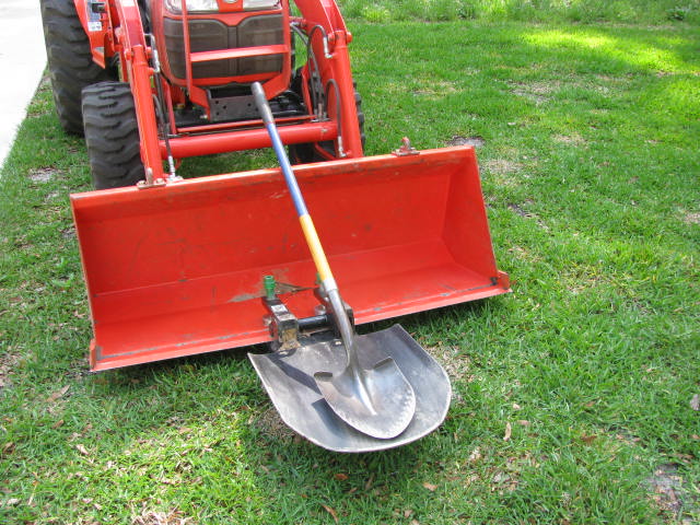

Stump removal is the only task you have listed for a Backhoe, so far. As you know, tractors are inherently unstable because of large rear wheels and small front wheels. Equipment on tracks is much more stable. Plus~~~~~ you have sloped ground.
A Bucket Spade is useful for excavating holes to 48" deep in moist/reasonably soft soil. Bucket Spade is NOT for stump removal.
Bucket Spade is a particularly rigid mount on Kubota's optional Heavy-Duty, Round Back Bucket, which would be a good option in your rocky conditions.
http://www.tractorbynet.com/forums/attachments/328798-bucket-spade-today-fel-bucket.html?highlight=
