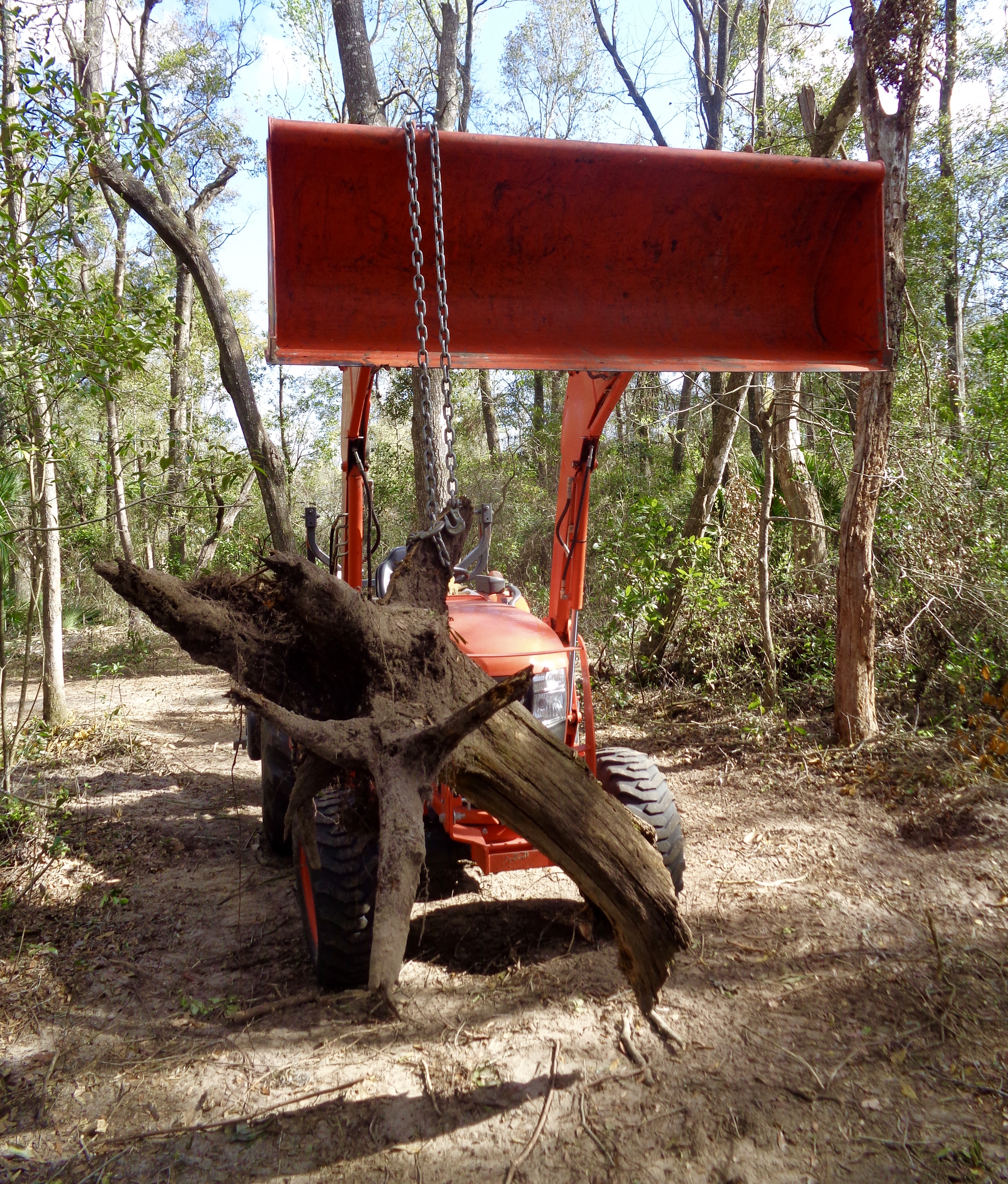

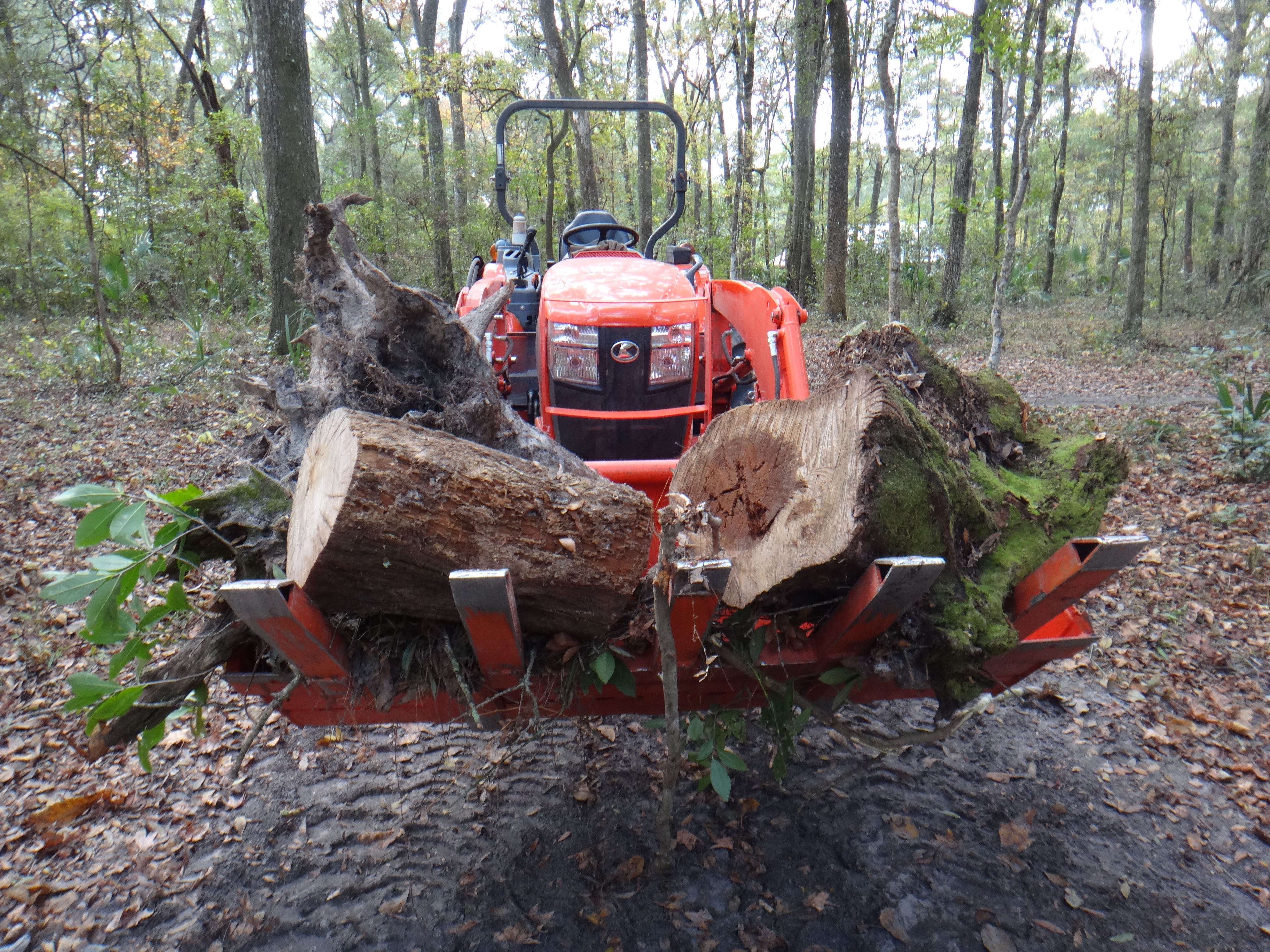

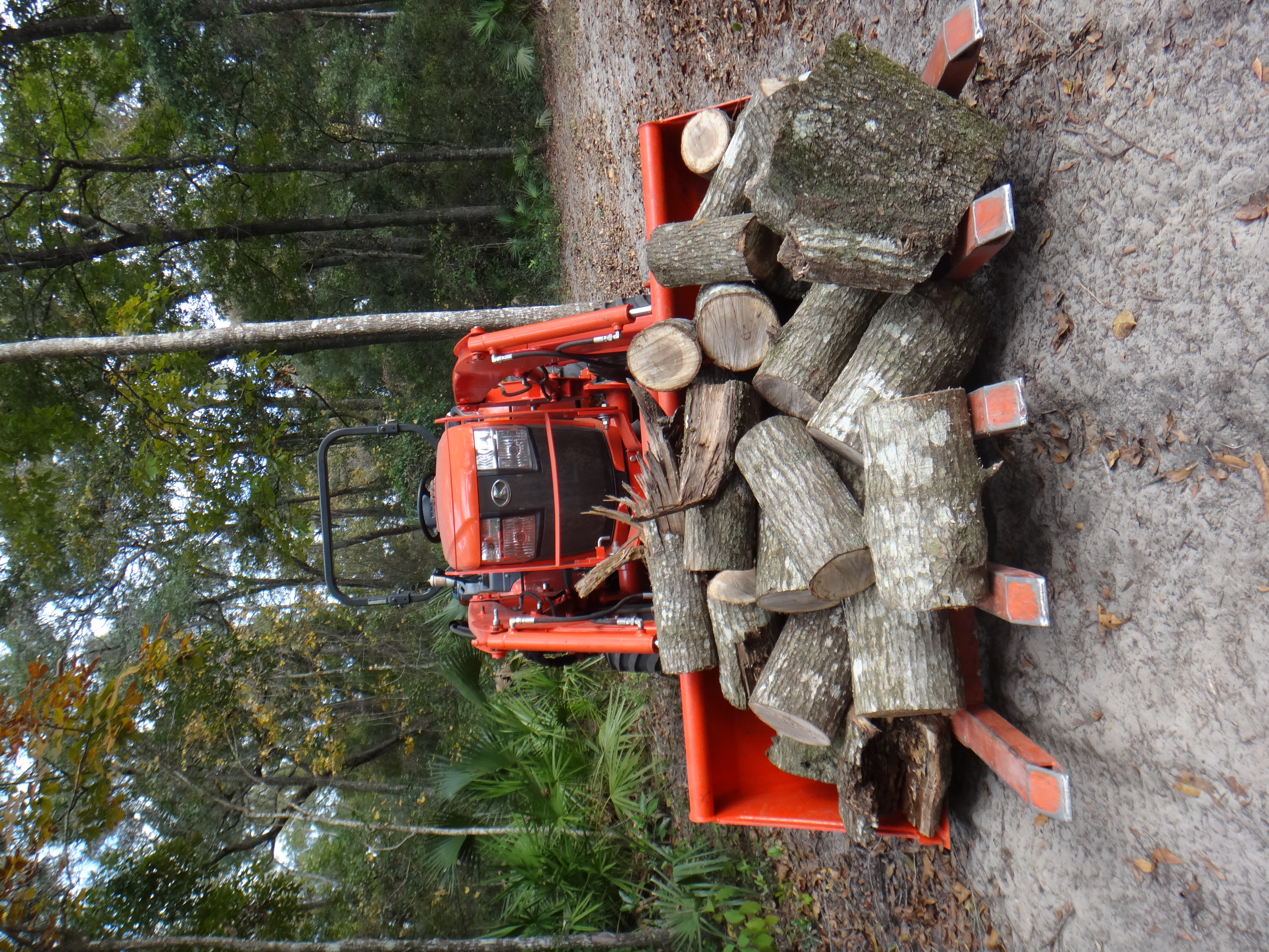

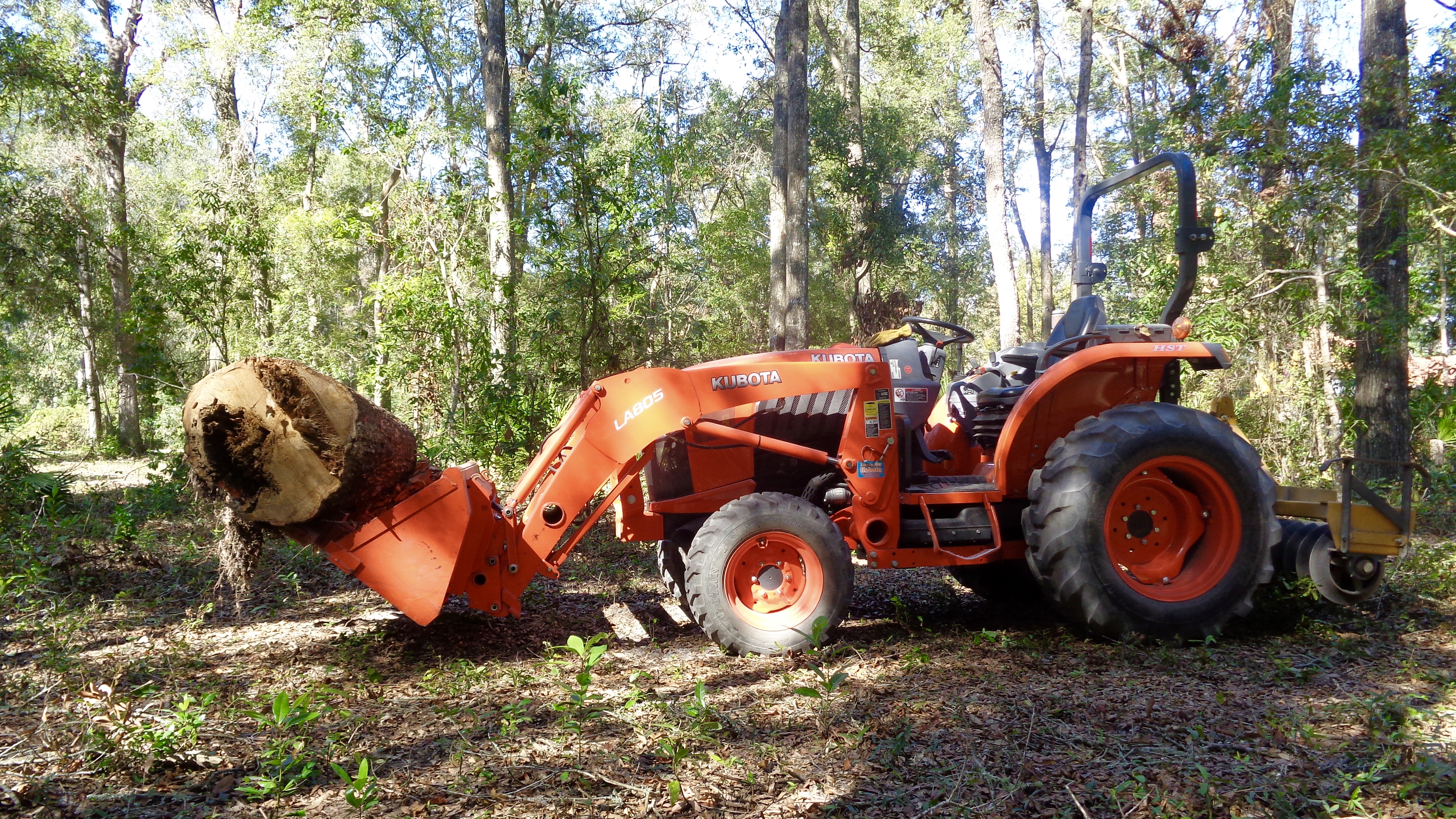

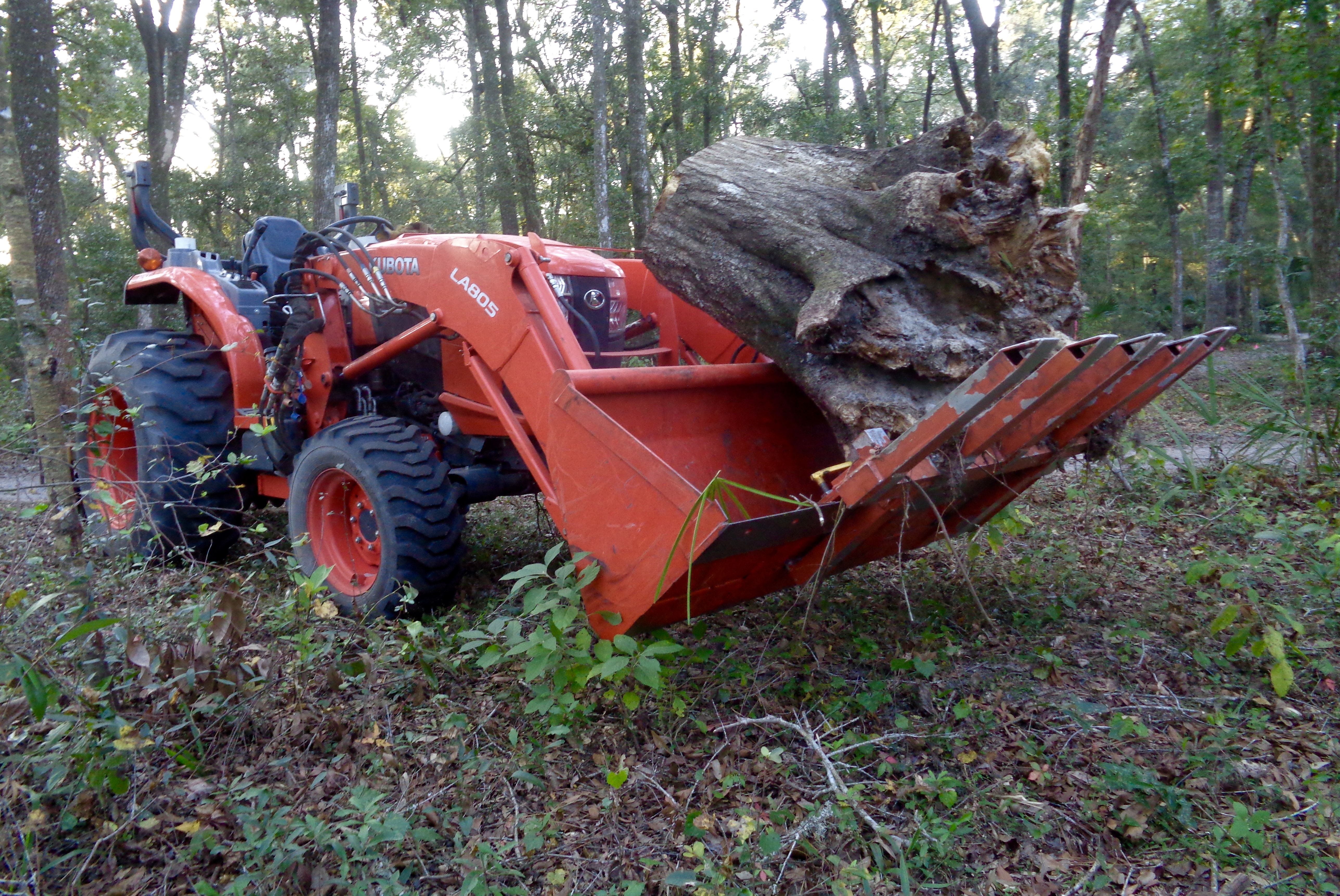

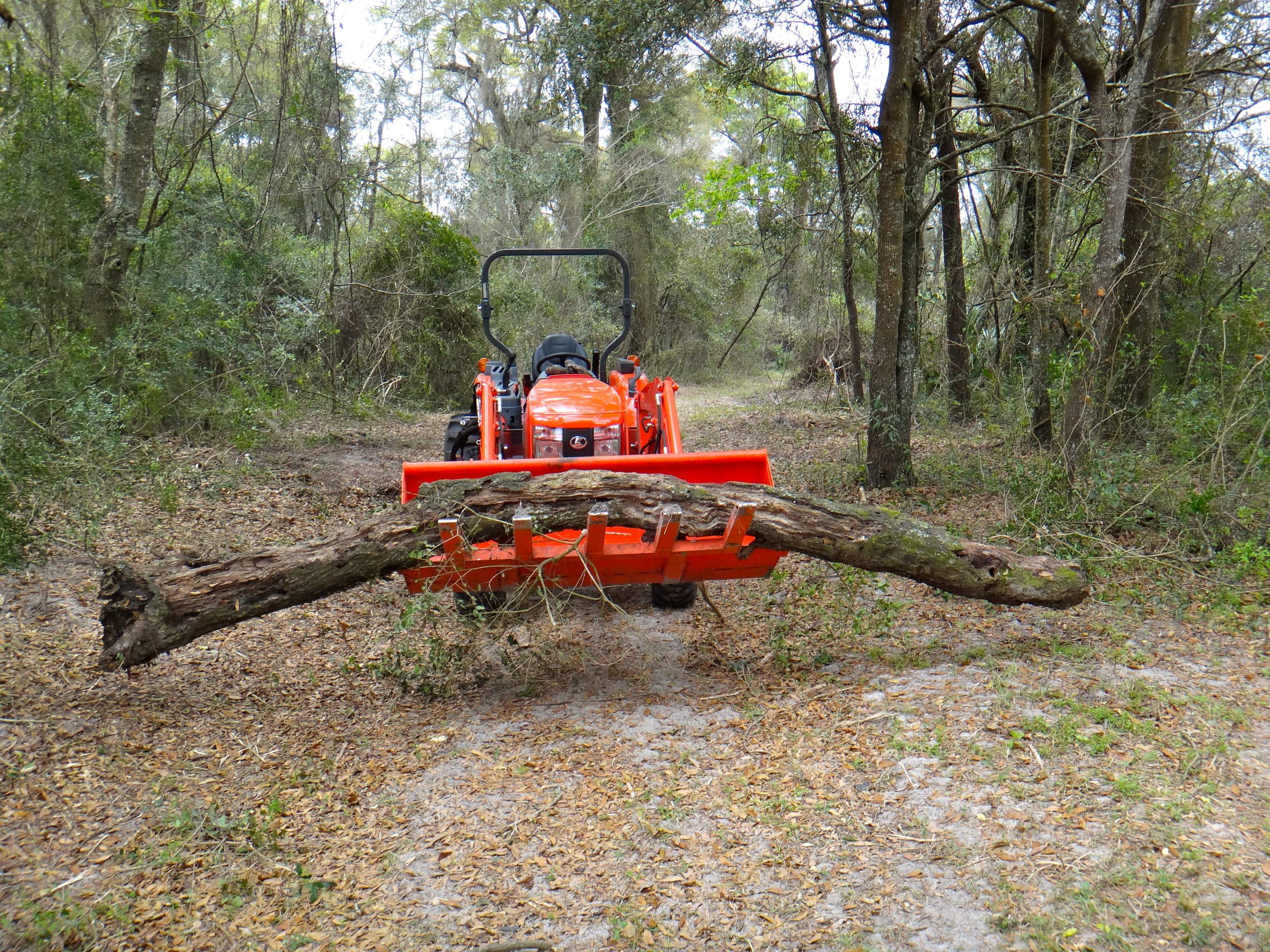

How about stability on hilly terrain, lifting larger logs? The log grappler will probably be the most stress I put on the front end of the machine.
With regards to cost, I didnt see much difference between an L6060 and M7060. Am I missing something?
I expect Shuttle Shift costs Kubota substantially less than HST/PLUS. I not an expert on how M7060s are kitted but I can confirm Grand Ls are loaded. There may or may not be same/less deLuxe kit on an M7060.
Both models are heavy-chassis tractors with commensurately strong front axles. You will certainly want liquid filled rear tires, wheels spread wider than normal, but not so wide it restricts movement between trees in your woodland and Three Point Hitch counterbalance is still essential, but with those caveats you need not fear front axle damage and stability will be good.

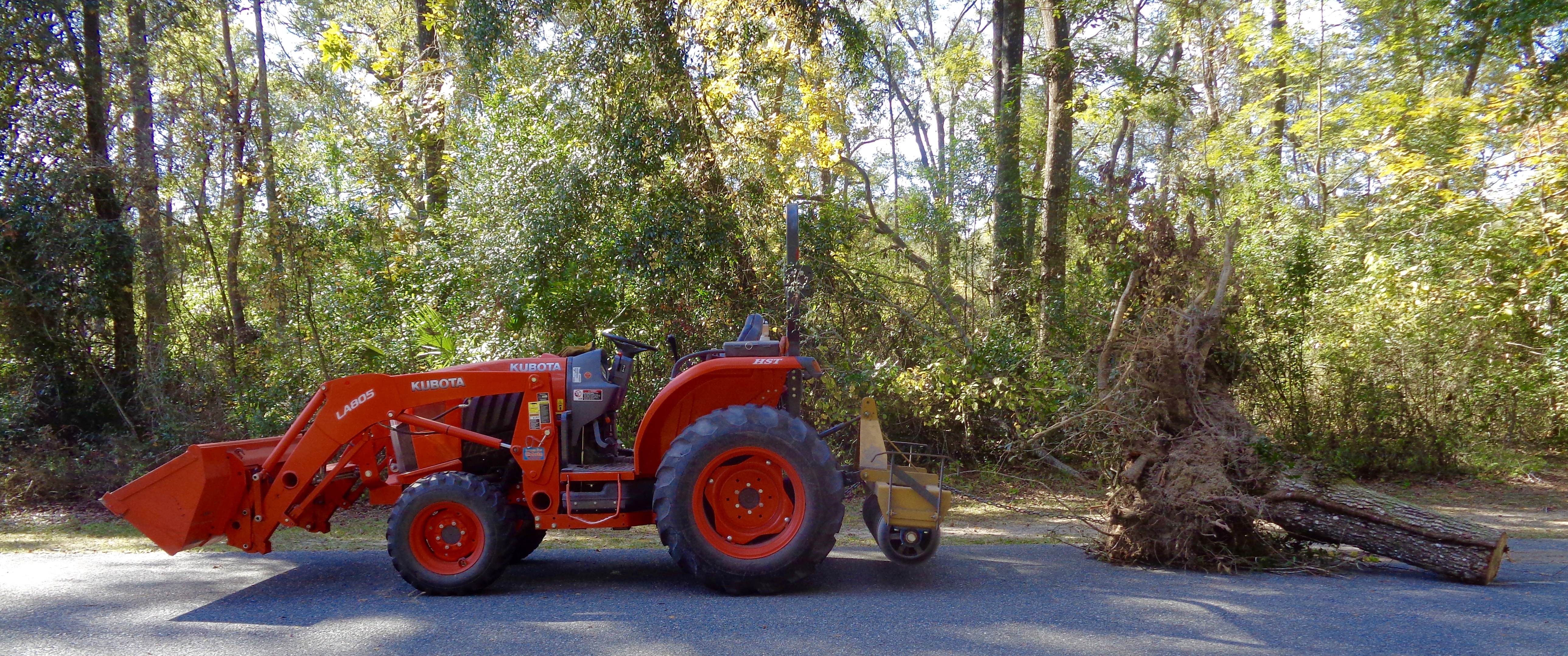

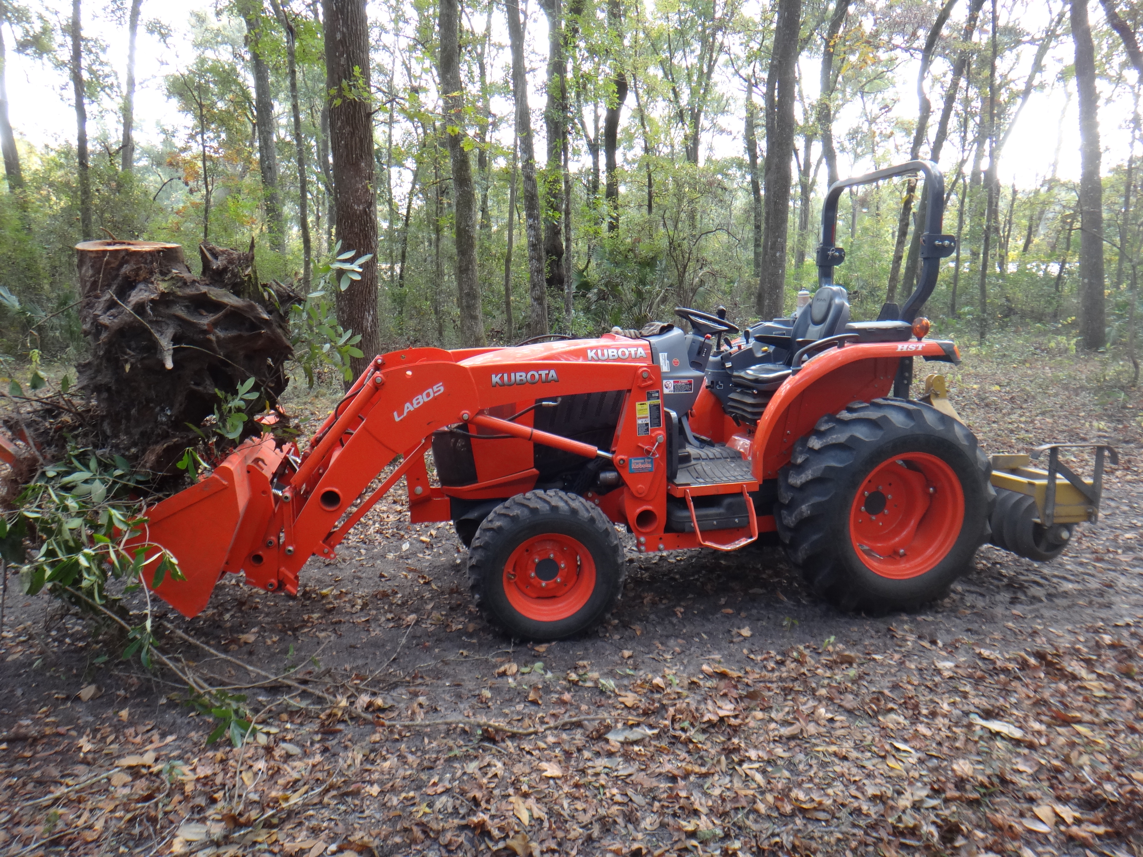

My last Kubota was a B3300SU, one of the predecessor models to the L2501. With its light weight and powerful Loader I picked up the rear wheels often, even with counterbalance. Decided to buy heavier BEFORE rolling it. Since delivery in January 2013 I have never had the air filled rear R4 tires of L3560 off the ground. My land in Florida is FLAT.

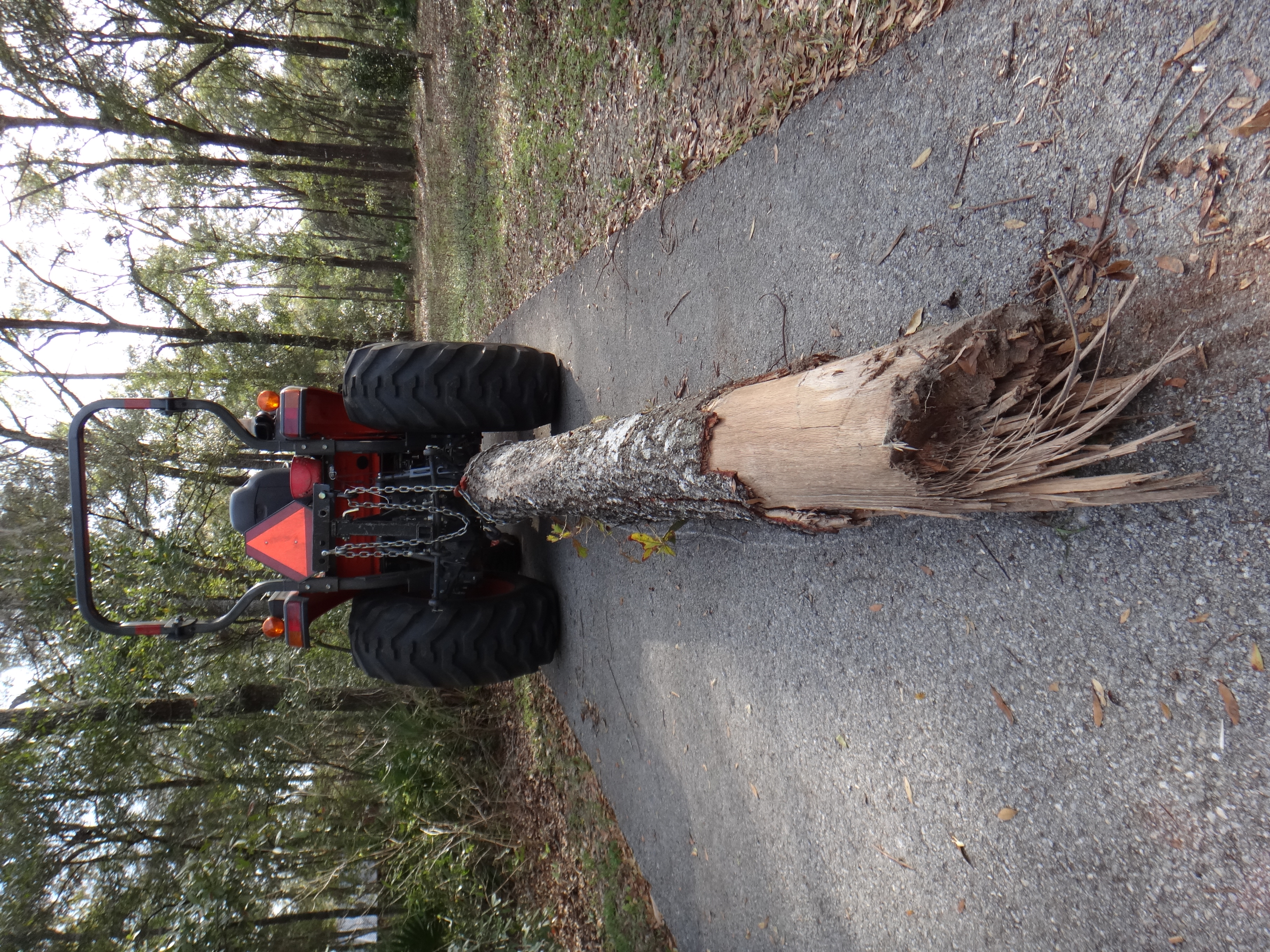

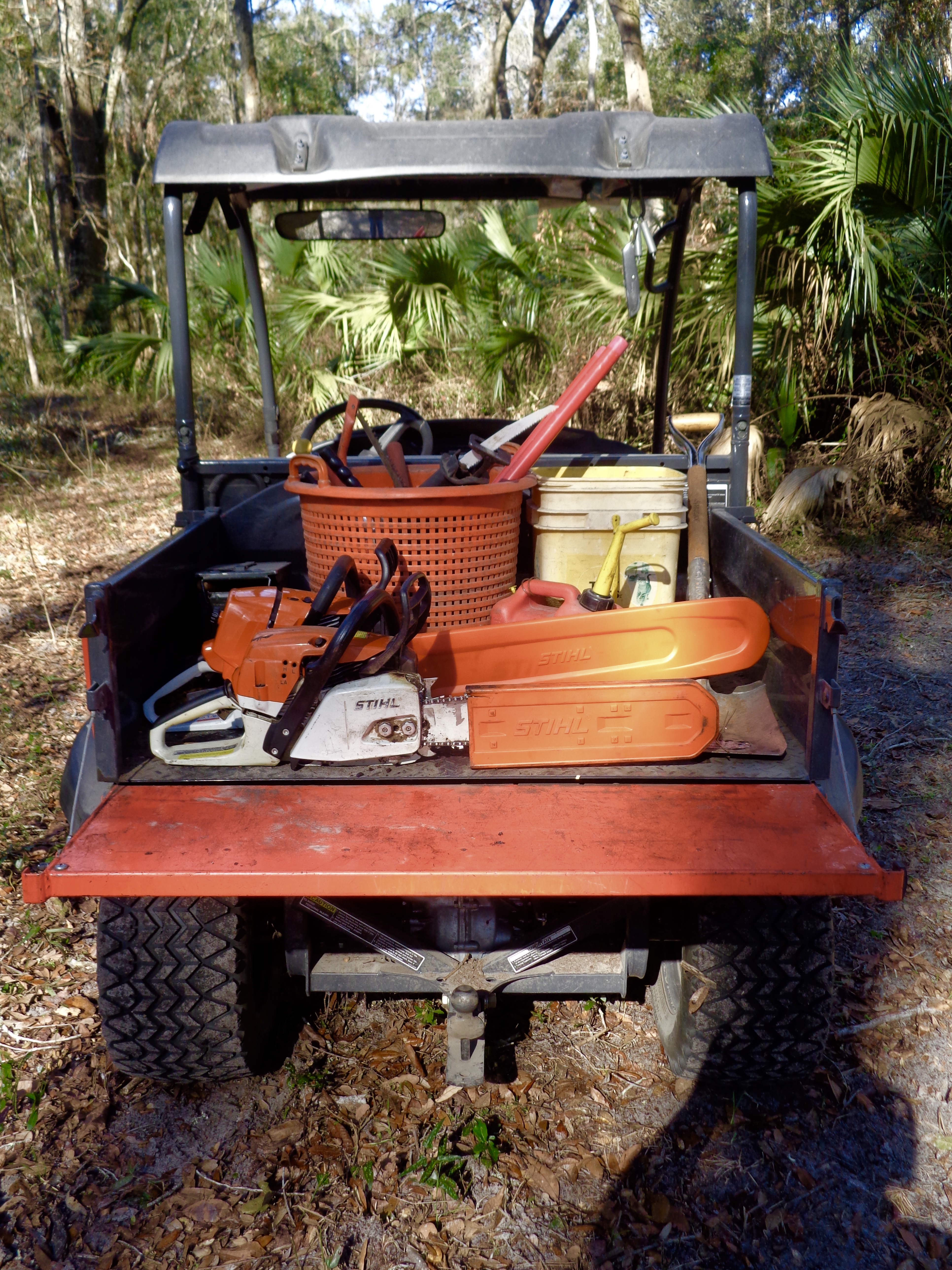

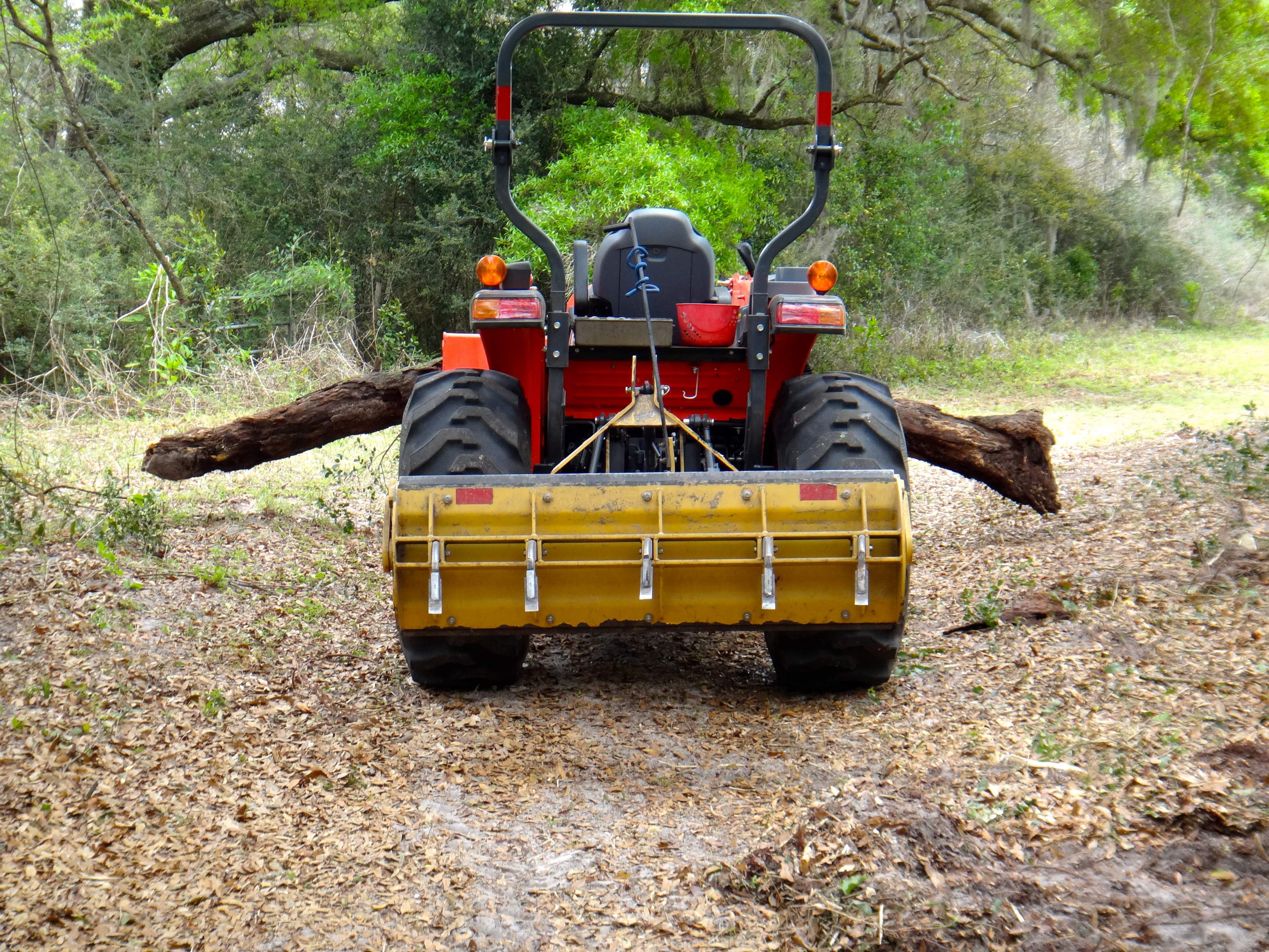

You will still need a chainsaw(s), plenty. While you can pick up felled long trees with a grapple, you cannot maneuver them between growing trees. You can tow large trees and bundles of smaller trees from the rear/center drawbar or an A-frame cross drawbar on the Three Point Hitch. But once towed trees pick up dirt saw chains dull in seconds. When I tow trees destination is the burn pit. I tow long to avoid several chainsaw cuts, every cut a potential hazard.
More tractor weight does not hurt if the budget permits.

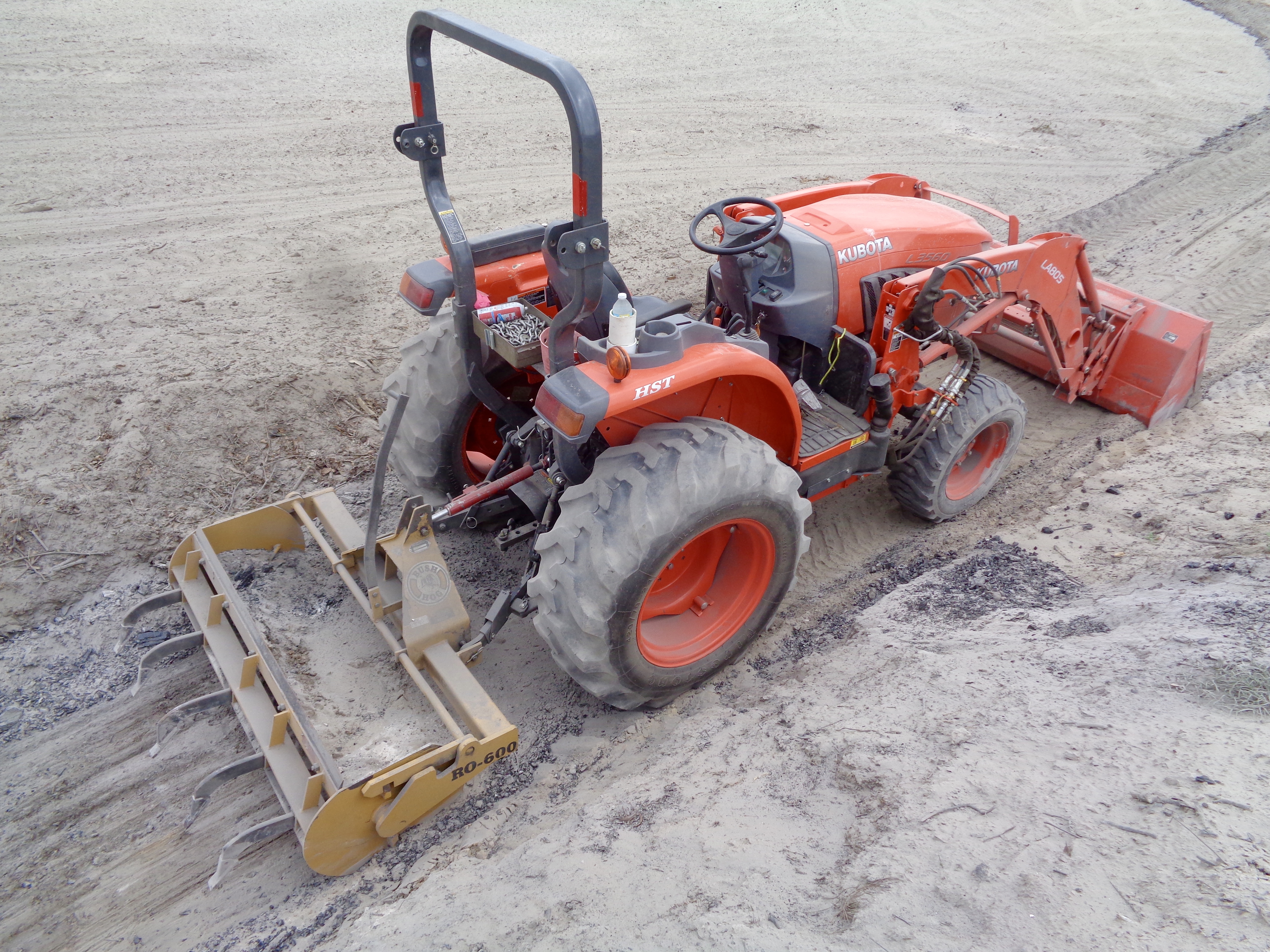

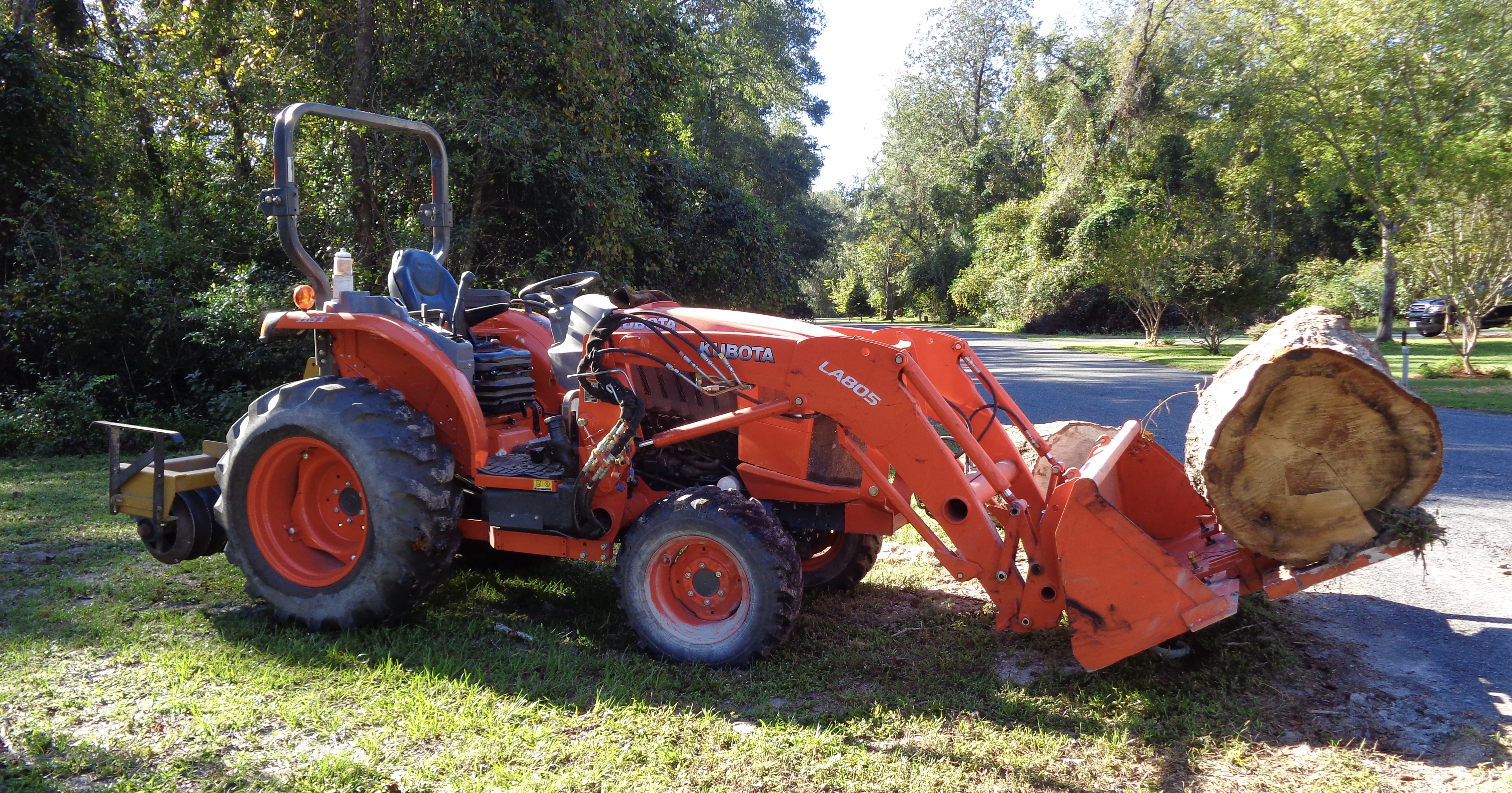

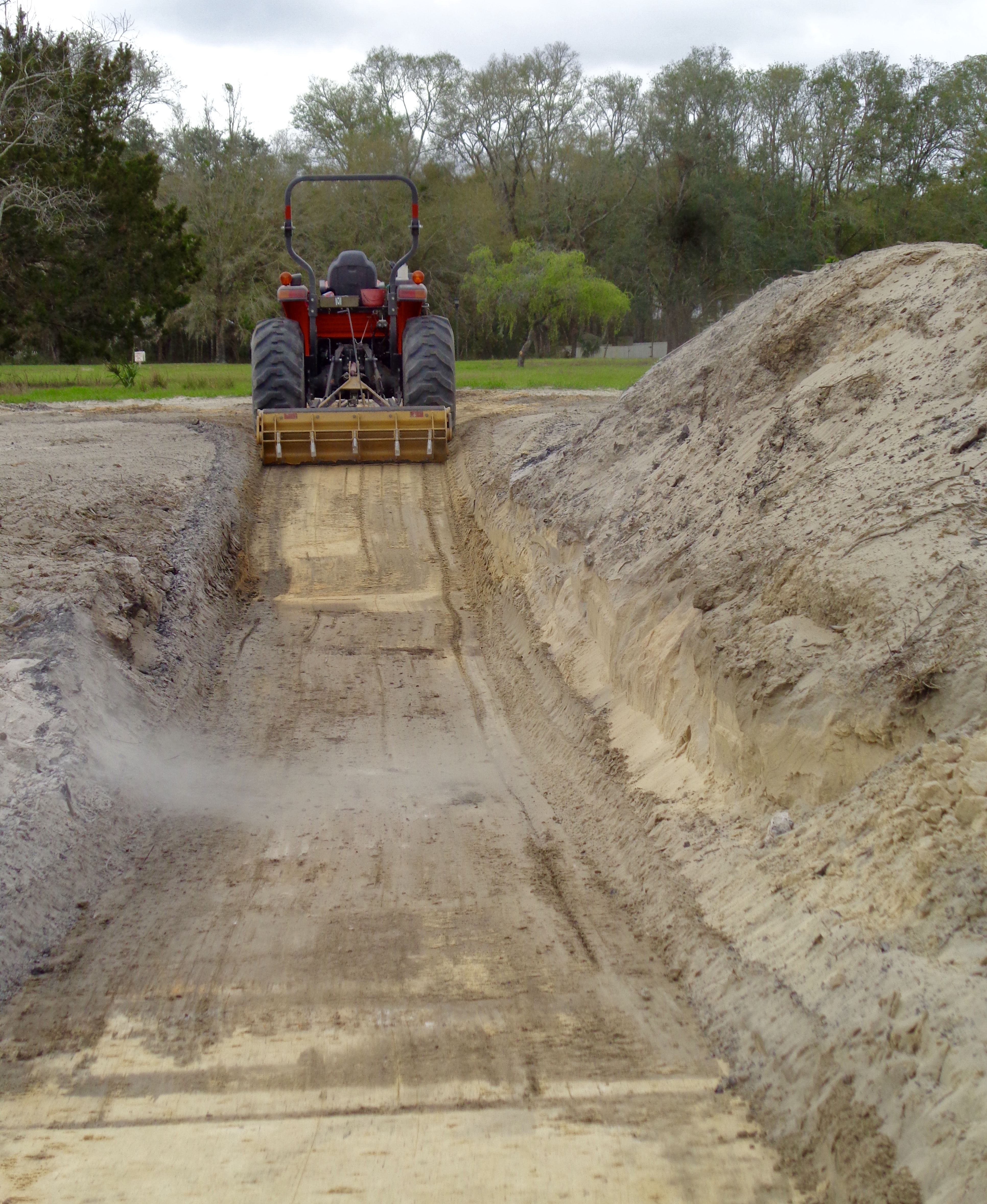

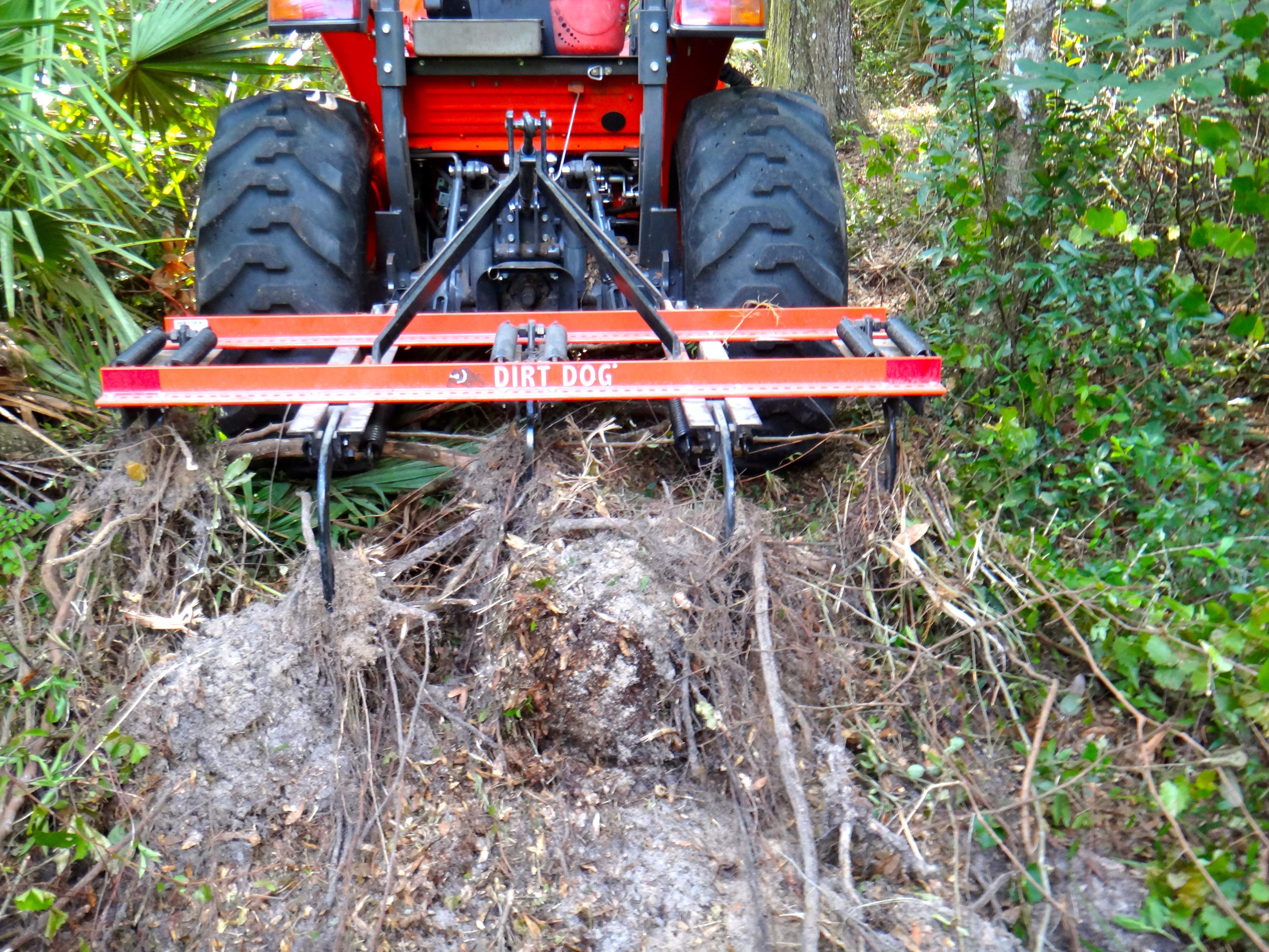

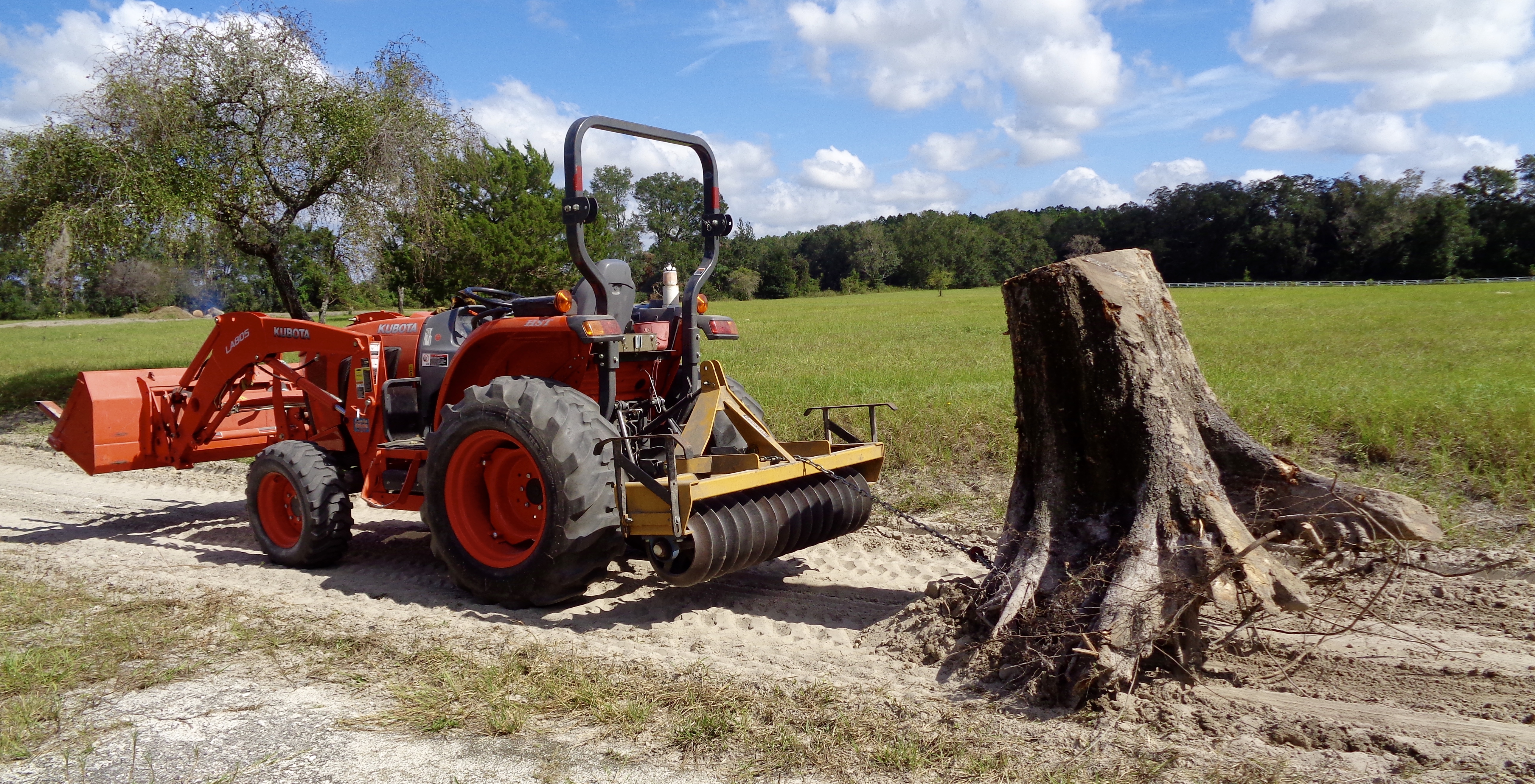

Here are a few pictures of my 3,600 pound, bare weight, L3560 Grand L.

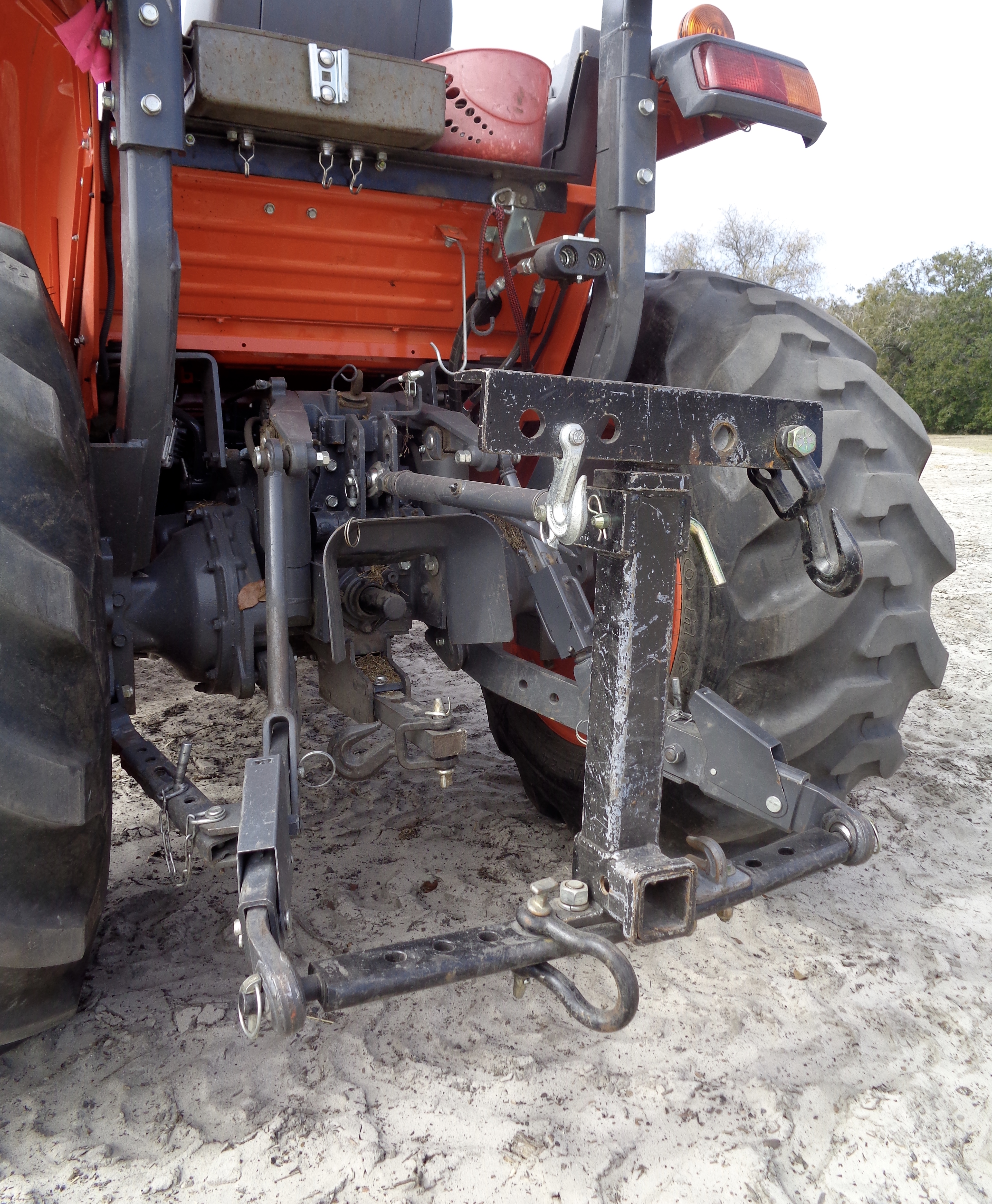

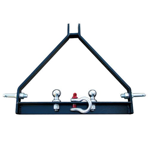

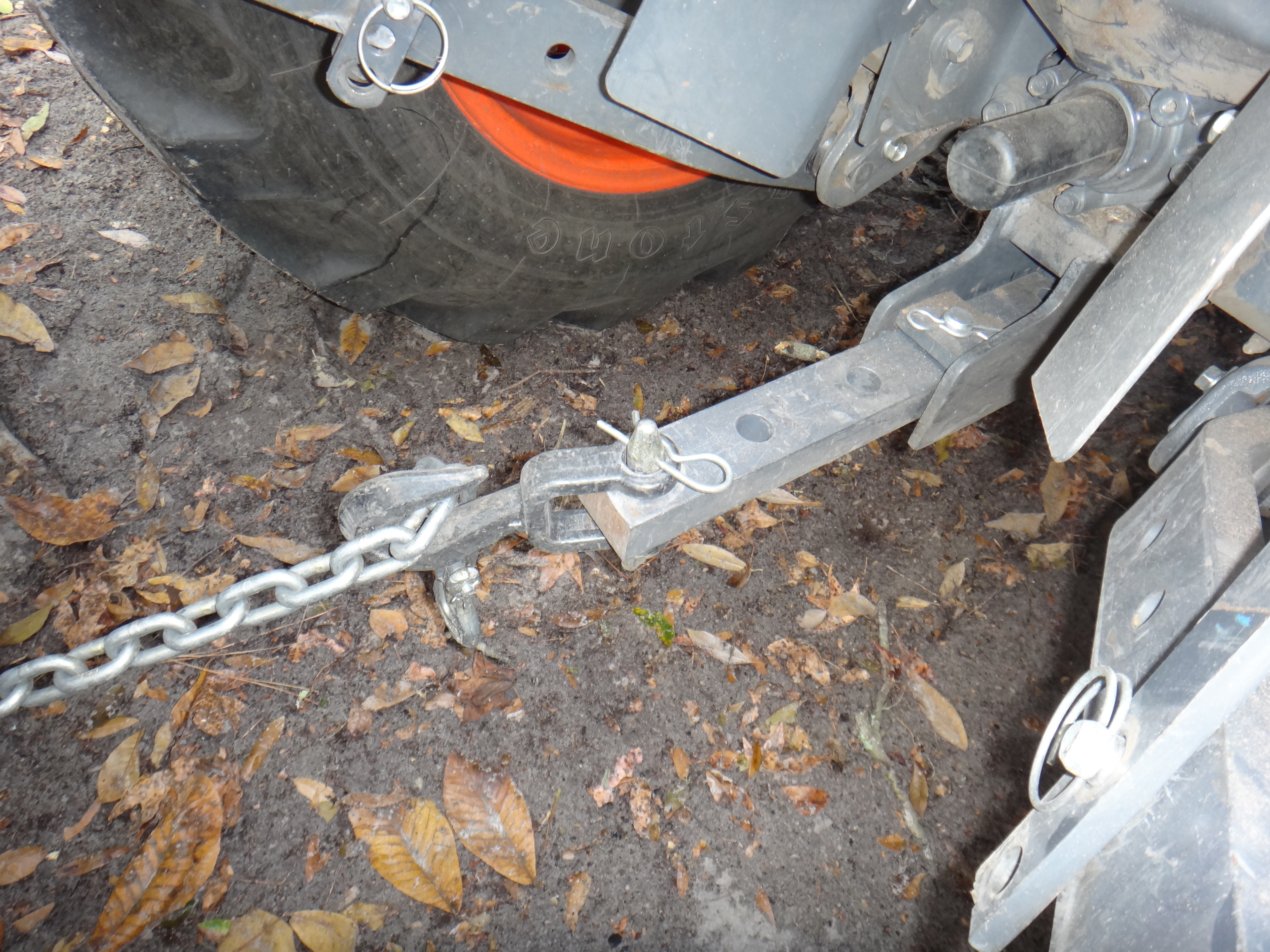

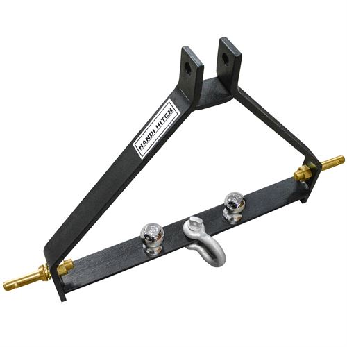

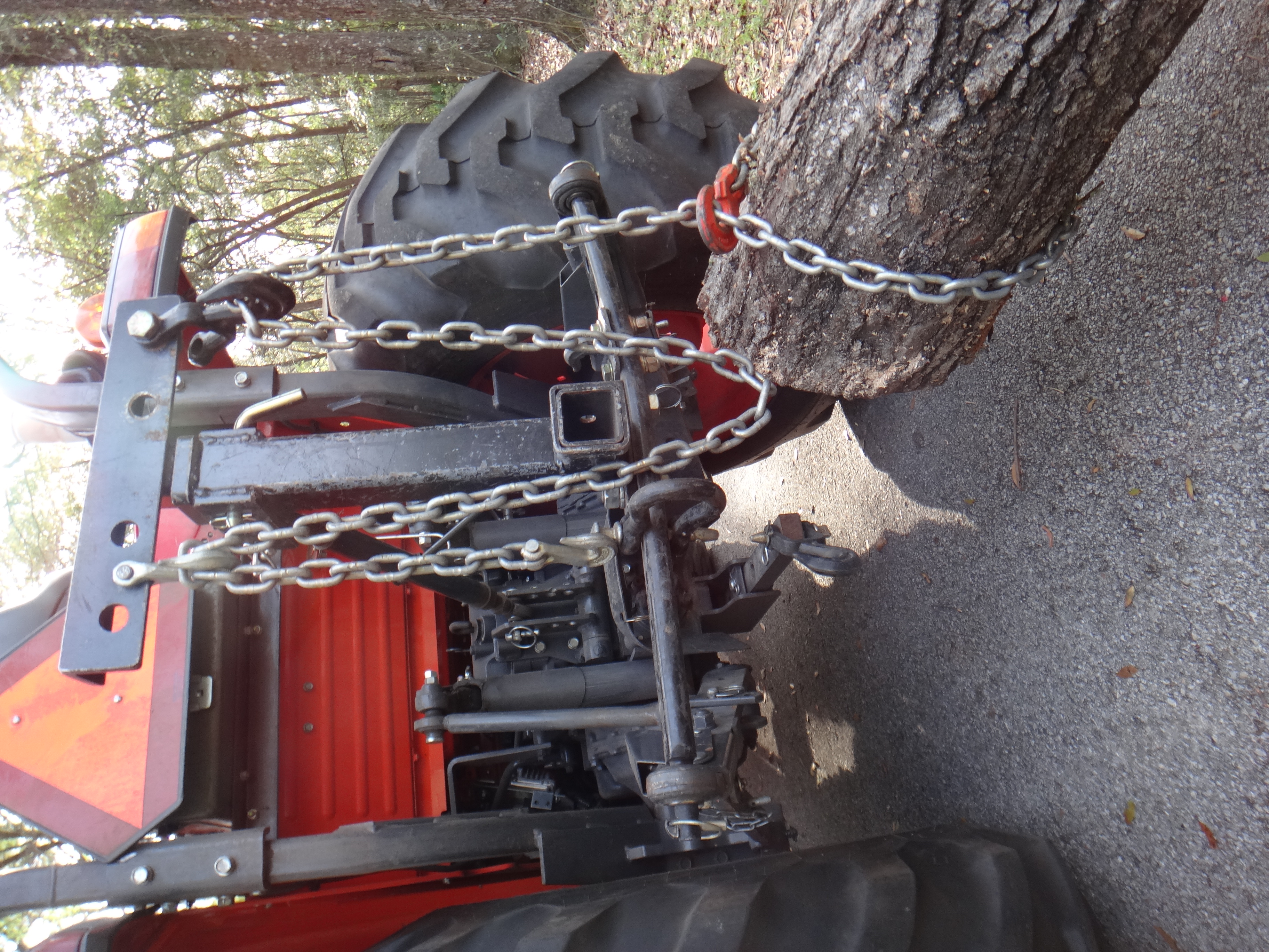

You can tow large trees and bundles of smaller trees from the rear/center drawbar or an A-frame cross drawbar on the Three Point Hitch. But once towed trees pick up dirt they dull saw chains in seconds. When I tow trees destination is the burn pit.
Three Point Hitch Cross-drawbar photos. Rear/center drawbar with clevis chain grab hook also visible.
Large rear wheels configure tractors for pulling/towing.

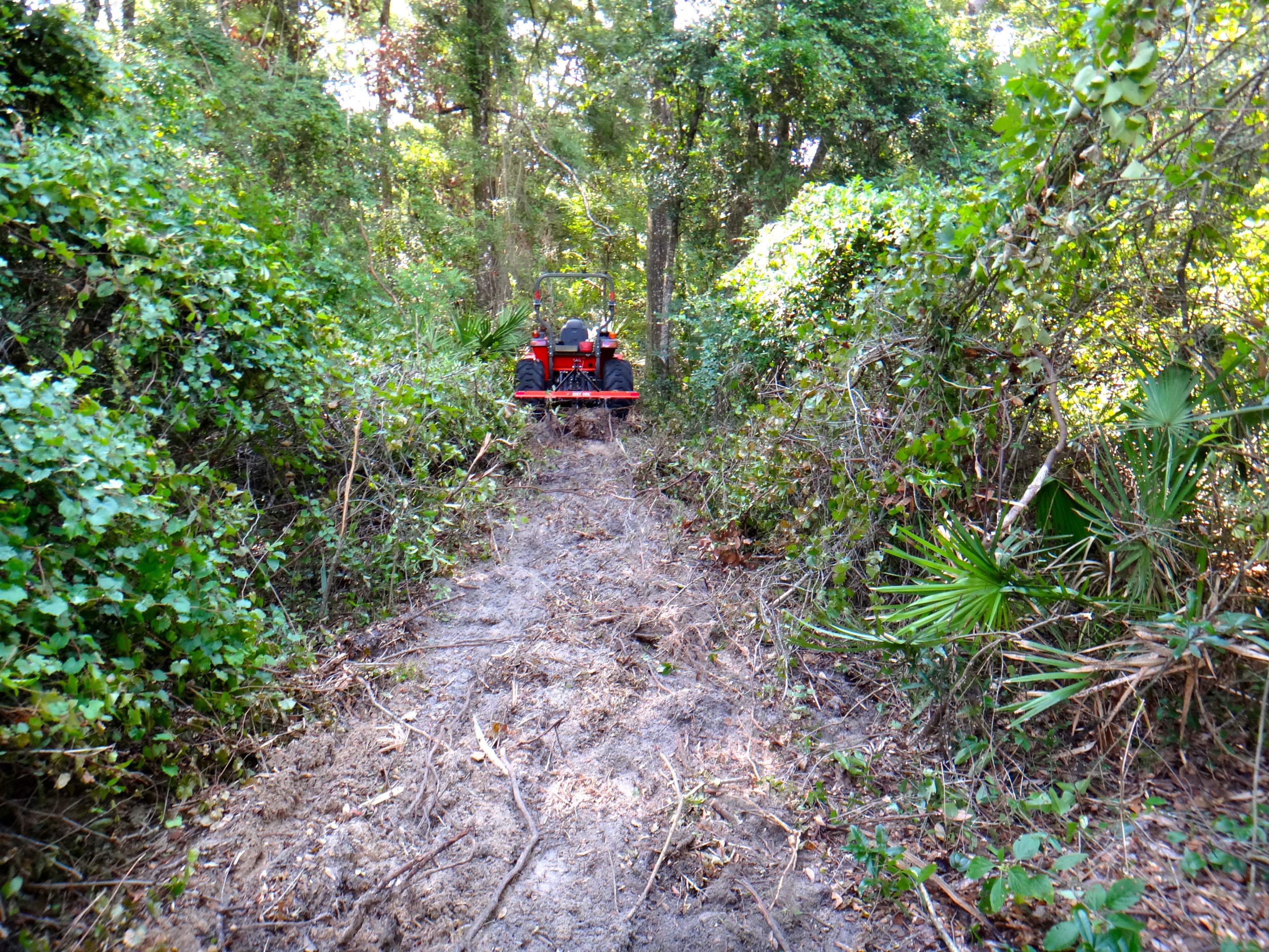

Browsing Kubota's web pages for the M7060 this evening, I noticed bulbous tractor radial tires and rear wheel spacers are M7060 factory options. These additional stability options are not necessary except on fairly steep hillsides. However, for someone new to tractor operation these options would make you more secure on hillsides.
The outside-to-outside wheel/tire width is dependent on max standard wheel width available, tire selection and potential spacer inclusion. With your dealer, consider how wide these options make your tractor relative to space between your trees and rock formations.
My L3560 is 60" wide. I considered the heavier, normally aspirated L4060 and L4760, which are nominally 66" wide, but decided the extra 6" width was too wide relative to my work, which is sometimes opening Florida jungle.
My altitude is 52'.

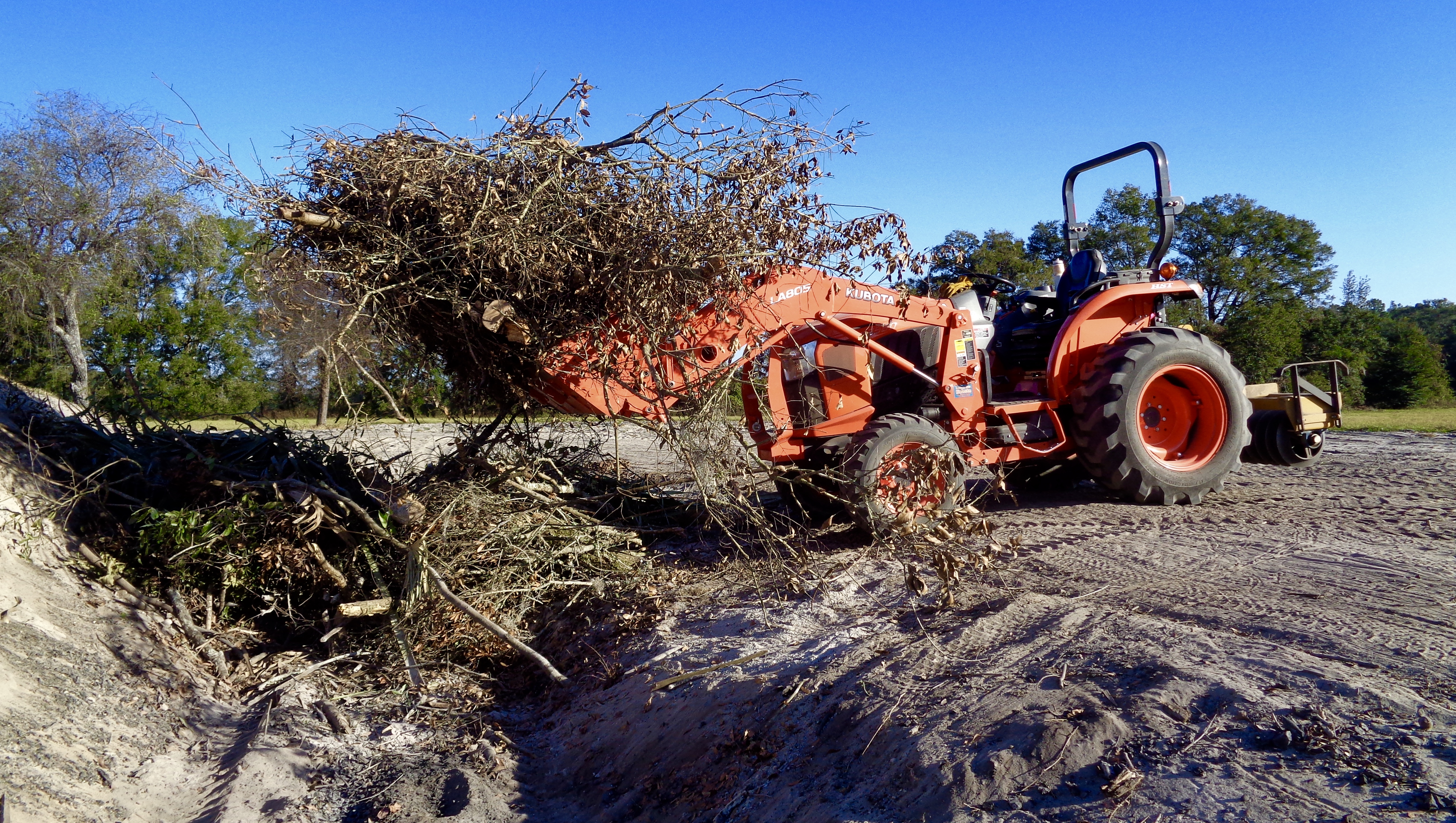

Three photos from today. Removing dirt and ashes from our community yard debris burn pit.
HST/PLUS, MED//LOW, 2/3 throttle, 4-WD engaged. Easy-peasy
