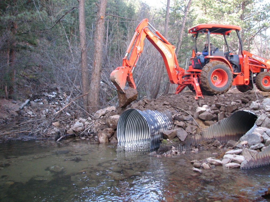

Sure is different from our Rocky Mountain "soil". We'd sure trade some rocks for that nice sand, dirt, and yes....we'll take the ashes too.
Here is some typical high country tractor work. This is a flat area, but it still has a few rocks.
rScotty
Looks very familiar!
