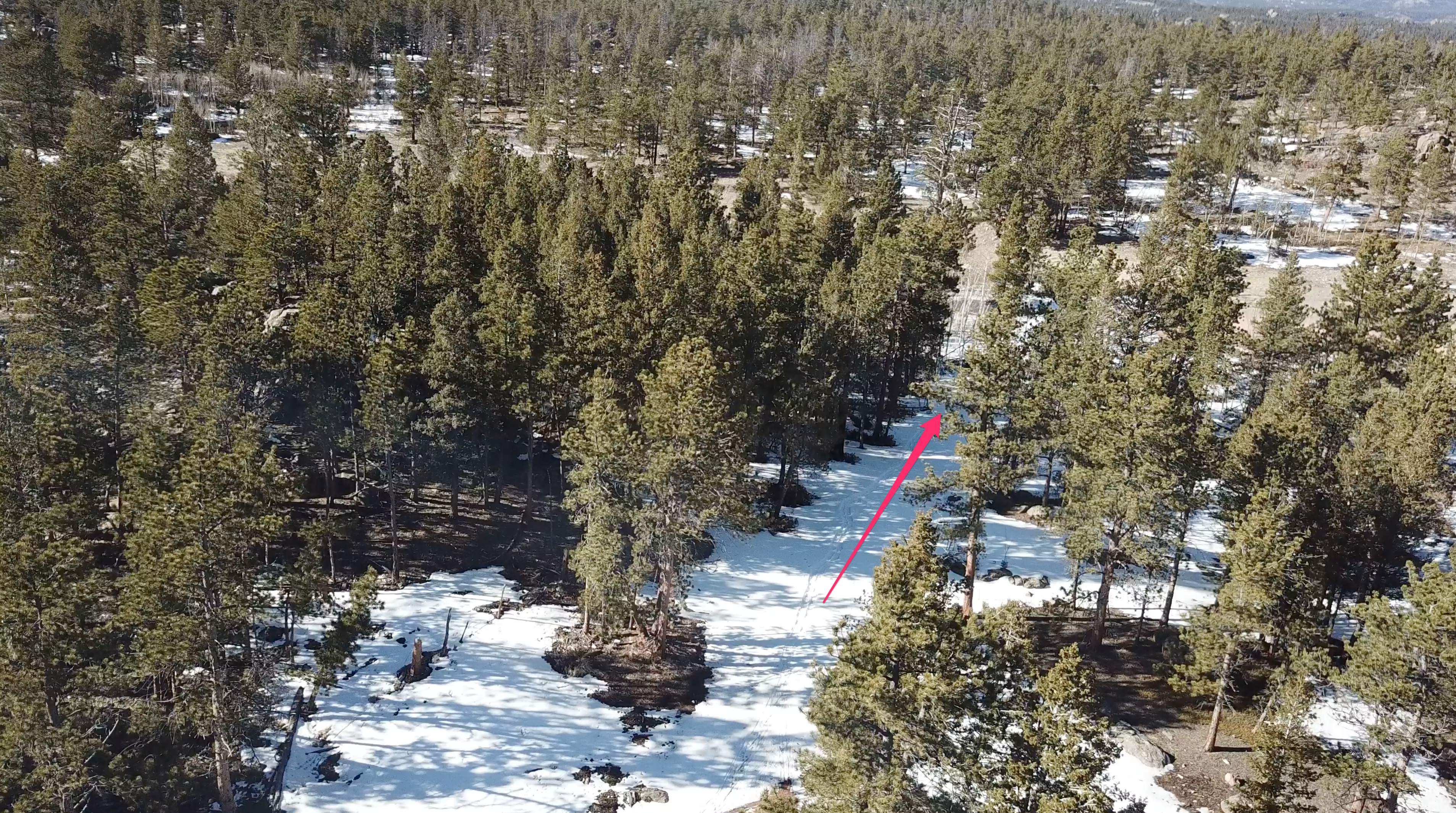

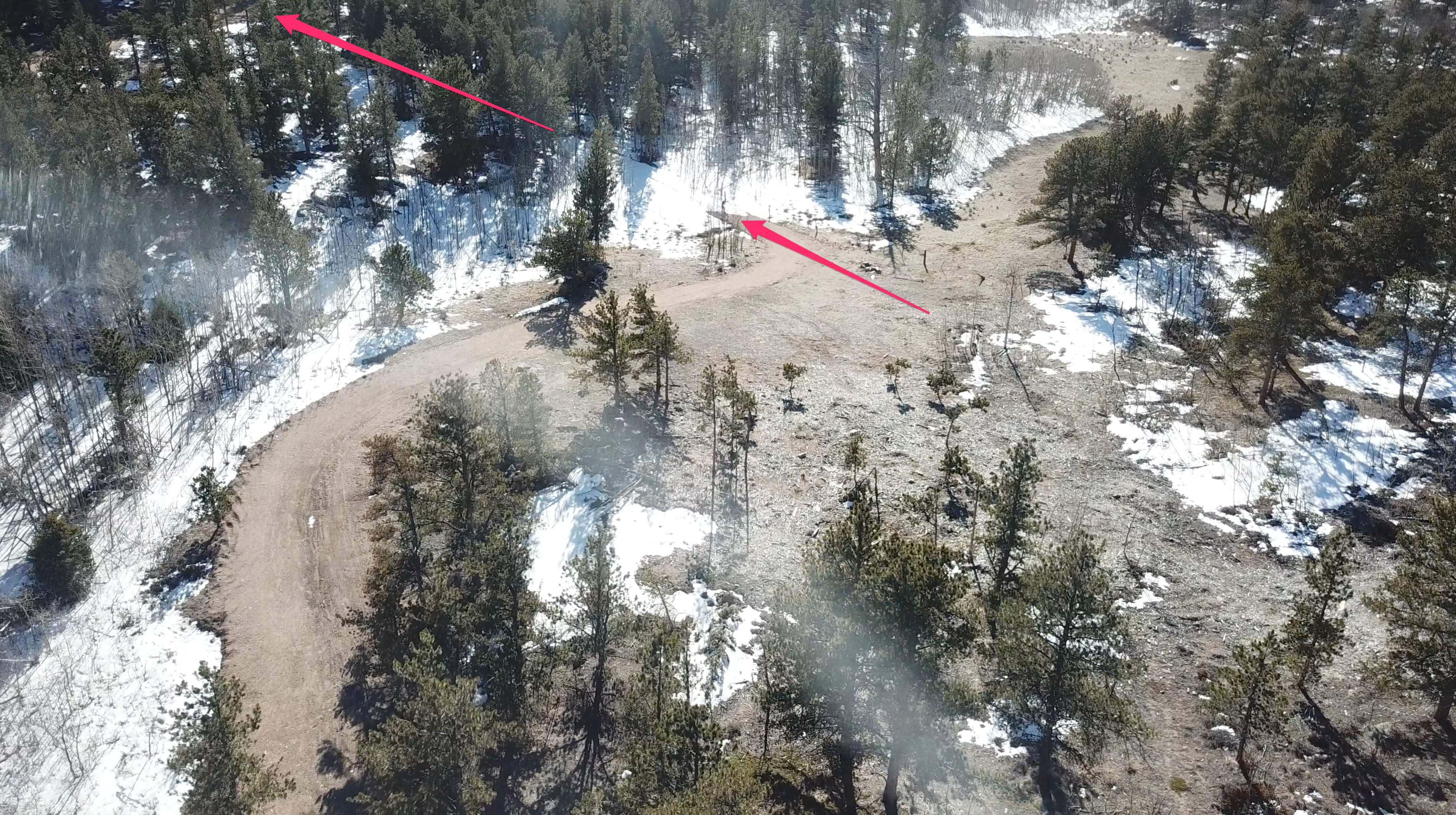

Thought I might add a few aerials I took today at the property. These are of our access road, and as you can see it is under about 2 ft of snow, even though much around it has already melted. So not only do we have snow, but we have a North facing drift spot to dig out with each storm. The pictures are from either side of the road/drift. The latter shot is an uphill grade, about 4-6%.
