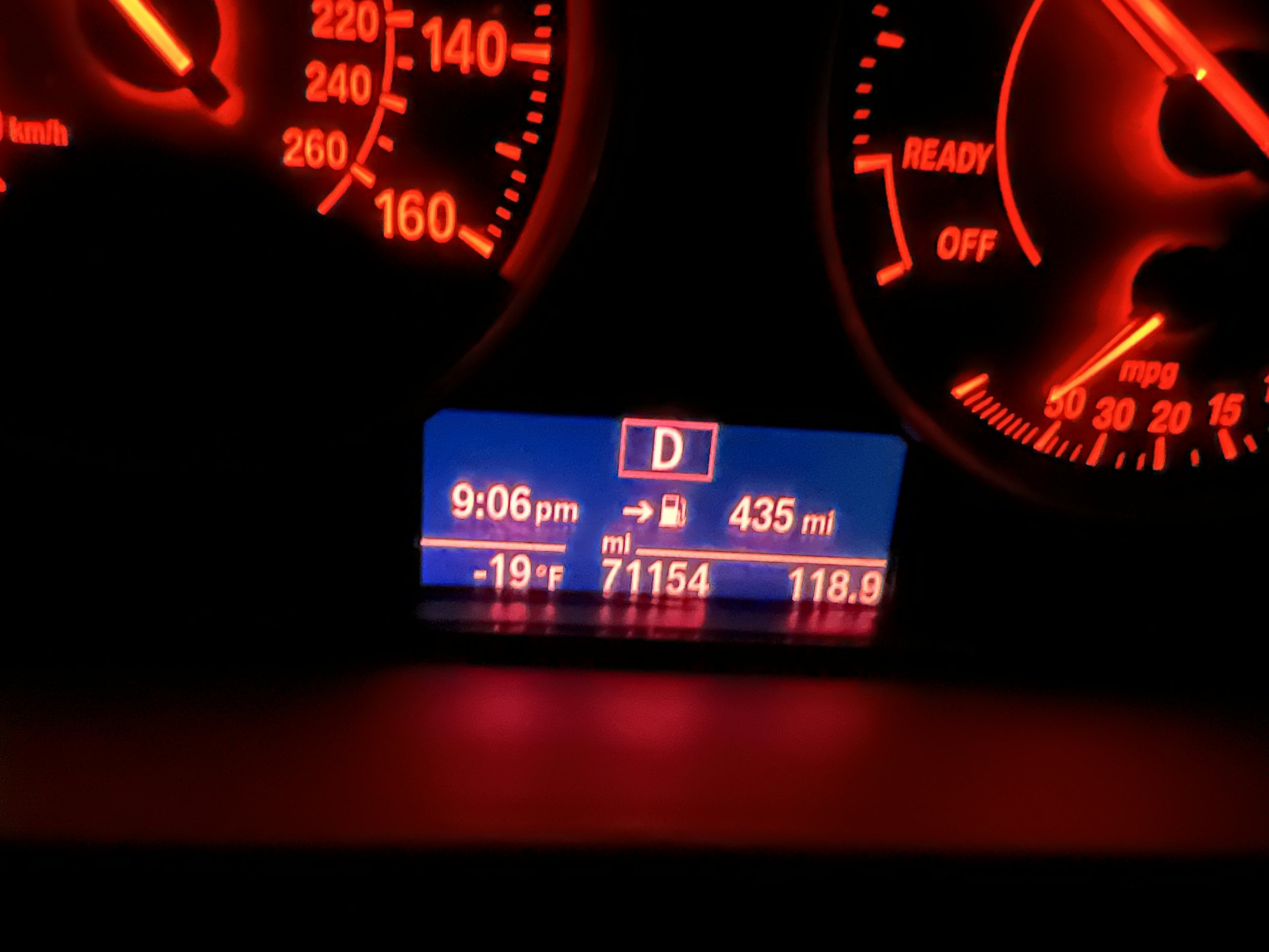

During the worst day+night of the -20 recent snap, I ran my BMW wagon on pump diesel with RedLine lubricity additive. Unfortunately, only had the case of summer additive on hand, with no anti-gel.
Wondered if it'll start, but it sure did and ran well after an hour's warmup as we got ready. Three hours into the trip though, while the car was parked and idling, the windshield spontaneously cracked all the way across due to thermal stress.
The diesel tank at the mini-farm is winter blend plus anti-gel, but there was no immediate need to run the tractor (unheated storage) so that bullet was dodged.
