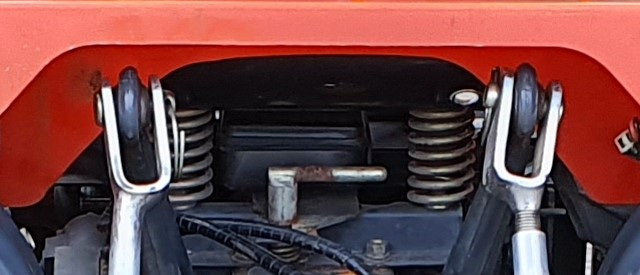

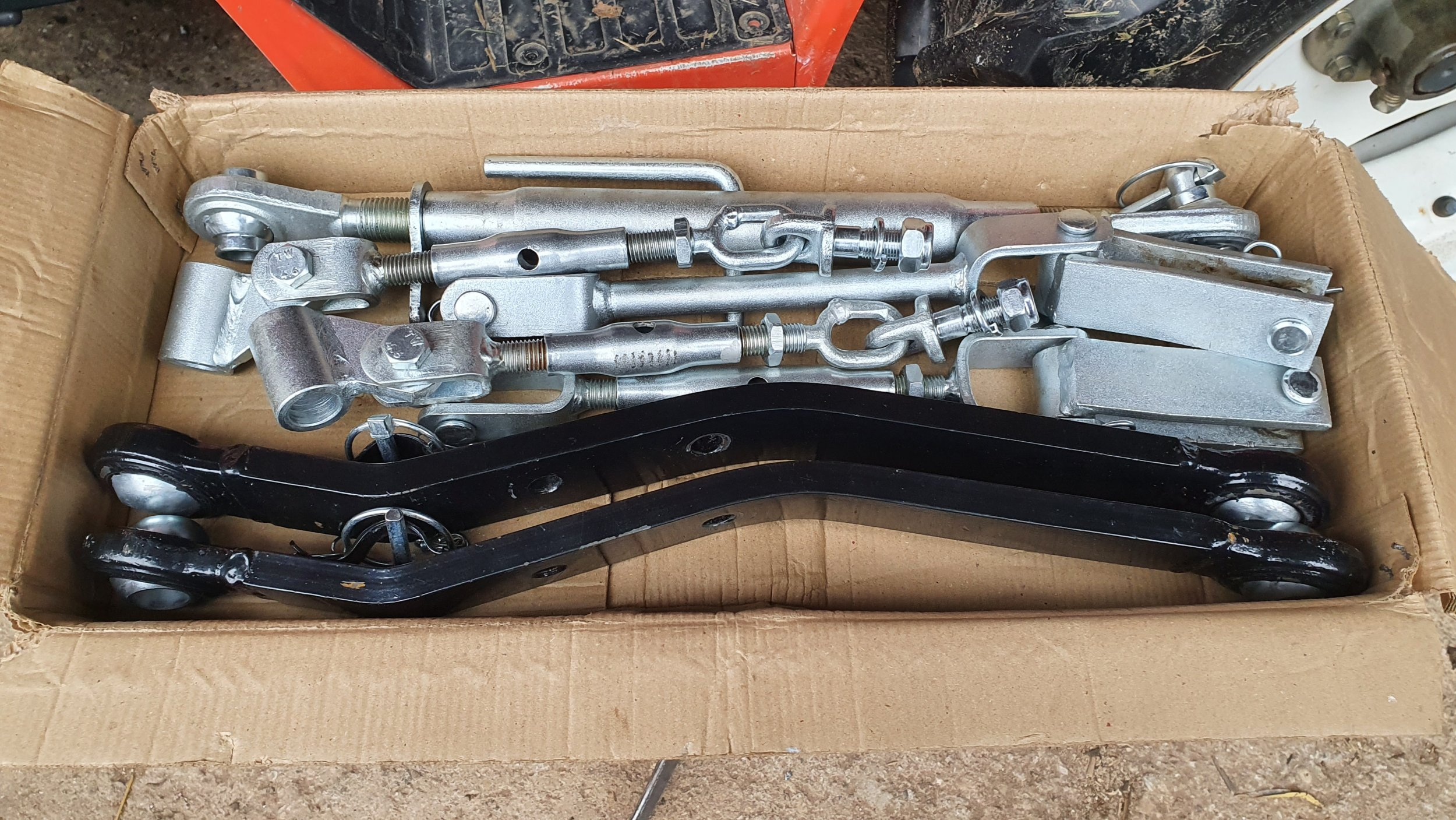

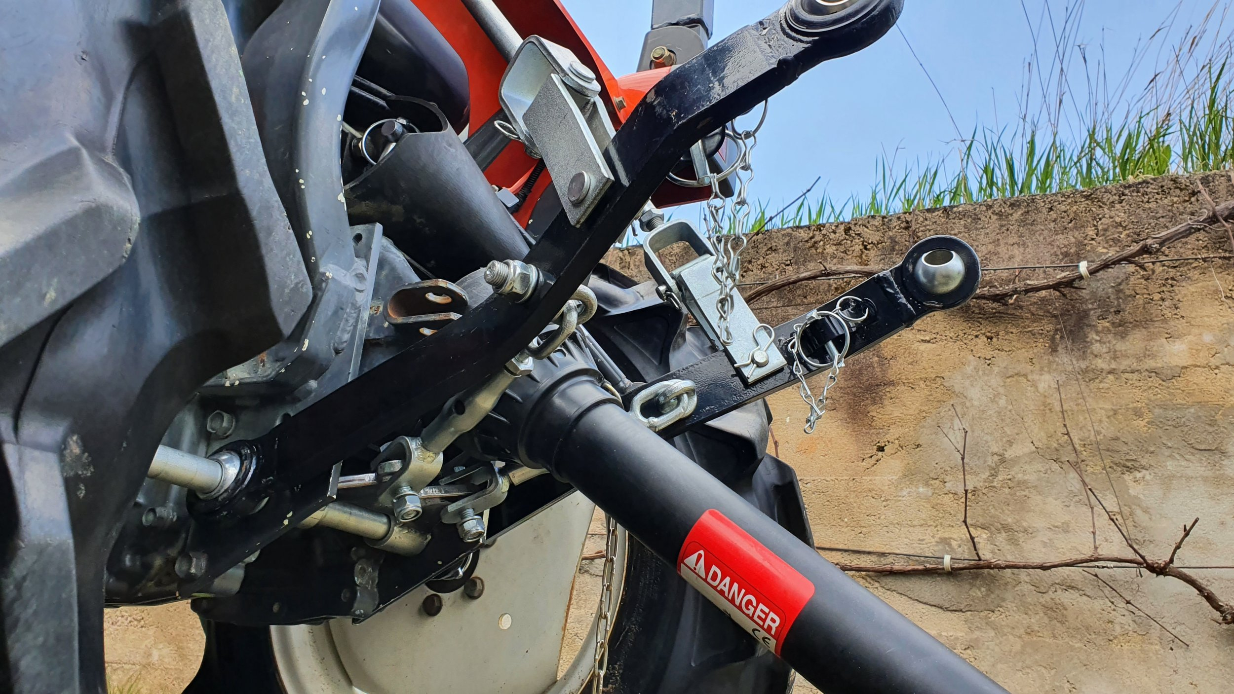

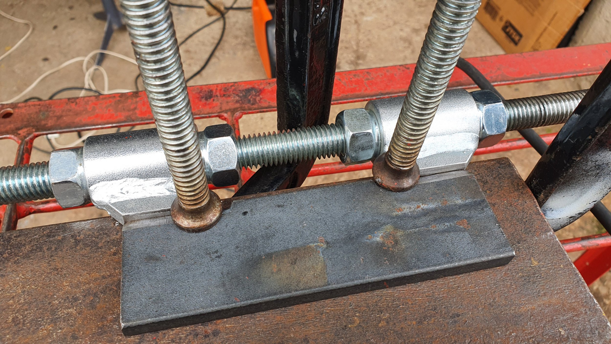

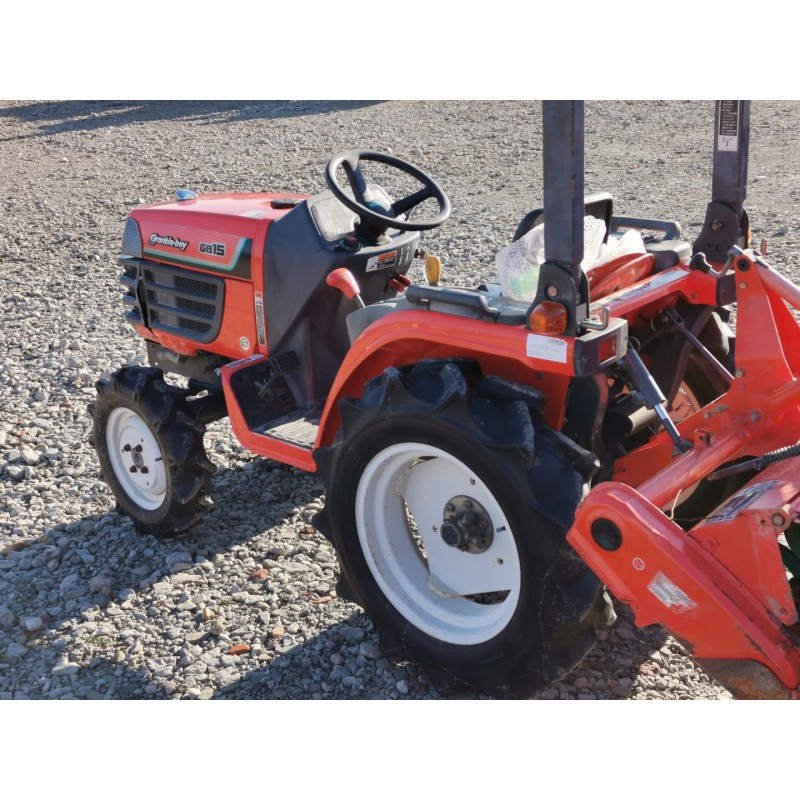

Installation of a 3 point hitch optional link on my new/old Kubota Granbia-boy GB-15.
I had to reweld the top ends of both lifting rods. Those were welded just straight. It was a need to make them under an angle.

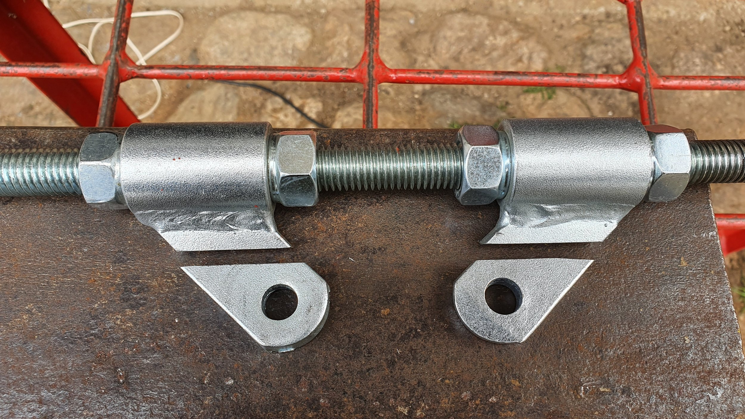

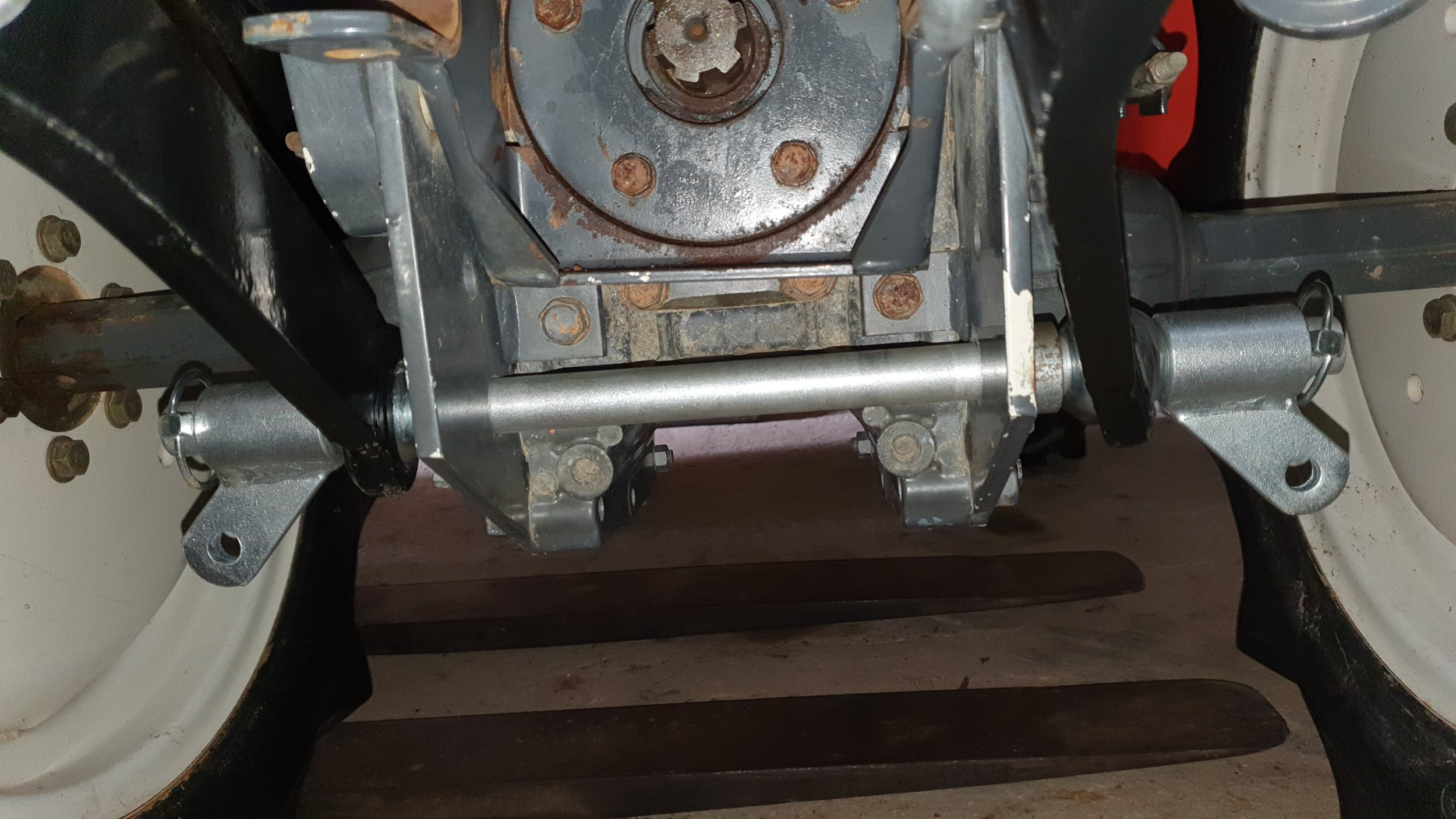

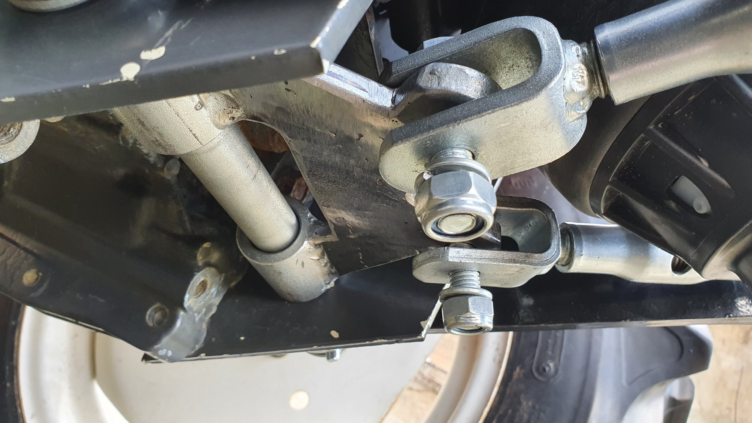

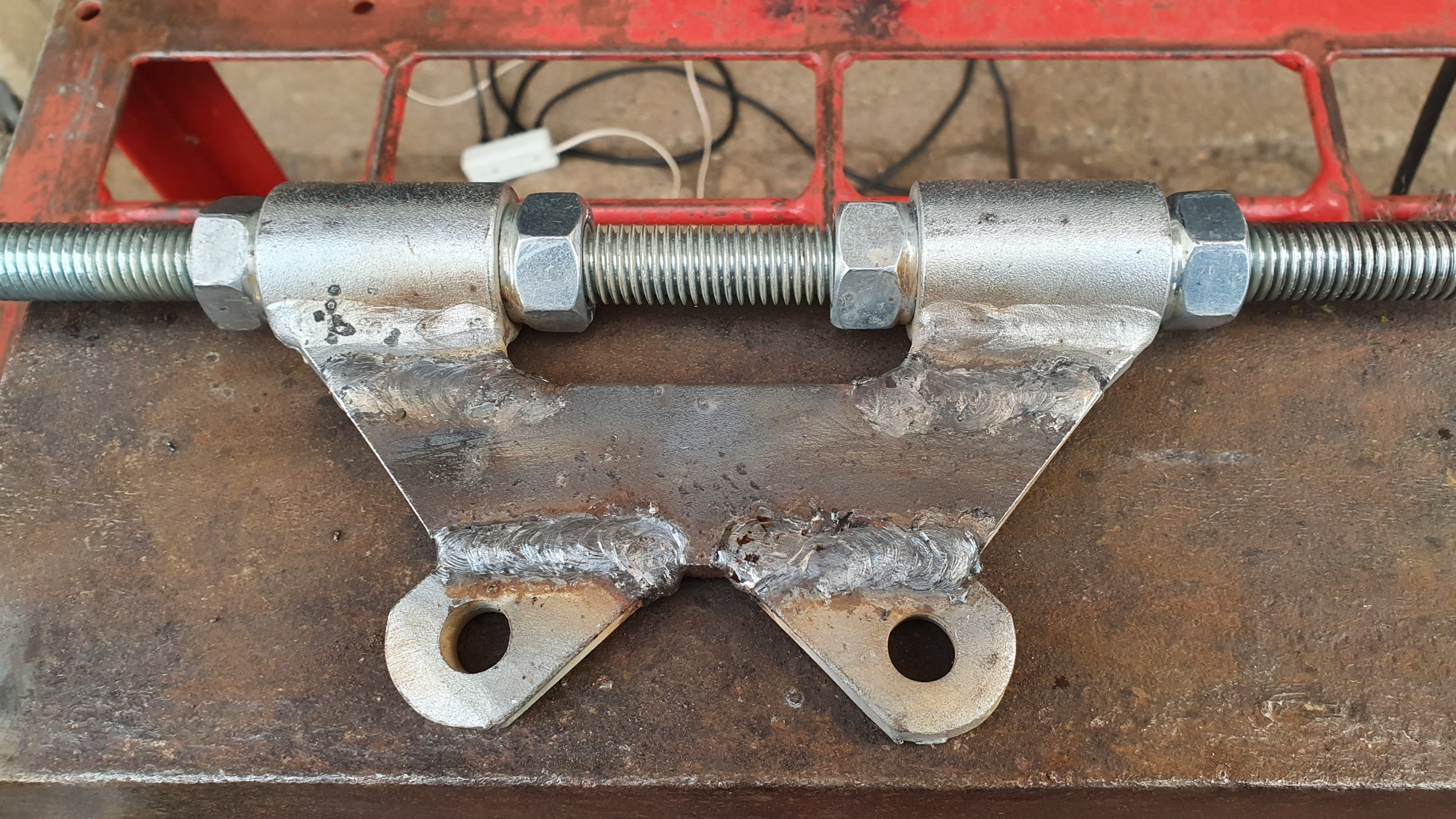

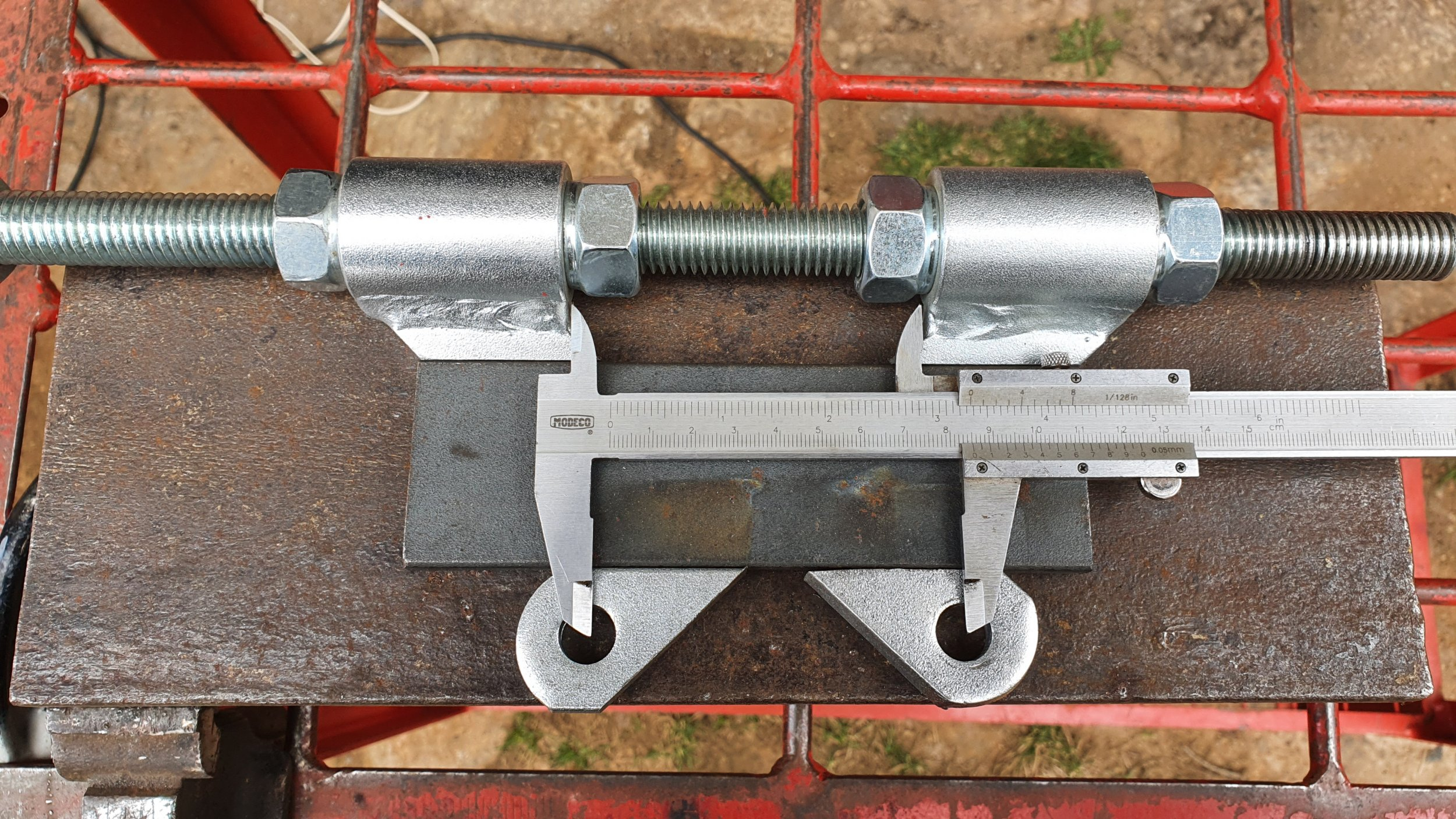

Another thing I didn't like was arrangement of the stabilizers. It was foreseen by a producer to mount them outwards. It looks not good to me. I decided to rearrange them to be mounted inwards.
To do this I had to remake two factory brackets into the one. It had to be cut both brackets and to weld them with a steel strip in the different way.
The result looks funny, but hope it'll work well.
It was important to avoid possible touch of a bracket with a PTO shaft or its plastic cover.
After an axle of lower links was shortened it was avoided of being bent load created by the stabilizers.

So I believe your modifications work just fine and there's no point changing any of it at this point.
However, as far as the stabilizers go you were correct to move them inside the 3pt arms, but.. On a factory setup (at least on my older Kubotas) they would simply go between the 3pt arm and the vertical bracket that the 'drawpin axle' goes through, not inside those walls as you have it. I do agree that what you've done would reinforce that bar if it were to flex enough to bind up in those sleeves, however I have not seen this occur on my similar size Kubota. No harm in your approach, though!
I agree that the yokes on those lift arms require some angle. I'm surprised they didn't come that way, but was the kit you bought specific for your Kubota or something universal?
/ Tractor Equipment Customization
I will use quite a comparatively heavy implement on this tractor - Mateng G.FM-150H finish mower with a hydraulic off set, which weights 266 kg. Although it is too big for this small tractor (it requires more HP), but the decision to purchase this one was mine anyway.
That's one of the reasons a 3 pt hitch linkage should be as strong as possible, and a 'drawpin axle' shouldn't get bent by stabilizers.
Yes, the kit is China made universal one. I'd prefer to mount telescopic stabilizers, but it is what it is.
Love good observations. (y) Thanks.

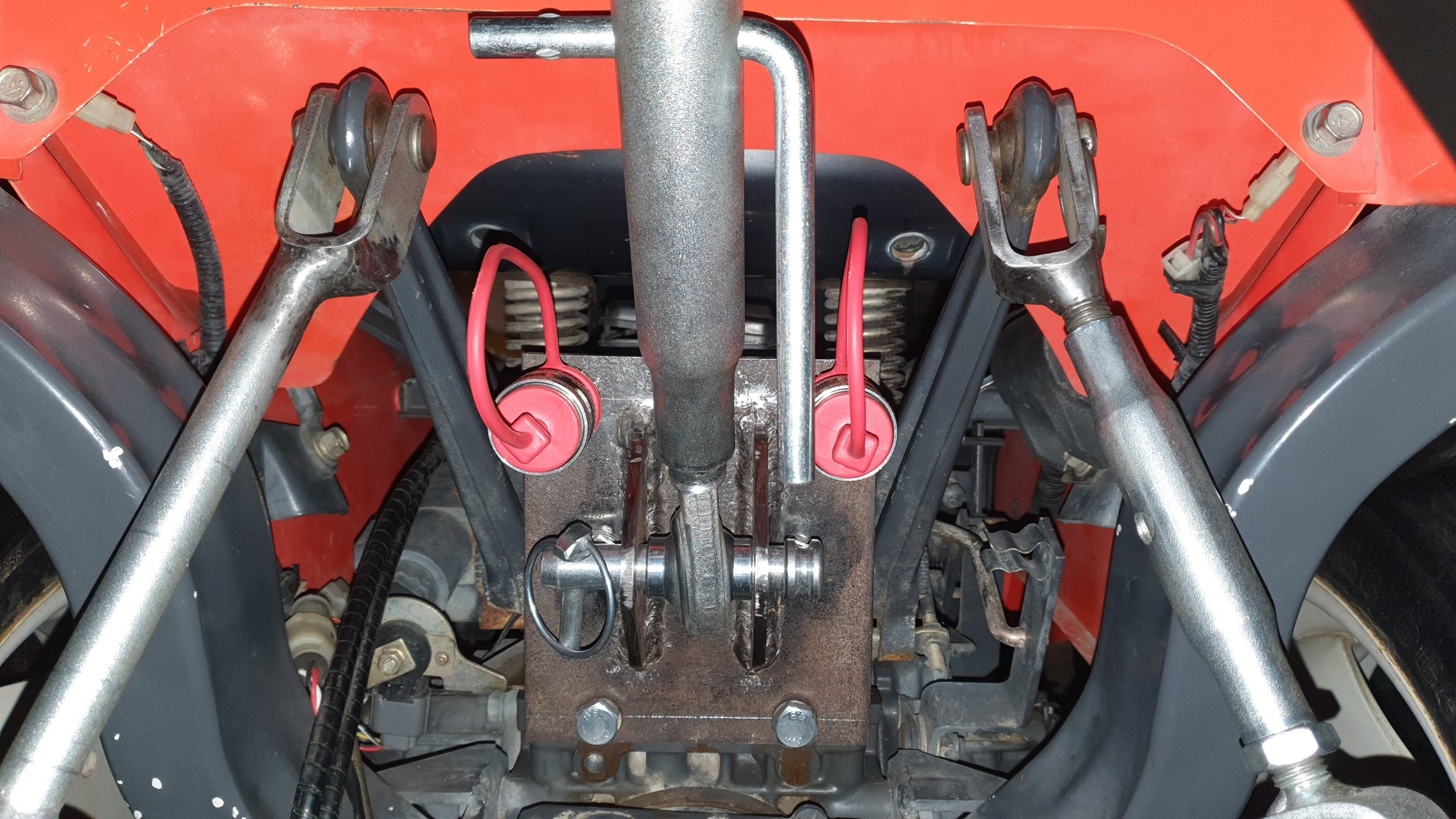

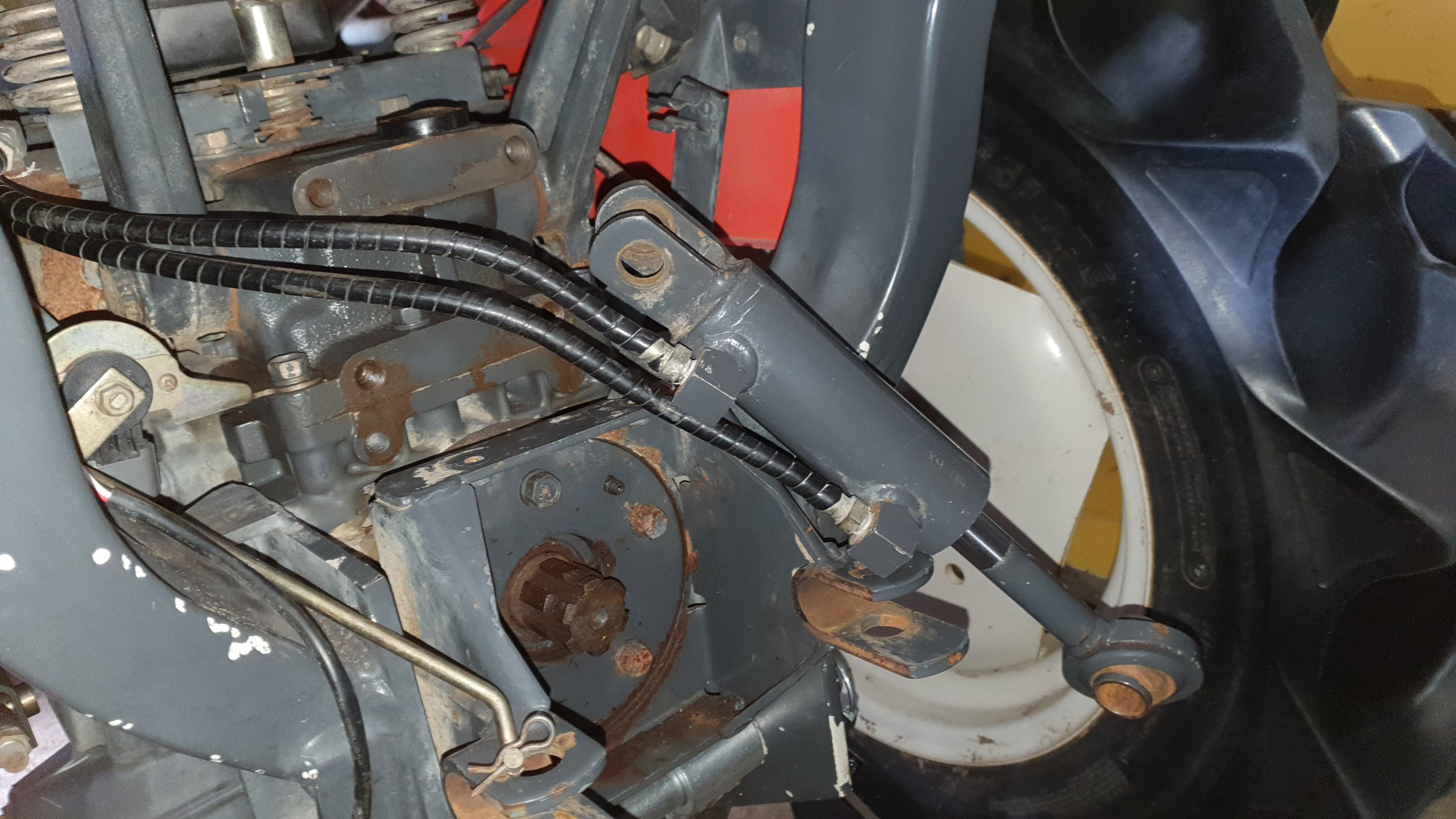

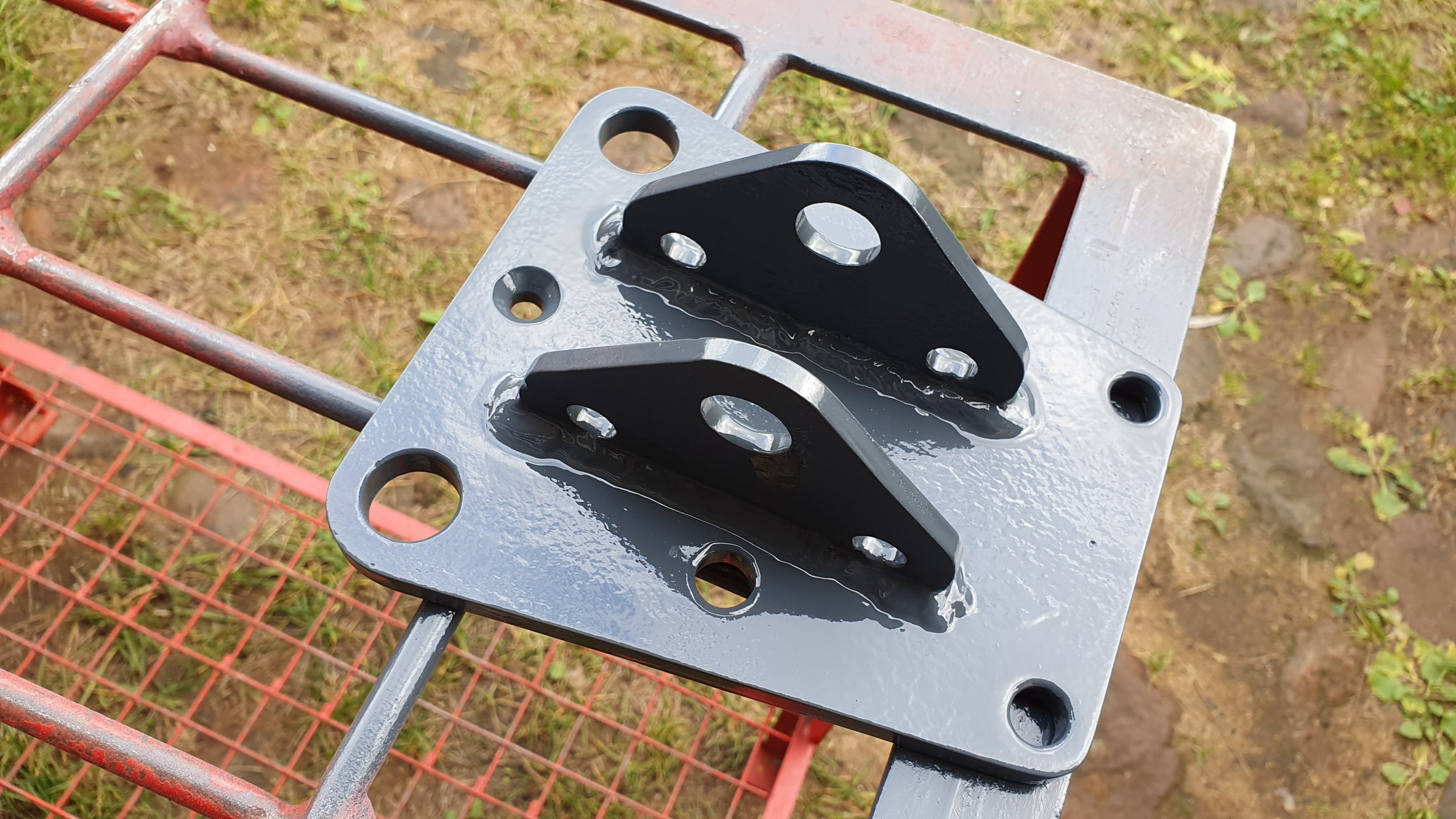

Next thing I have to do is to rearrange a stationary connected hydraulic cylinder, dedicated for the rotary tiller angle balance, into the port.
To do this I couldn't find a better place on a tractor to locate both ports except to fabricate a special 3 pt top link bracket to be able to fit them on it.

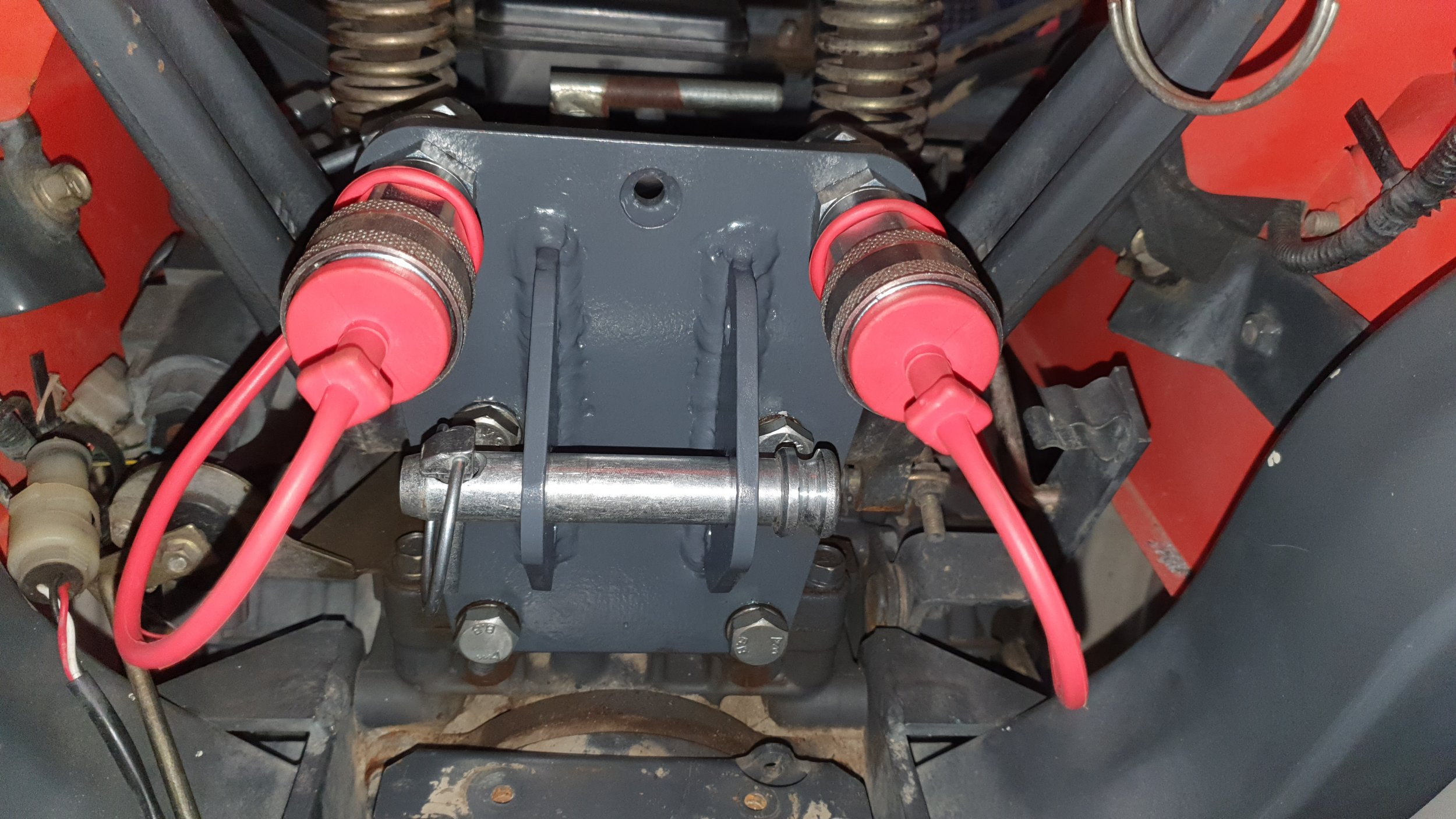

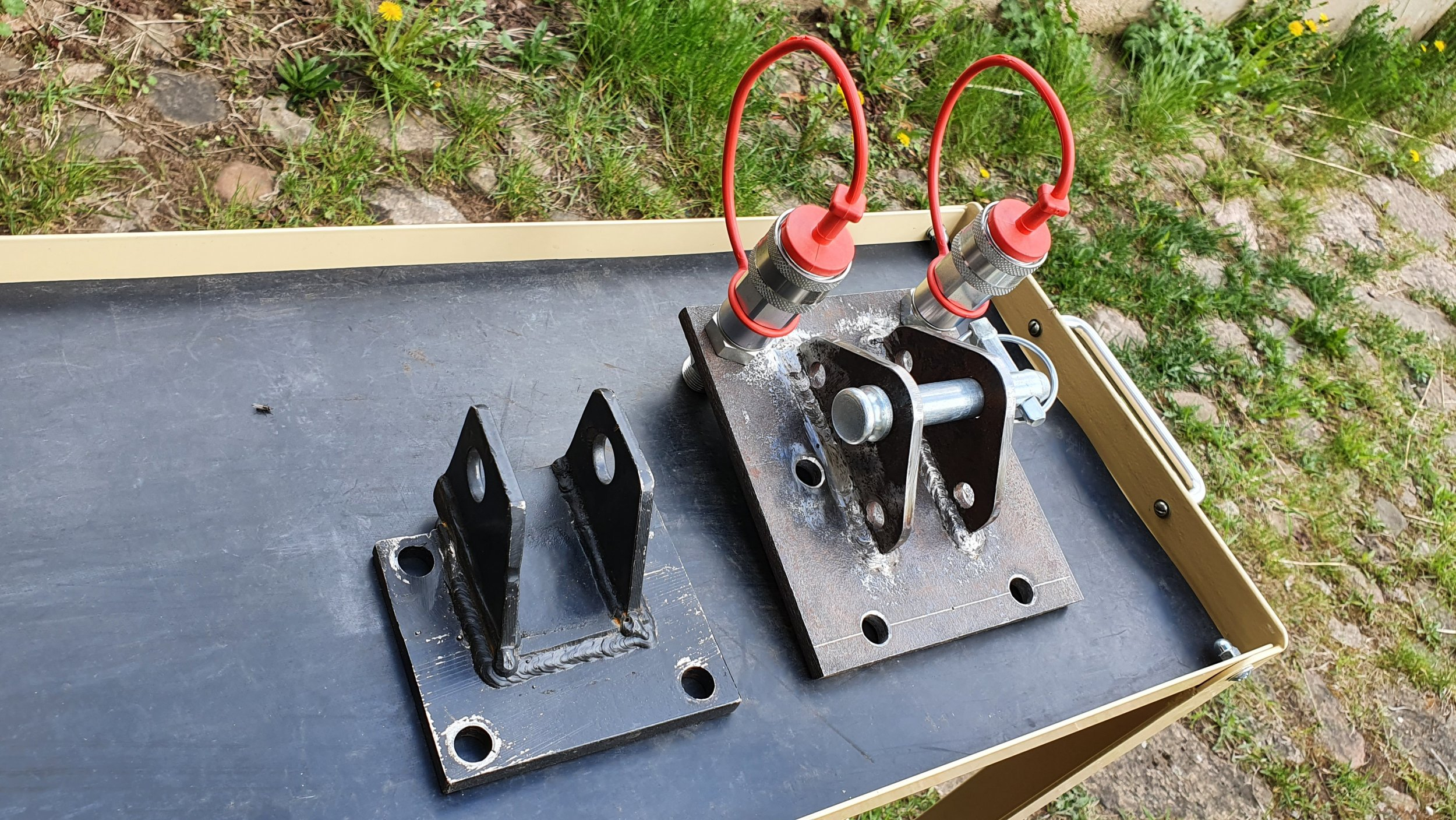

Okay, back to this project. I have cut and grinded the sides of the top link bracket with the integrated holes for the quick couplers and painted. I have to wait for the paint to dry to be able to assemble it with the already made hydraulic pipes. That will allow me either to connect former permanently connected hydraulic cylinder (post #5, pic #1) back again or, what is most important, the possibility to connect any other hydraulically managed attachment. And, of course, to connect a top link. Lets say - it'll be a double function component. :)
So, here it is on a tractor.
The layout of the hydraulic lines.
Control panel. In case of rotary tiller inclination management you can choose automatic control of a hydraulic cylinder (CAT 0). In other cases (CAT 1) - manual.
This job is finished. A static test was done, no fluid leak appearance was noticed. Engine rpms react to the press of the buttons. We'll see how it'll work in a field.
