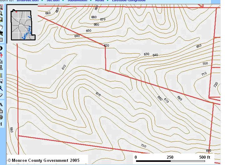

From the sounds of it, you should first measure the slopes that you think you need to drive on and find out the actual degree angle. You can eliminate many tractors right off the bat if they won't handle the slopes.

Hey Fellas - can't thank you all enough for your insight. To answer a few of the questions
yes I have a topo - see attached
Can't increase the budget any - already woudl be financing 1/2 that @ ~ 8%.

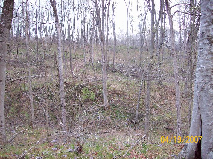

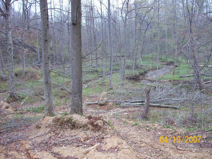

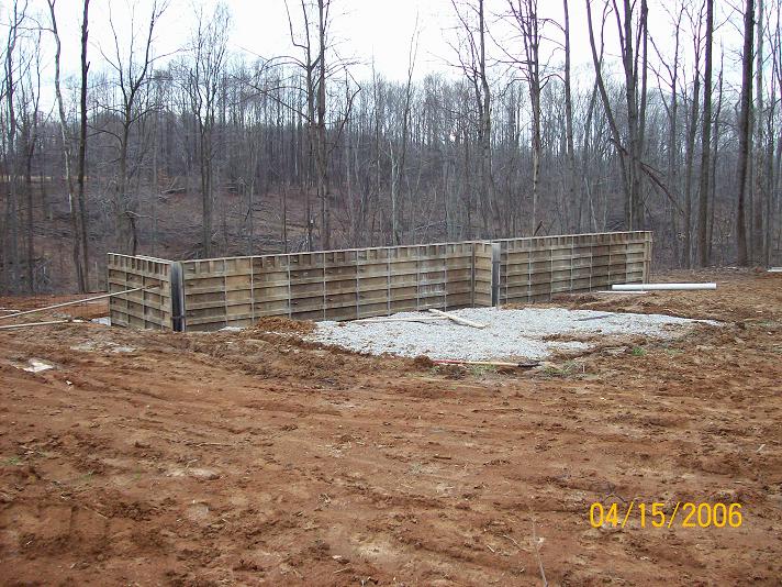

Tires - R1's definetly preferred! If I can' reduce the filesizes I'll include some property pics.

I don't think you are going to be able to find a tractor big enough for the task you need to do that will fit in your basement, possibly excepting some with a fold down ROPS. For your hills, a ROPS is a must.

The pics probably dont do it justice, but the hills dont look all that bad. Ive got one on my property that I went down the other day. Put it in low and kept the bucket low. Keep foot off the brake and clutch and let the trany/engine brake down the hill. Hand was on loader control to drop bucket if I got out of control. Going up is different since I have a road around it.
