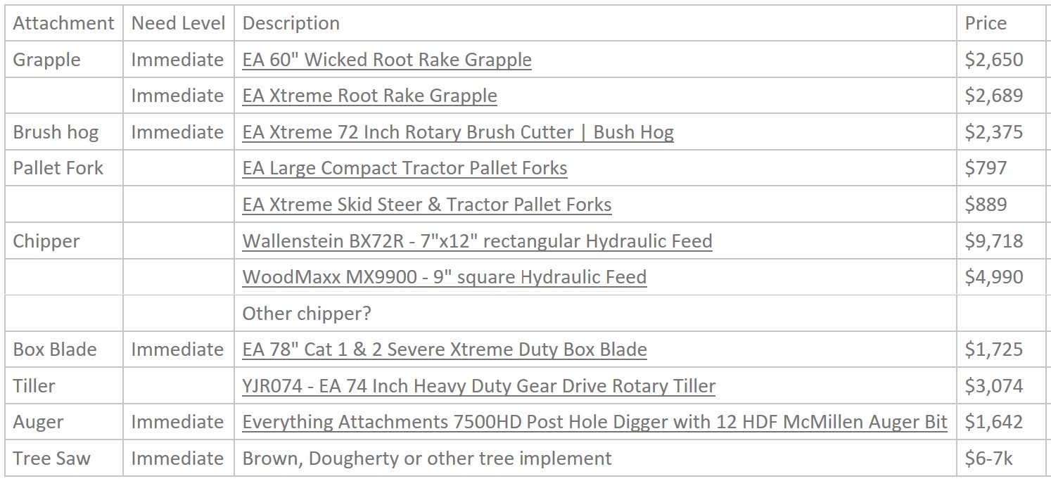

I think it was either 66 or 72". It was a verbal estimate. I looked at Everything Attachments and their 66" XTreme Duty Box Blade, 490 lbs, looks like a good deal for $893.
For the work you intend your Box Blade should weigh at least eighty pounds per foot of width. 490/5.5 = 89 pounds per foot of width.
I recommend you not finalize Box Blade order until the tractor is home. You want Box Blade to be 12" (+/-) wider than your tire width (3" to 6" on each side) and you will not know tire width for sure until tractor is with you.

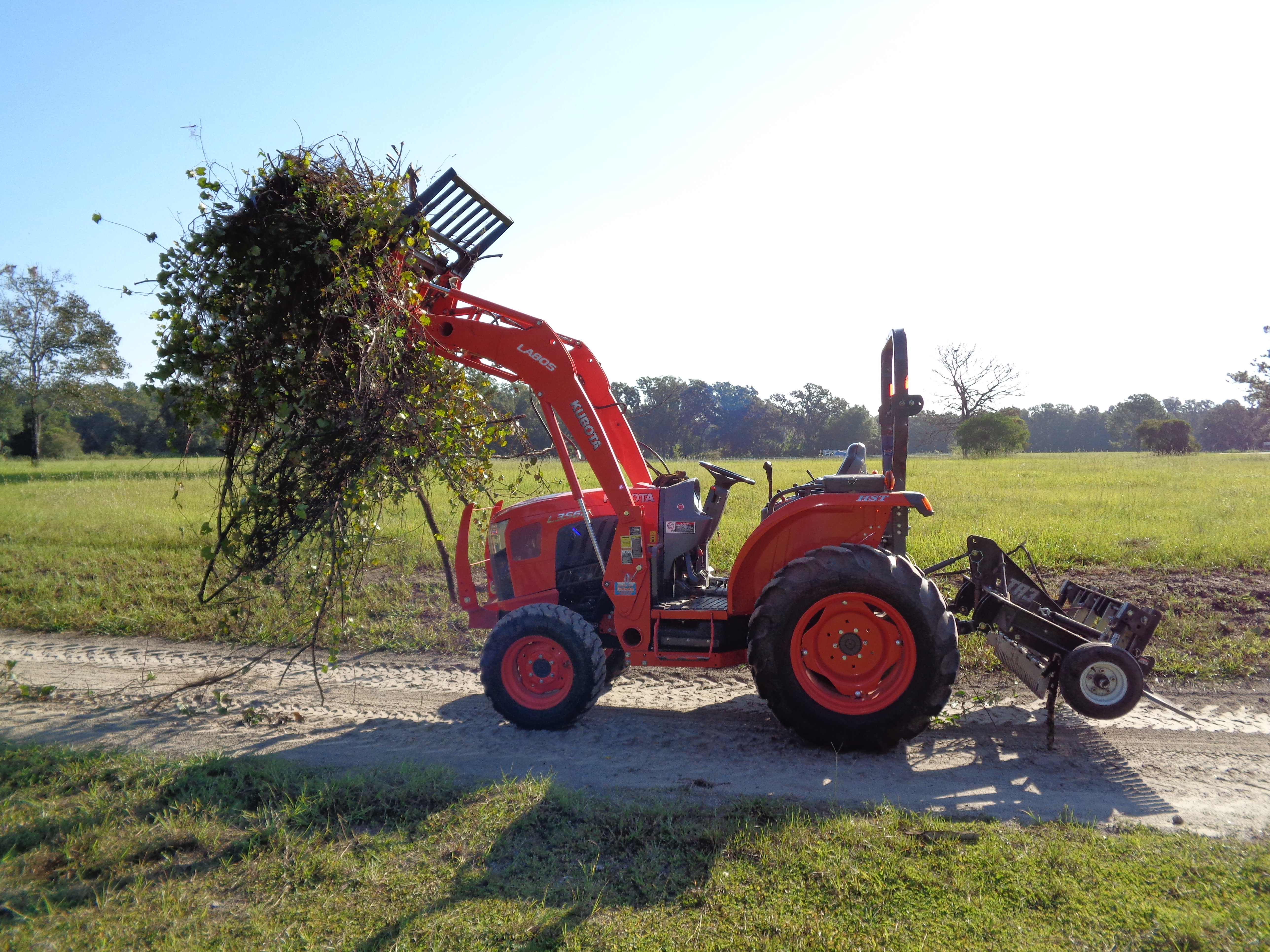

I have several ETA implements. Very sturdy and satisfactory, with the exception of paint. I think ETA is so busy they ship before paint cures. (ETA will paint your implements Kioti orange for a modest additional charge. ETA'a Land Shark implements are orange, so orange paint is relatively simple for ETA. )
I do not have a grapple form ETA but ETA grapples are reviewed well here by experienced tractor people.
Dual lid grapples hold material in bucket more securely than single lid grapples. Unquestionably.
However, I practice the KISS PRINCIPLE (Keep It Simple, Stupid) and if i were shopping grapples I would consider a single lid because of simplicity.

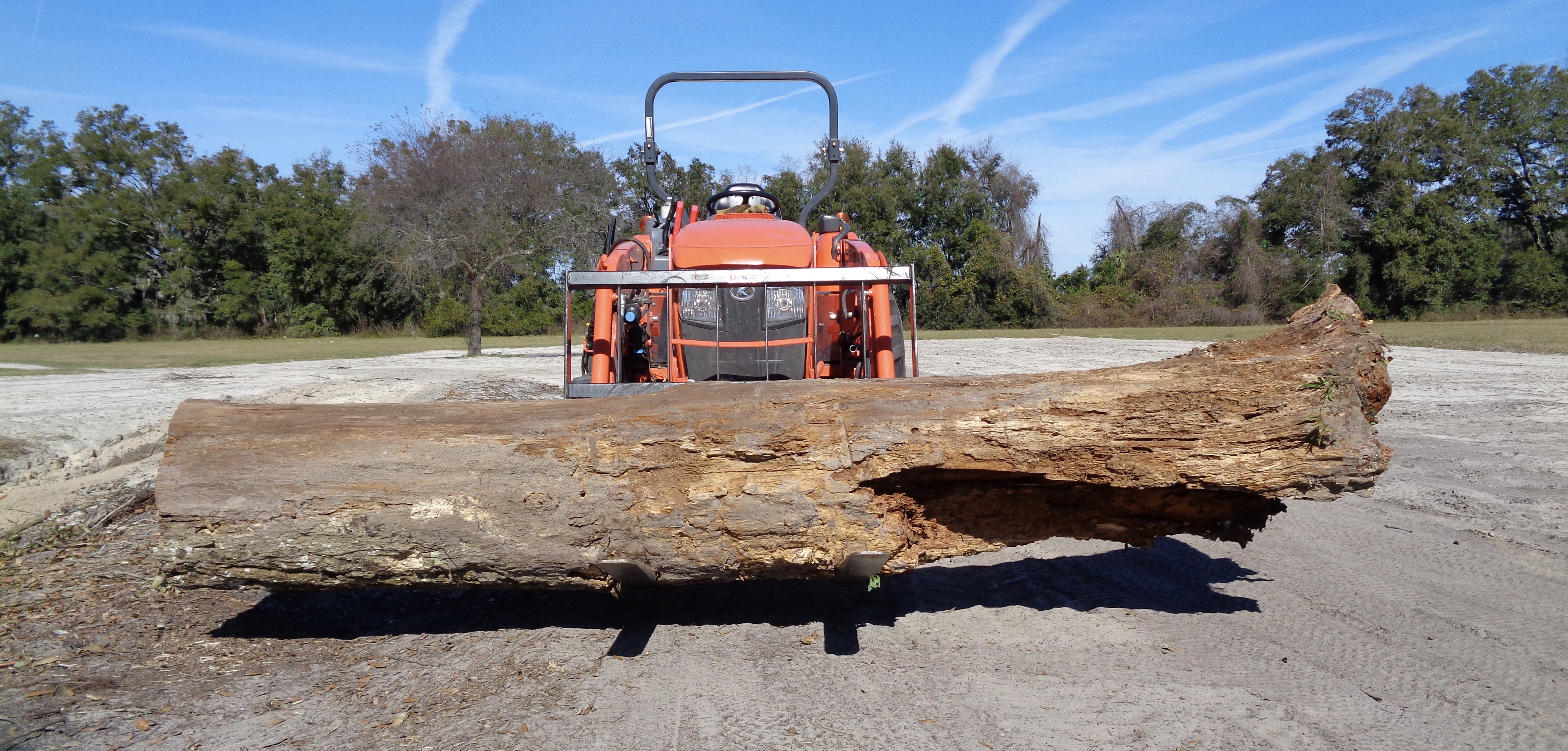

I use SSQA Pallet Forks rather than a grapple, partly on the KISS PRINCIPLE. Works for me.
My Pallet Forks are branded Construction Attachments, sold by ETA. Excellent build.

My husband and I would like to ask for some help in choosing a tractor. We are going to a Kioti and a Kubota dealer this weekend to look at open air tractors (hubby doesn't want a cab). We have almost 40 acres that was recently paid off and we would like to build our home and a barn on it. About 1/2 the land is 2-3" saplings with some trees about 5-6" wide.
Initially, we would like to use the tractor to clear about an acre of trees, add fill dirt to raise up the driveway, and add about a 15' culvert (maybe a 12" pipe would work). We were quoted $4k to clear (mulch) the 1.25 acres of trees and $7k to level the driveway and install the culvert. Maybe use it to excavate our foundation if it could do it (crawlspace). We would rather put that money towards a tractor and put in a few months of hard work to save this money.
Afterwards, the tractor would be used to bush hog a few trails around the house, maintain a 1/4 gravel mile driveway, and transform a 2 acre low area near a creak into a garden / orchard, and install some fencing. We plan on a few chickens, goats, small farm and other land maintenance.
Would we be able to do all of this with a tractor? What size tractor would you recommend? Are there any implements besides a bush hog, front end loader and maybe a backhoe? We'll probably need an auger later. We've seen forestry mulcher take down trees, but there's not much information about using it on a tractor.

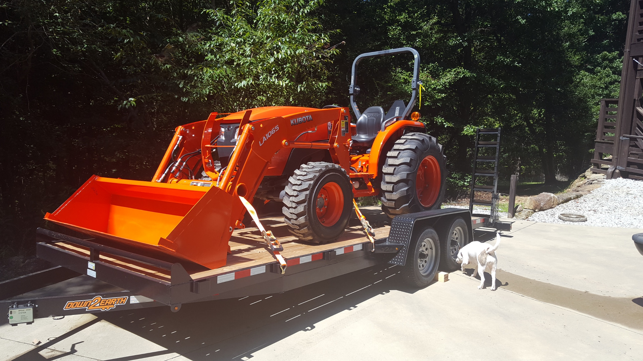

3) TRAILER Pulling a tractor laden trailer without separate trailer brakes is extremely wearing on truck brakes.
May be cheaper in the short run and long run to have dealer transport your tractor as necessary with his HD truck, HD trailer, ample tie downs, experienced driver and liability insurance. I have my six mile distant Kubota dealer make my tractor moves for $2 per mile from dealer to my destination, plus a tie down fee. $2 per mile round trip.
Our Kioti dealer is only 8 miles away and was really friendly and informative. They can also service the tractor.
