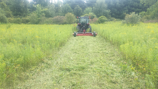

I run a 7 foot BH27 on my M8540 next frame size up. Im sure the M6060 would run it fine in tall light brush. Youll need front weights if you plan on running with no loader. With the M7060 you also get limited slip front differential.
If I start hitting lots of thick stuff with sapplings it can tax the 75 pto hp I have available. Normaly it runs it just fine without even flinching.
The M7060 and M6060 share the same frame only differences in size should he tires. I don't think id want to drop down to an L60 series or its cheaper sister in disguise the MX series and run a 1300- 1400 lb cutter on it thats almost 11 feet long
Bush hog recomends a minimum of 55 pto hp to run the 7 footer
I agree.
I have a Rhino 7' and it's a load behind my 70hp if I'm in really heavy grass or brush. It literally pulls harder on the engine than my 10' twin spindle cutter. I personally wouldn't want any less tractor than what I have for the 7'.
