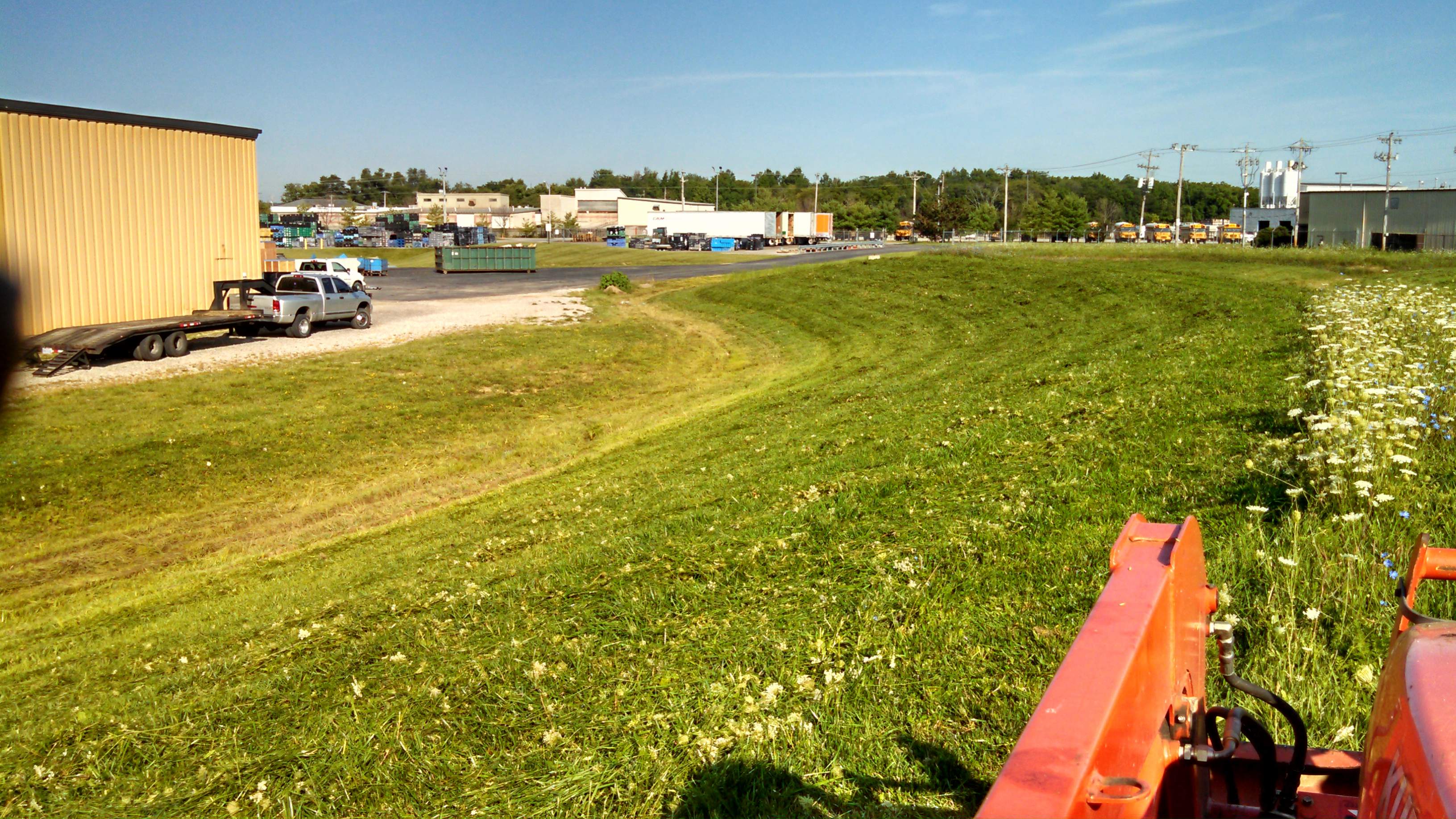

I run a heavy 6' cutter with 29 PTO HP. And while there are many times I get into thick stuff that will slow me down to 3rd gear (2 MPH), FAR more often I am slowed down by terrain being just too bumpy. I like mowing in 6th gear, which is 5.3 MPH. And frequently have to slow to 5th (4.1 MPH) just because it is too bumpy, or am maneuvering around trees, buildings, etc.
My point is simple. It is my opinion to get the biggest cutter you can run in lighter conditions. Cause you can always slow down. IF you size the cutter for heavy conditions, there is a limit to how fast you can speed up when conditions are light. Those guys running 7 and 8' cutters with 70-80HP, thats fine if you are always cutting heavy stuff. But what about something like this? I was able to mow 6th gear, 5.3 MPH, with 29HP and 6' and it wasnt a load at all. I have no doubt that I could have pulled an 8' cutter just as fast.
With 80HP and an 8' cutter, In theory you could go faster. BUT, terrain wouldnt permit much more.
These are just my opinions and observations based on mowing 400+/- acres over the last few years in every type of condition imaginable. And while some may thinl 6' is too much for my 29HP, I have cut some really nasty thick stuff and still have never had to touch 1st and 2nd gear.
