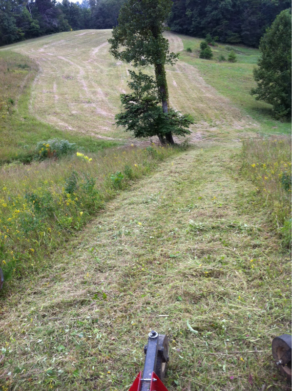

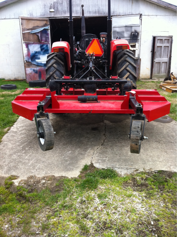

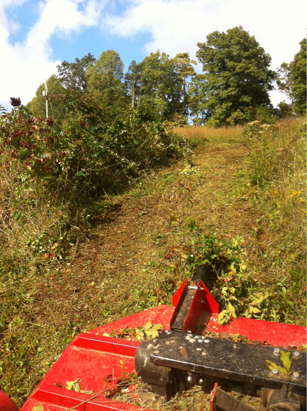

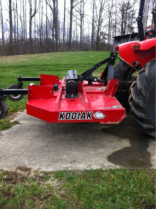

I run an 8' dual spindle cutter with a 56 PTO HP Zetor. It could certainly run on less HP, but as others have said, pay attention to weight. Mine weighs 1550 lbs according to the manual, and while I've never ran out of power, I'm glad I have a pretty heavy tractor. You don't want the mower pushing you around if you have hills to mow. I also believe a pull behind requires a little less HP than a 3-point model as well. That said I have no problems with either on my tractor. I don't know how the tractors your looking at compare in size and weight, but here are some pictures of mine for your reference.
Nice mower ... but I can't imagine that a 3pt model would require more HP to run than a pull behind one.
