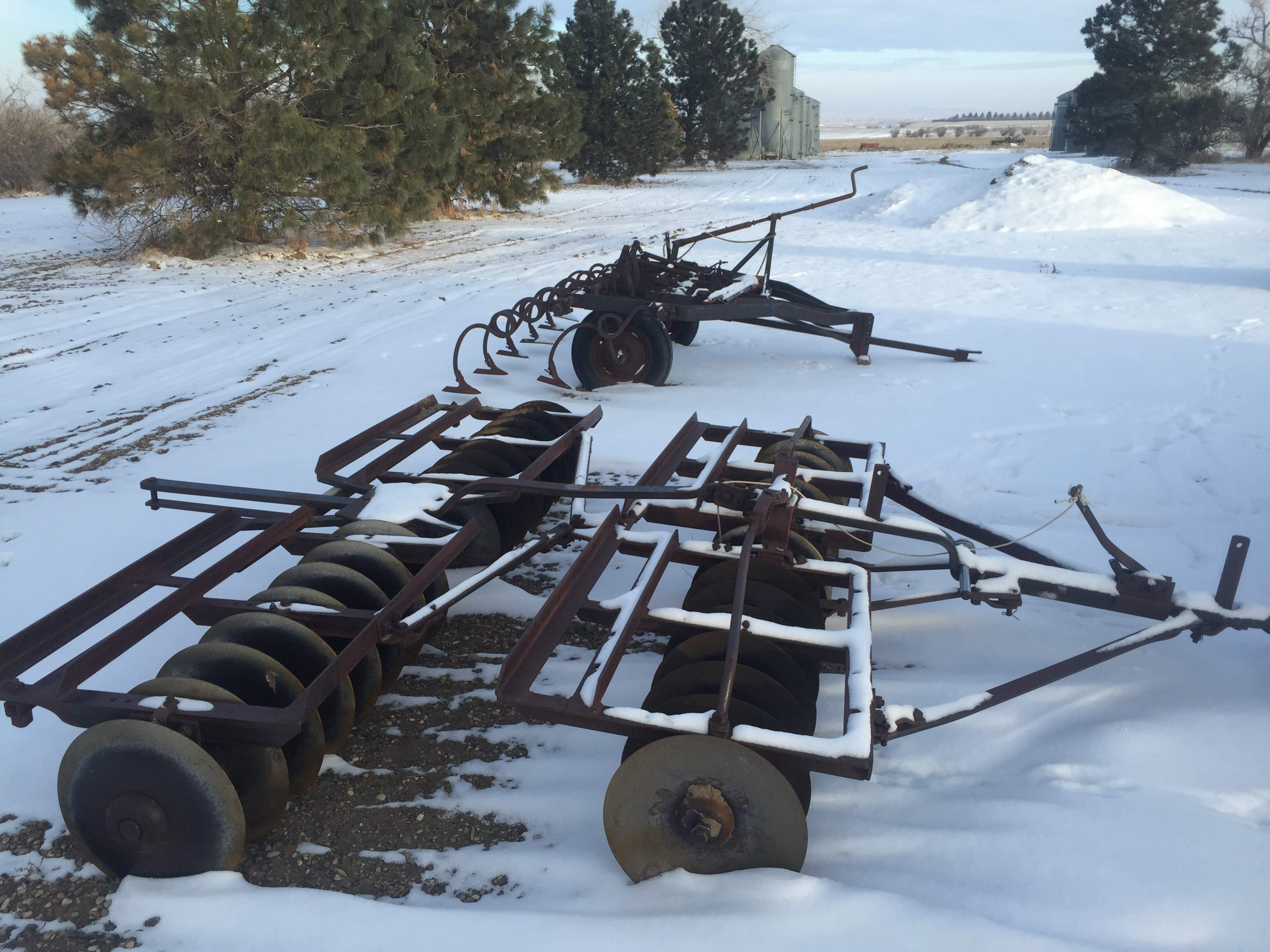

Greetings I'm the lucky buyer of an old farmstead and all the old junk that goes with it scattered across 37 acres.
I am shopping for a new tractor and am leaning towards an HST but have not made the final decision yet.
I will be needing to pull a disc and duck foot about 5% of the time. The rest will be mowing and digging out snow and dirt work.
What I need to know is how much horsepower will I need to pull this equipment? The previous owner told me 50hp but that was on a 2 wheel drive older JD.
The ground has a lot of clay in it but he kept it broke up around the trees so I don't think it will be real hard to keep it that way.
Thanks in advance

Welcome to TBN. To pull either of the two implements I would recommend 4WD and at least 75 engine hp. Both of those implements are fairly good sized. It would probably be more economical to drop down to 50 hp/4WD and properly sized implements. You could sell both of those implements and use the money on the new tractor and implements.
/ Tractor size question #3
Fifty horsepower with 4-WD is about minimum.
Did the two implements in the picture convey with the property? What you call a duck foot would be termed a Spring Tooth Harrow, here.
I would not automatically plan to use conveyed implements on a Montana property.
Montana has all sorts of soil erosion, soil degradation and soil depletion issues. I would research state of the art tillage tools where you are. It may be Chisel Plows or "no till" practices will use less water and reduce depletion of your soil bank. Disc Harrows leave the ground bare and subject to wind erosion.
It would be helpful to know what crop you intend to plant. From what I know of Montana ag it is cattle, sheep, wheat and hay, all barely profitable.
Most Montana families farming 37 acres would have one or two principals in non-farm jobs bringing home a steady paycheck in order to support lifestyle farming.

What you call the duck foot is what we call a cultivator in my area. That implement will not require any more than 50 hp. They take the ground pretty easily. Thè disk is the unknown factor. It depends on how heavy it is and if the rows of disks are angled or if they run straight across. Also depends on how deep you sink it. The deeper you drop, the harder it pulls. If it's just to make a fire break, it wouldn't have to be that deep. But if you were breaking ground to plant, then it would. I'd say 50hp and 4wd would be plenty.
/ Tractor size question #6
. . . I guess my real question is how does something like an LS 46 hp hydrostic drive 4x4 compare to the 50 hp John Deere he was doing it with?
It depends on which 50hp John Deere he was using. I know that sounds stupid, but it's not really. The old John Deere tractors from the 60's and 70's might have had 50hp and weighed 8,000 pounds. A newer one might have 50hp and weigh 4,000 pounds, which means they will like lose traction before running out of power.
For example, I grew up driving old Minneapolis Moline tractors that had less than 50hp but would have pulled either of your implements without breaking much of a sweat. I think my 50hp Kioti with HST would sweat a LOT trying to pull the chisel/springtooth unless you were just scratching around with it.
You can always remove one or two of the outer shanks on each side to effectively narrow it and reduce the HP necessary to pull it.

One more thought. I've used lots of disc harrows, but I've never used a drag type like yours without any gauge wheels. Yours is set with almost no angle, which I assume is a "transport" position to allow it to be moved without actually plowing the soil. It won't do any plowing the way it's set now.
I assume there is a mechanism on it to put the gangs back into a more acute angle so it will actually turn the soil. It may involve pulling that rope and either backing up or pulling forward to force the gangs into an angled position. Forward would move the center of the front gangs into position, and backwards would move the center of the rear gangs into position. (At least that's how I assume it would work.)
You probably know this, but I thought I'd mention it just in case.

That's a nice field cultivator with those transport wheels. 50 hp (engine) would be enough to handle it in dry or damp soil.
I had a disc like yours--an old Massey Ferguson about 7 ft wide. It was pretty lightweight, so I had to add about 500 lb of weight to get it to plow effectively. Used it and a homemade drag (a piece of chain link fence loaded with concrete weights and chained to the disc) in my 7 acre hayfield for secondary tillage and also for cutting about 1/2 mile of firebreaks along my fencelines. My 2008 Mahindra 5525 (55 hp engine, 2WD, simple gear tranny, weight about 7500 lb with FEL and loaded rear tires) handled it easily.

Personally, I wouldn't even use the tillage tools you have.
I'd buy a 50hp FARM tractor with a GOOD rotary cutter (brush hog) and a heavy duty 3 point rototiller.
For brands, I would buy a 6' medium duty Woods Brush Bull for the rotary cutter.
For the tiller, I'd buy a 6' Howard, Kuhn or Maschio, what ever is available to you, and the tiller would have a gear box rated for at least 70hp.
Those two tools would do everything you listed above and do them better than what you have...
I said FARM tractor because they are heavier built that a compact tractor... Heavier built and will take HD work loads longer. One example is a Case IH JX 65. It's the economy version no frills tractor that is heavy duty enough to last a long time.
