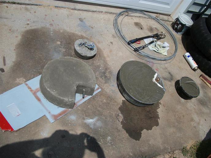

i cast some concrete weights and hung them on the front of my ford 4600 I mow with as I have to trailer up a steep incline and with a hd 6' mower on the back it was getting a lil soft in the front.

The main problem with concrete is that is is so much less dense than lead or cast iron.
HTH----gunnner;)
and the main plus to concrete is you can cast it yourself, easilly, and it's super cheap.
I can hang as much concree weight on the front of my tractor to do the work for about 20$ of materials, vs 200$ of suitcase weights.
ok.. so they are a lil bigger.. but then.. so is my wallet at the end of the day...
money is worth more to me than bragging about having a metal weight.
soundguy
soundguy
Nicely played :thumbsup:
/ TRACTOR WEIGHTS #20
i know some people have to have oem parts emblazoned with their brands logo and whatnot at 2-5x the cost.. .. um.. I just want the weight. add a few minutes work and some black paint and at 10' away it's hard to tell my cast concrete weights aren't cast iron weights due to texture, etc.
soundguy
