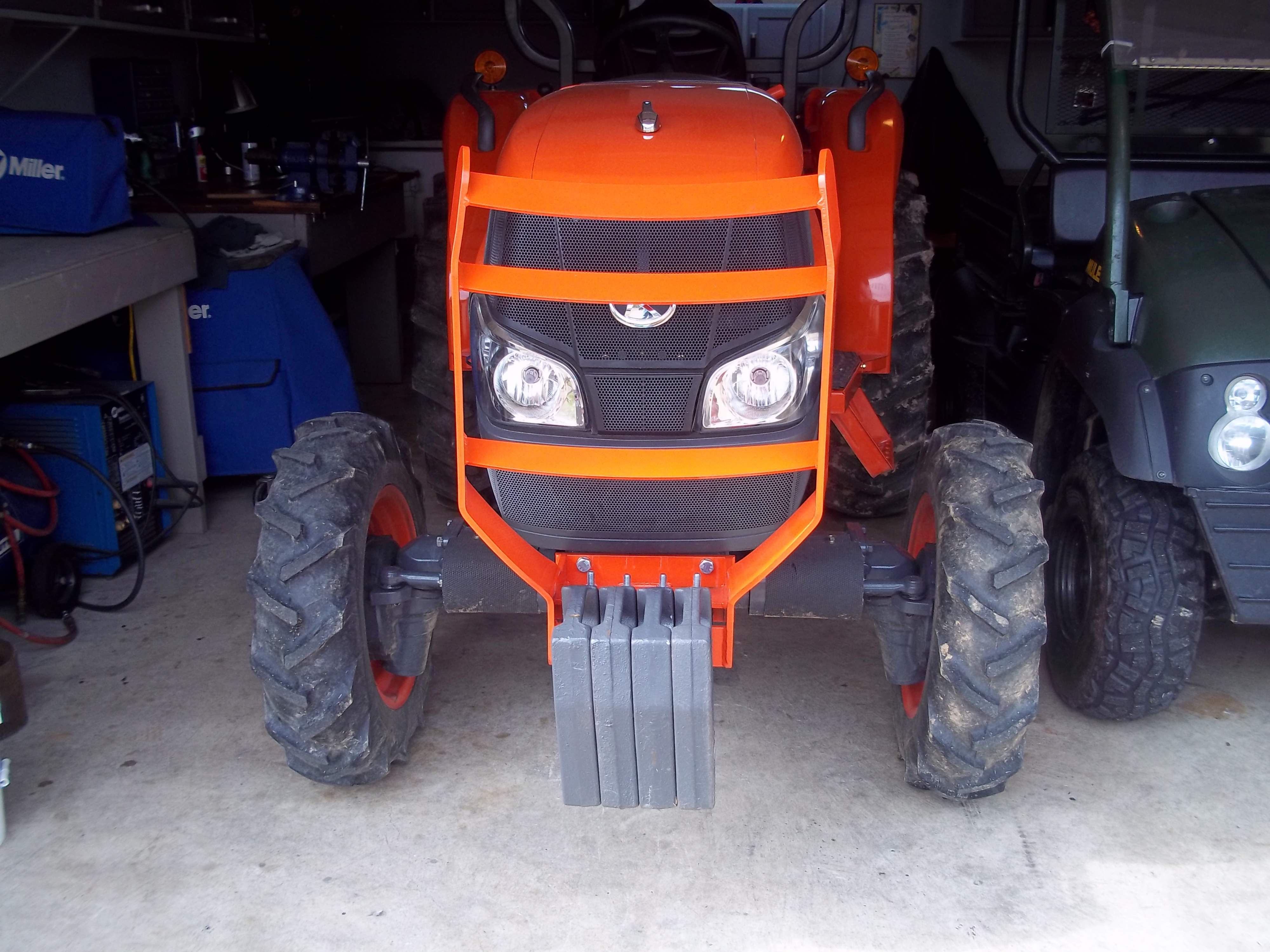

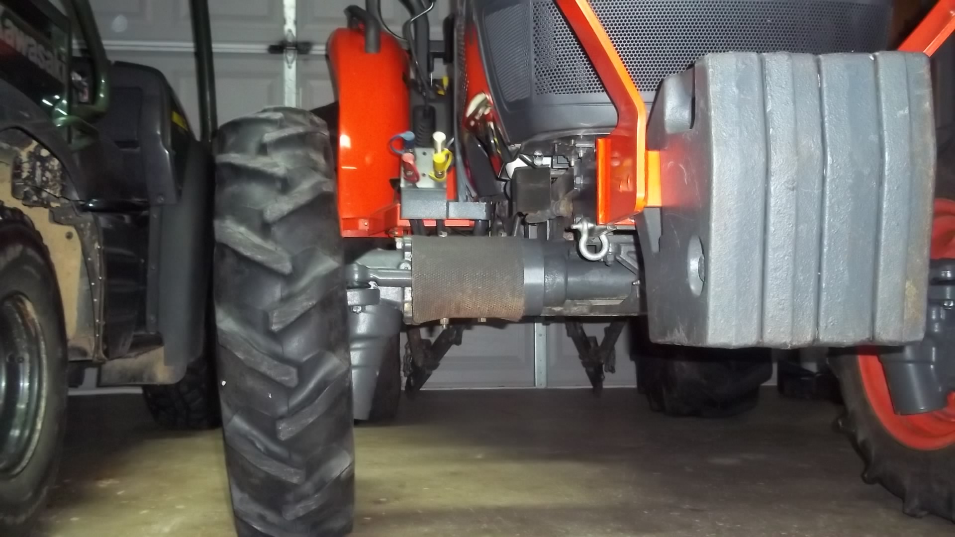

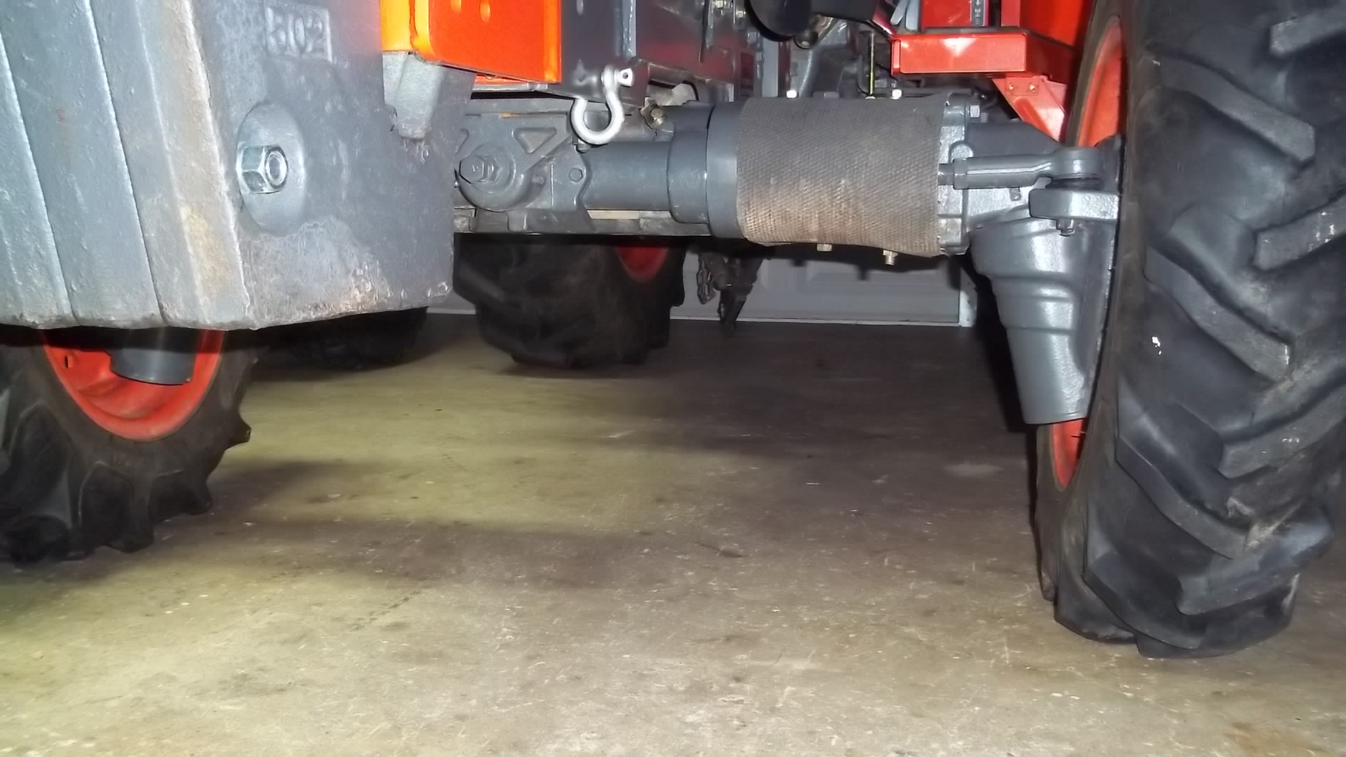

It took some patience, but I found my (5) Kubota weights on craigslist for $25 each. I just saved a link for "suitcase weights" and checked it everytime I remembered.
