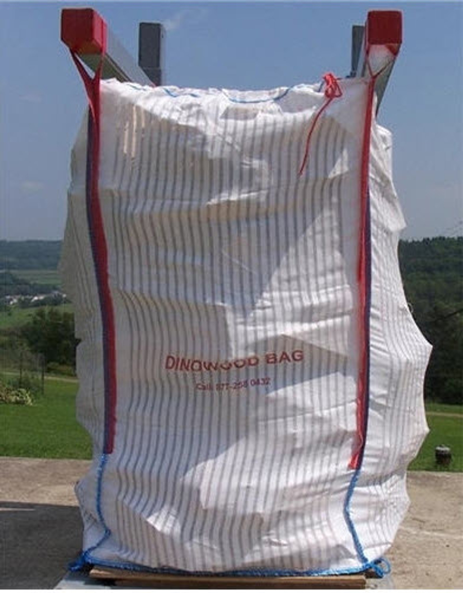

Hey
we are using those bulk bags (we call them bigbags :))
Couple years back I got 30 pcs, paid 8.5 €/pcs
They are holding together rather good. I mean, the worst enemy of them could be UV - direct sunlight. So we are storing them in a shed. Only roof, no walls around.
Ventilation is key factor for drying
I dont know how it's by you, but here are available special "bigbags" for firewood. Two walls are made from net, not that dense "textile" as regular bigbags are made
So no a problem even if very wet wood is being processed and stored directly into bigbag
And another advice. Those bigbags are rather tall, My FEL cant hold them by those top loops. But frame of FEL and forks are symmetrical. You can flip forks from "L" to "Г", thus gain 1/2 metre. Just what's needed to handle bigbags
I just hope you can understand what I meant. Can't find a pic of this

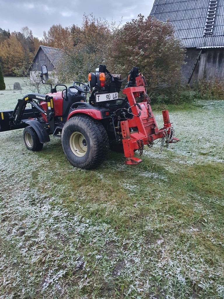

My beast :ROFLMAO:
Just wondering.
I have rather "vintage" winch, with respective old steel cable. Not entirely happy with that
Thinking, maybe to replace it with Dyneema ?
Or that is stupid idea to use synthetic rope in forest ?

The synthetic rope is lighter and easy to handle. Also strong but the abrasion resistance is not good. As you know from experience steel cable lasts a long time.
I like your nice old winch - nothing wrong with that !

The sun degrades synthetic tope too, but the lack of abrasion resistance keeps me from wanting one on my skidding winch.
SR
I am not so much concerned about UV caused degradation
We can always work at moonlight, doesn't ? :ROFLMAO: :ROFLMAO: :ROFLMAO:
I am looking to give lighter winching jobs to kids. They could collect smallest logs. That's a lot of climbing around, job like just made for teenagers ;)
Lighter rope will mean a lot for them
And Dyneema not THAT expensive here.
D5 mm / 2,4 T rated / 35 m (115 ft) = 78 € + shipping. For 10 € they will drop on top HMPE protection
I mean, will give it a try

Let us know how you like it and if it works out for your use. It is amazing you can get 2.4 T with a 5 mm (3/16) rope.

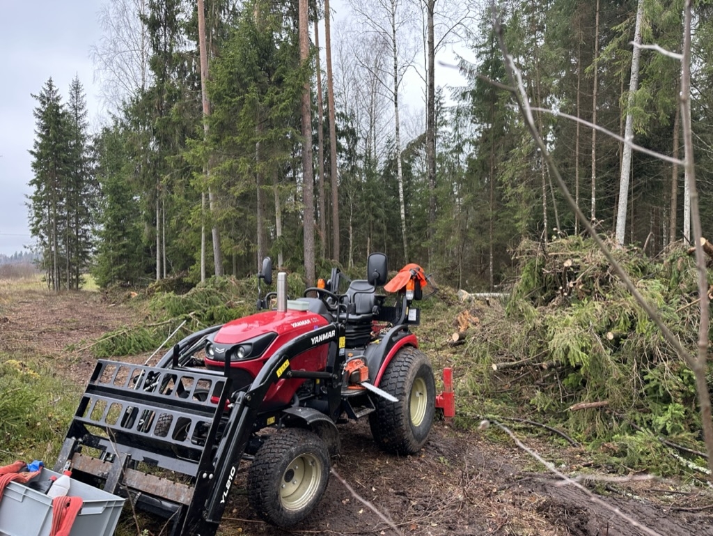

Still struggling with my windfall
As you can see, woods are all messed up, limbs are tangled
Today made a lot of winching and pulling with crane
Still managed to load 2 vagons

Enough with show-off :) Time to ask advice
About that vintage winch I have (pic is 1 page back). It works like all winches of that type, so I guess, construction is the same. To engage it we pull the rope. More we pull more power we have on cable
It is a kinda heavy, kids (10 y/o) almost cant operate it. For me too it seems kinda hard - to make full pull I have to put all my weight into action
Is it possible to adjust coupling ? Or should I replace friction pads ? Or just longer lever will do the job ? :)

Is it a drum winch (accumulates the rope by winding it up on a drum) or a capstan winch? If it's a capstan winch and you're having to put more muscle into it, perhaps loop the rope around the capstan one more time so it has more grip.
   / Tractors and wood! Show your pics #22,616
It's drum
By "pulling rope" I meant pulling rope which is connected to lever which engages clutch

its hard to see on the picture but I am sure there be a way to change the lever configuration to create a mechanical advantage.

I have a Farmi winch. I do have to pull hard on the rope for a very hard winch pull. I would check the clutch adjustment first. Pull the rope and watch the lever. If the lever moves up more than an inch or so before the winch starts to pull on a smallish log the clutch could use some adjustment. You want the lever to be at 90 degrees to the rope when you are pulling very hard for maximum leverage but you have to make sure that you have about an 1" (25 mm) of free travel before the clutch engages.
Also there could be oil on the friction plates from oiling the chain and or cable. Use may help but the friction pads will probably need replacing.
You get more pull with an empty drum. So if you don't need a long cable run with a shorter one and the same pull on the rope will give you more pull on the cable.
Making the rope lever longer or adding an other rope pulley would work too.
Personally I think that the users strength is a safety factor. The users strength or size limits the size log. A winch is not a toy for kids.

Thanks for your inputs.
If I has to put all my 220 lbs to pull 15 m (50 ft) @ 50 cm (20 in) clean log, that's not normal. Kids can work only with pulp wood - 3 m (10 ft), rather small D
Have found manual. Couldnt imagine there is so big difference
Pulling capacity on first layer :
5510 lbs ( 2500 kp)
Pulling capacity on last layer :
2700 lbs (1225 kp)
Partly agree for kids.
As I am saying to my wife - laying on coach in from of TV is much more dangerous than working in forests
+ they are working ONLY under my or wife's guidance
But other that that - winches are made for small people to move big things ;)
