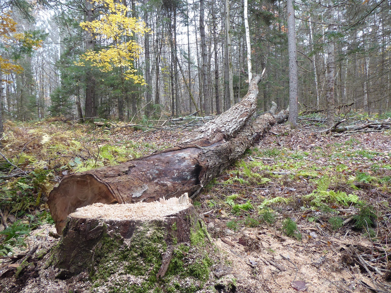

I had a 2' dead maple that has been dropping branches on one of my tractor trails all summer. I decided to cut it and turn it into firewood. When the top hit the ground it shattered and there were broken branches scattered everywhere. Here it is after I cleaned up so that I could see what I was doing.

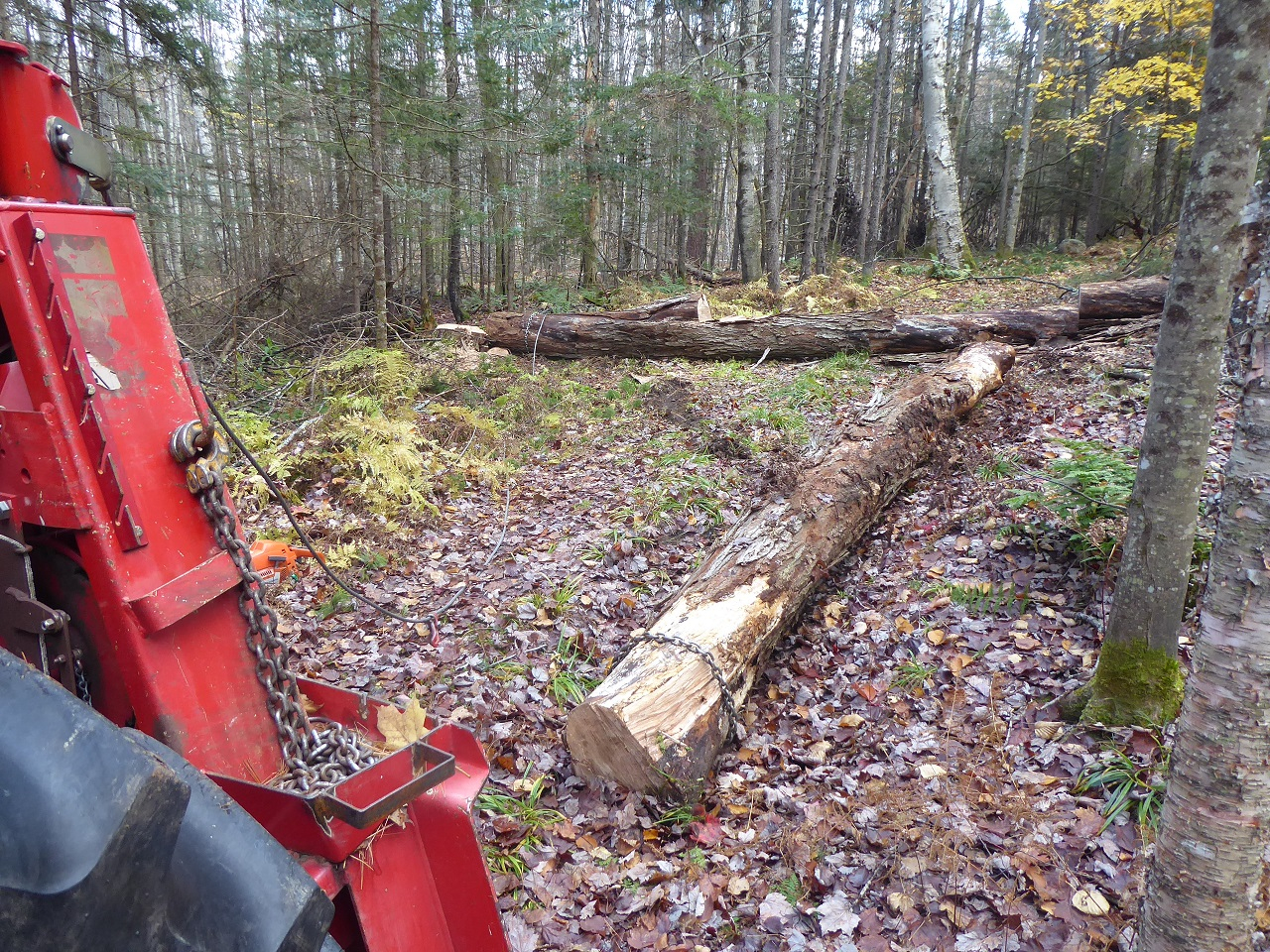

I cut my firewood 18" long so I cut two 21' logs from the bottom part of the tree for the first hitch.

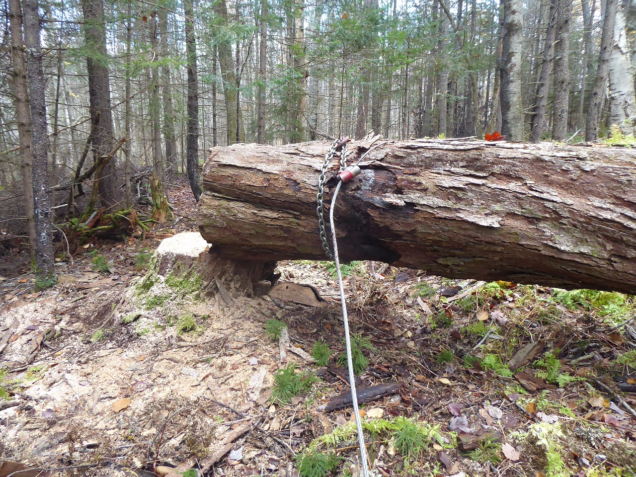

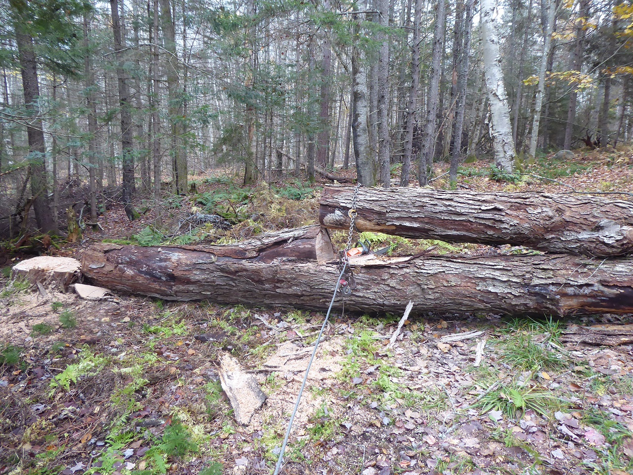

The butt log was hiding behind the stump. Rather than just yank on it and hope for the best, or skid it from the top end which pulls much harder with a heavy log, I put the choker hook as low as I could on the back side of the log and brought the cable over the top in an attempt to make it roll up over the stump.
Worked like a charm - a 180* roll and the log climbed right up and was sitting on top of the stump.

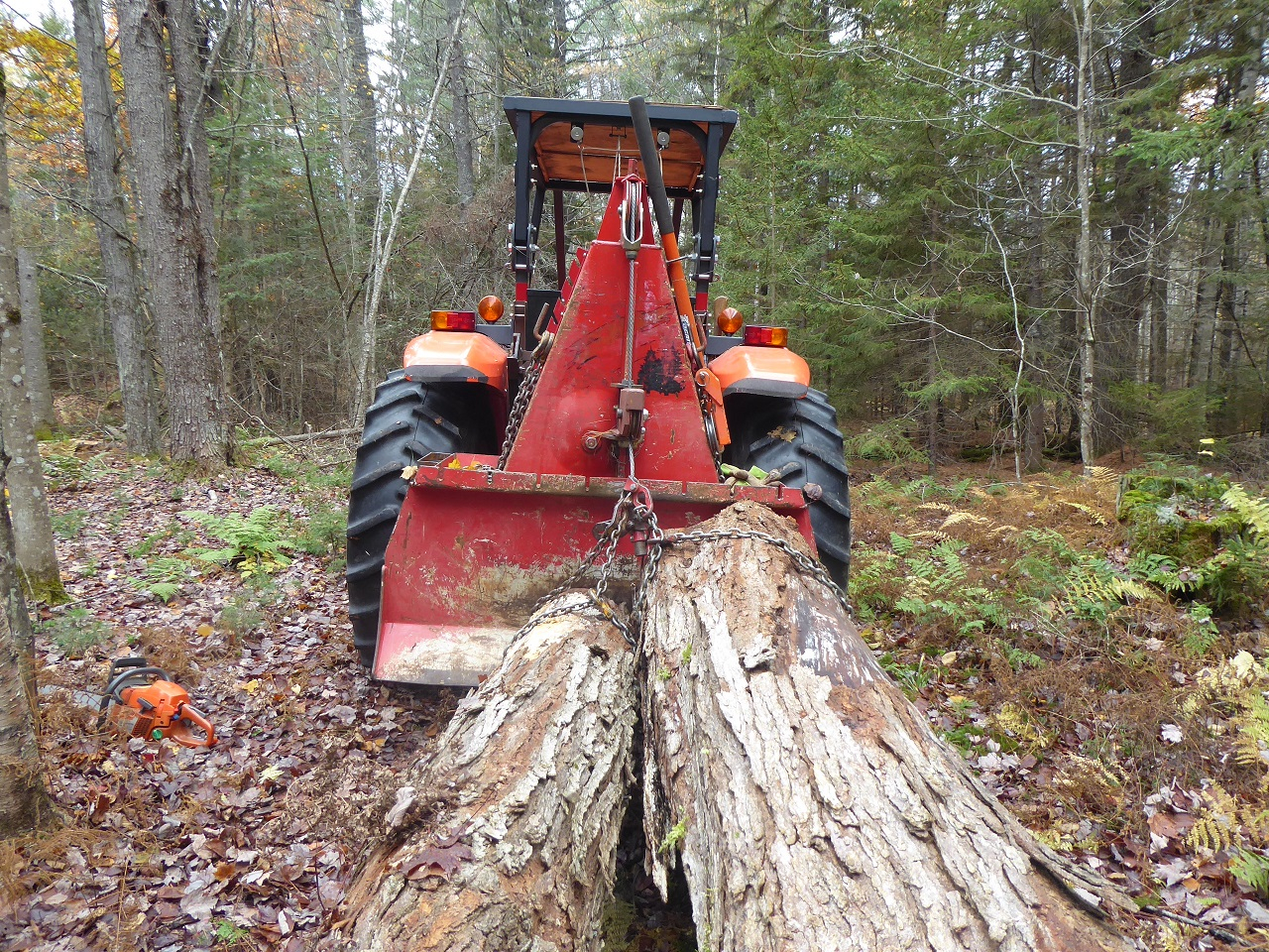

Just need to pick up the saw and ready to head out.

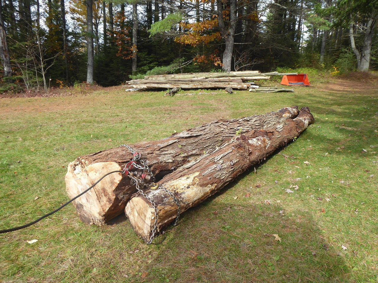

At the landing. They're not pretty but they should burn OK.
