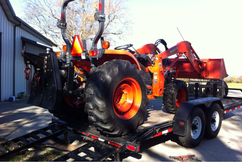

Loading the L3830 for storm damage clean-up. Note my custom skidding hitch on the back! (0:

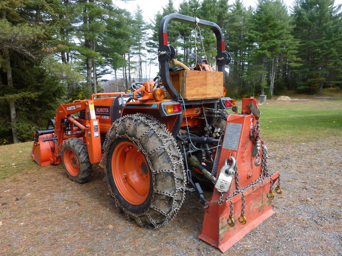

I have a loop on the end of the clutch rope. I run my thumb thru the top of the loop then grab the rope with a closed fist. That way the rope doesn't slip thru my gloves or mitts. I have to pull on the rope pretty good on a hard winch. In the video I was just holding the rope up so you could see it. Probably the two finger grip was so my little pinkies wouldn't get cold holding a snowy rope bare handed. :)
One thing about the type chains I have is that they come down on the sidewalls in good shape. That has to help keep them straight.

Sounds like your winch operates like mine, I thought maybe your Farmi winch might have better rope pulley linkage that could give more rope fulcrum.
Nice pic. of the your tractor, I wasn't shown that model, L3010DT in 07 when I bought my L3400DT, they showed me the L2800, a little less$$. Your tractor looks like the same size as mine. My talon chains are straight when I first get them on, then 1 trip in the woods, and there crooked, I must be putting them on to tight. Show a pic of the front, I want to get a better look at that tree grabber on your bucket.

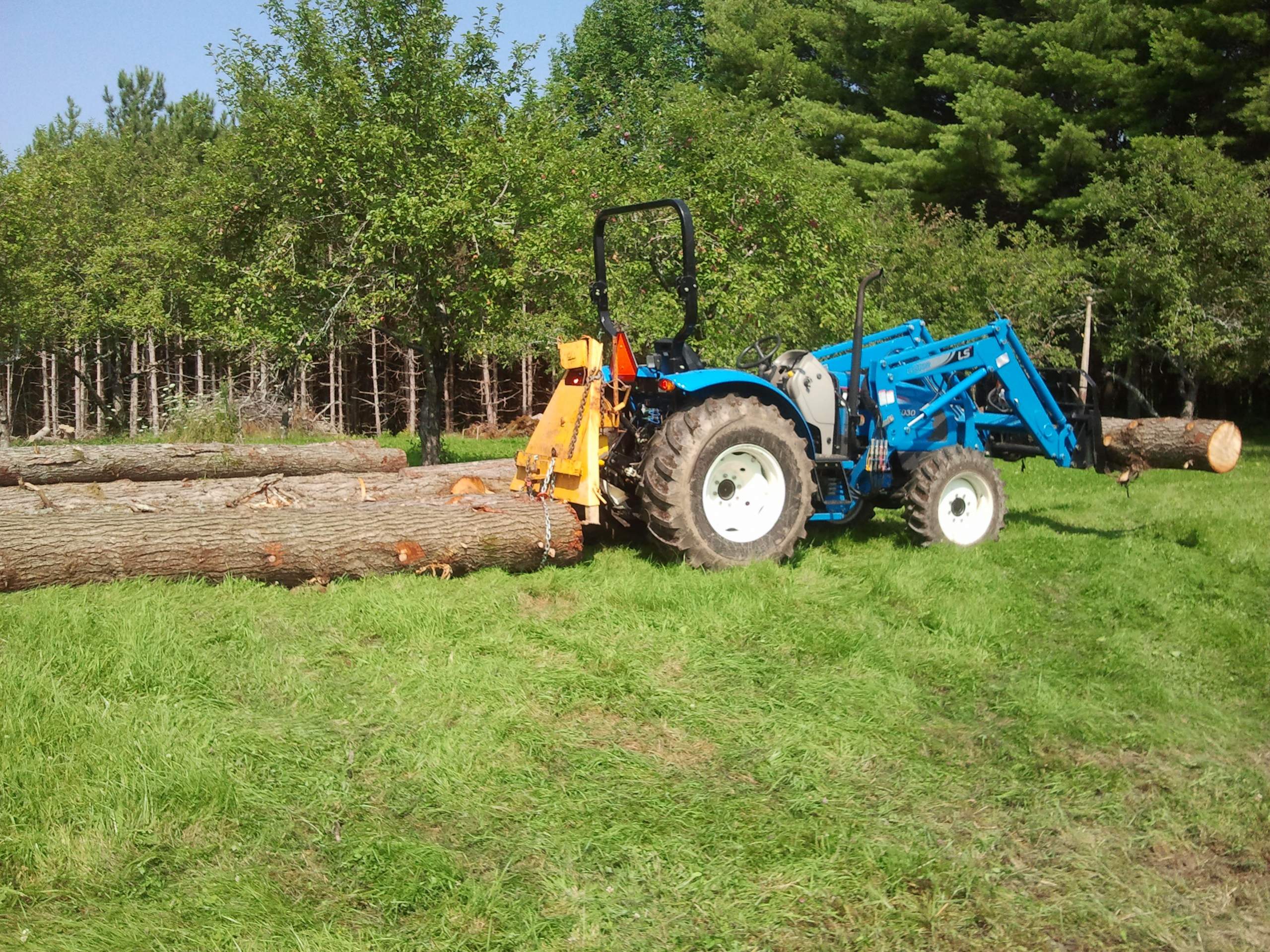

I thought I had put these on here before, but if you insist:
Those are pretty good size logs, looks like hemlock, and one log on the bucket, must be for ballast, my woods road ain't that wide. You must of hauled these out to build something, probably all built by now. I sawed a lot of it into lumber the past couple years, and now I'm putting the tops and some but cuts that didn't make a log into shingles, and on my garage
Can you tell us some more about that? It looks nice, like a cross between a winch, and the way a log grapple carries the log.

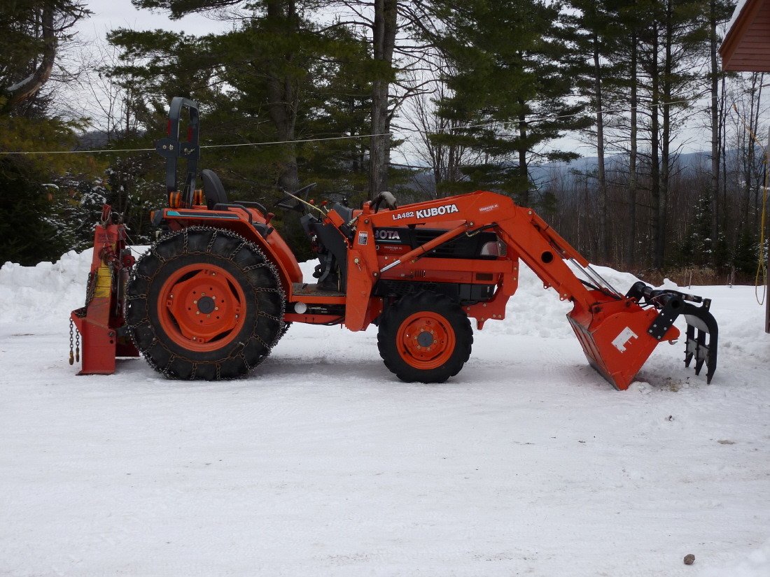

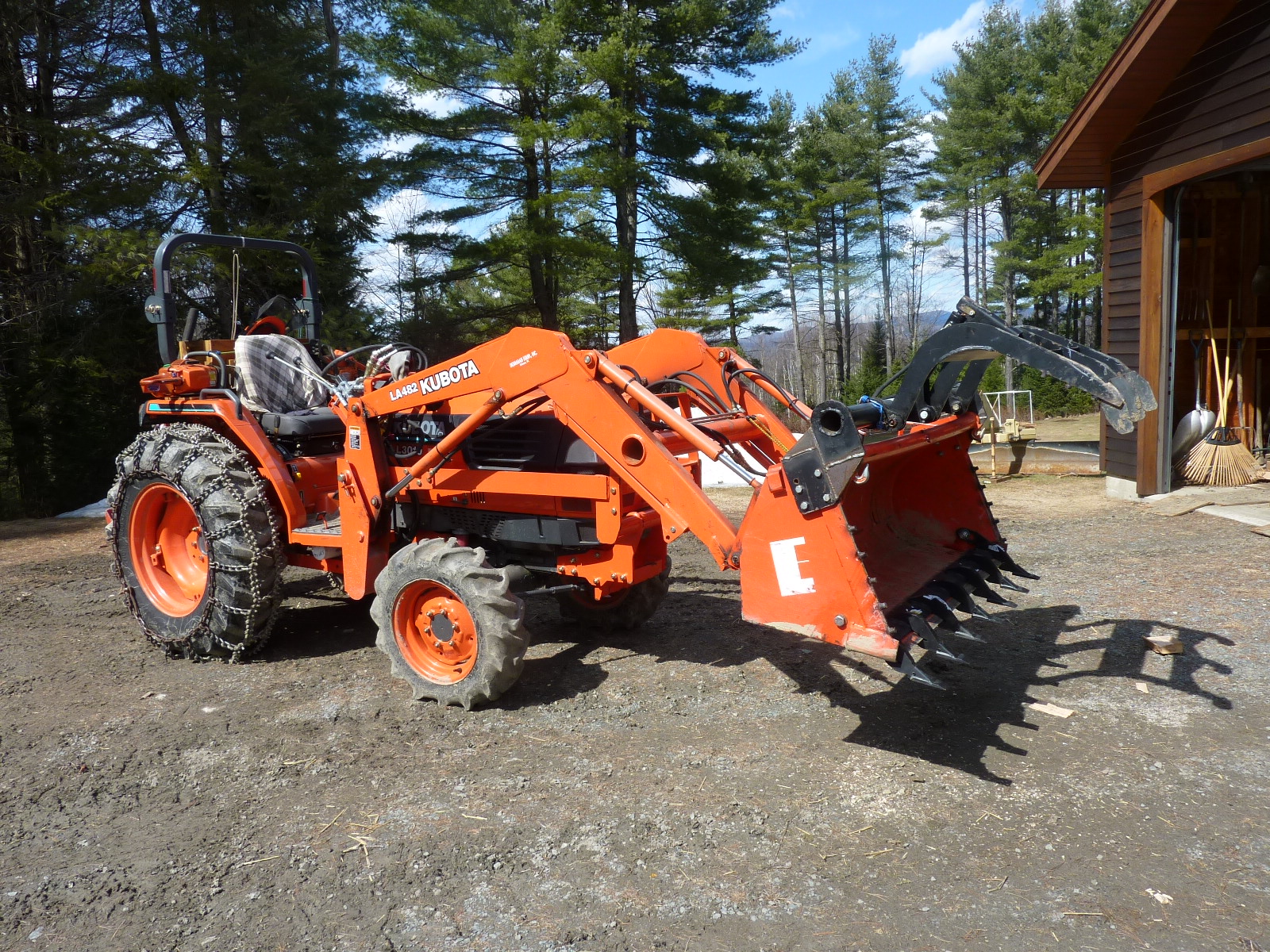

My grapple evolved over the years as I improved it. Started with this ATI bucket grapple with added teeth
Then I adjusted the position of the hinge forward, added some curve to the tines, and added more teeth to the bucket edge
Last spring I added a tooth bar. I don't think I can make it much better now.

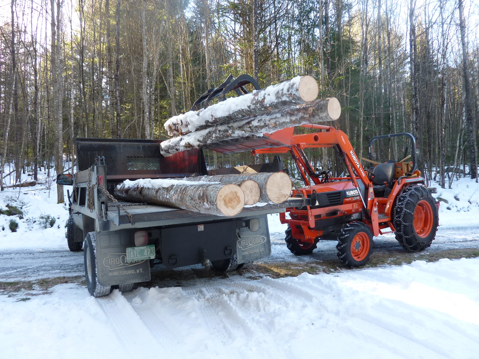

This one is from 2 weeks ago before all the warm weather. Loading fir headed for the saw mill.

Nice pictures Gordon, the grapple looks to set up perfectly.
Yes, hemlock. The pic is from September I think(?) over at my neighbor's place. They cut some hemlock for our snowmobile club to have milled up into planking for bridges. We needed 8' planks, so they cut about half the logs into 8' lengths before I told them to stop. They thought there was no way a tractor could haul them out full length. The one in the bucket is one of those 8 footers.
Love the old winch, but the hitch bar is too low. You can see those big butts are barely off the ground.
