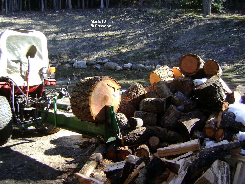

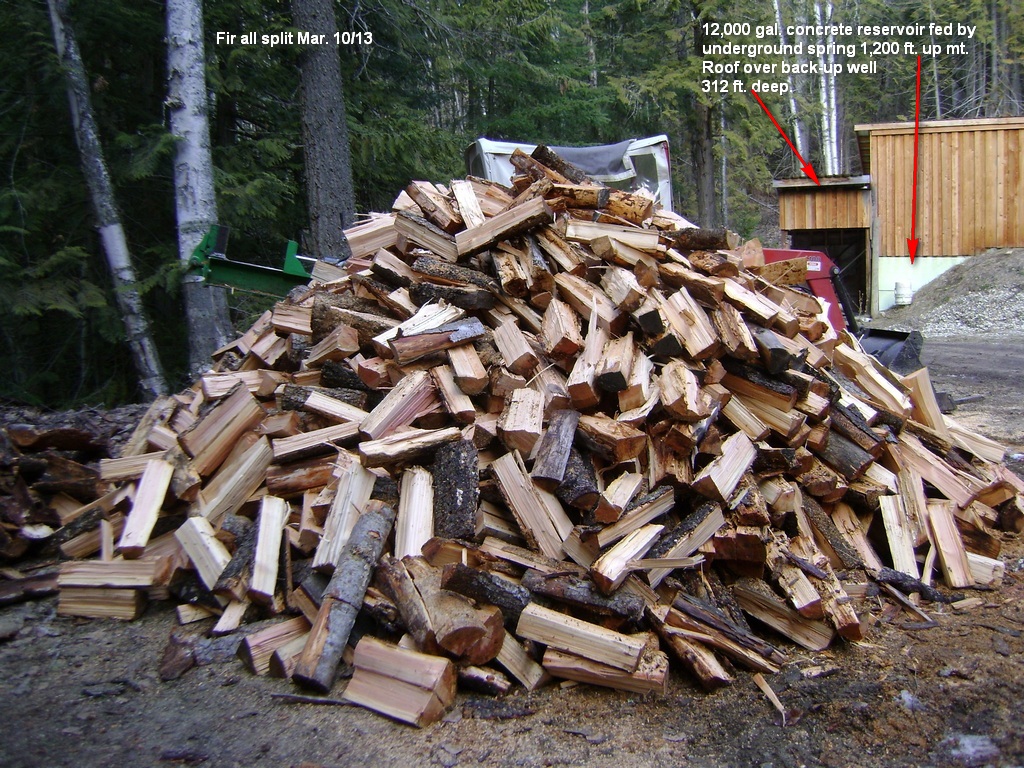

There sure are some nice set ups here to look at & get ideas.I have a small band mill and been using my tractor to skid, pile logs & split fire wood since 1991.

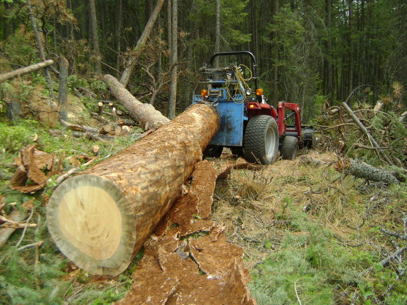

That looks like a very nice grapple unit. You are just teasing us with a couple pics, What can you tell us about operating it. I see you have a winch too. How do you divide the work between the two of them ?? Thanks
gg
x2! Also interested in some more pictures (great quality pics by the way) and some thoughts/experience on how you choose between either the winch or the grapple.
Is the log your pulling in the second pic about the limit of the tractor/grapple?
Can you carry multiple logs at once?
I've waffled back and forth for a long time on going with a winch vs. grapple for the woods work, although it sure seems like there is a time and place for both tools.

My time as a logger precluded using the grapple type skidders almost everyone has now as opposed to the cable line skidders I worked with. If I can enlarge the scale, some things might be applicable to the smaller tractor skidders and again some may not. From guys I talk with now that transitioned into grapples, I get mixed reviews. Youngins who know of no other, don't seem to mind them calling them maneuverable and able to manipulate a hitch at will as far as picking and placing. Older guys seem to prefer the cable type with the biggest advantage of dropping the load to gain better purchase and traction for the skidder, and then reeling it all back up to the skidder once that has been accomplished. Where an aspect might not be applicable comparing cable to grapple for smaller tractors is the ability to carry multiple stems. A skidder grapple has a pretty wide maw and as a result, can take a wide bite of stems. This may or may not present a problem with a small compact type grapple depending on the diameter of the stems or the size of the grapple. One of the largest advantages of the grapple is not having a guy or the driver having to unmount to relieve chokers on the landing. Other complaints of the skidder grapple is of dropping stems that might not have pressure against them with an errant bite of the grapple on a larger hitch. For a home owner? I guess it all depends on how a guy logs his property or how long a return might be if one cannot grab multiple stems. Sure might be handy not to have to dismount to unhitch on short skids.

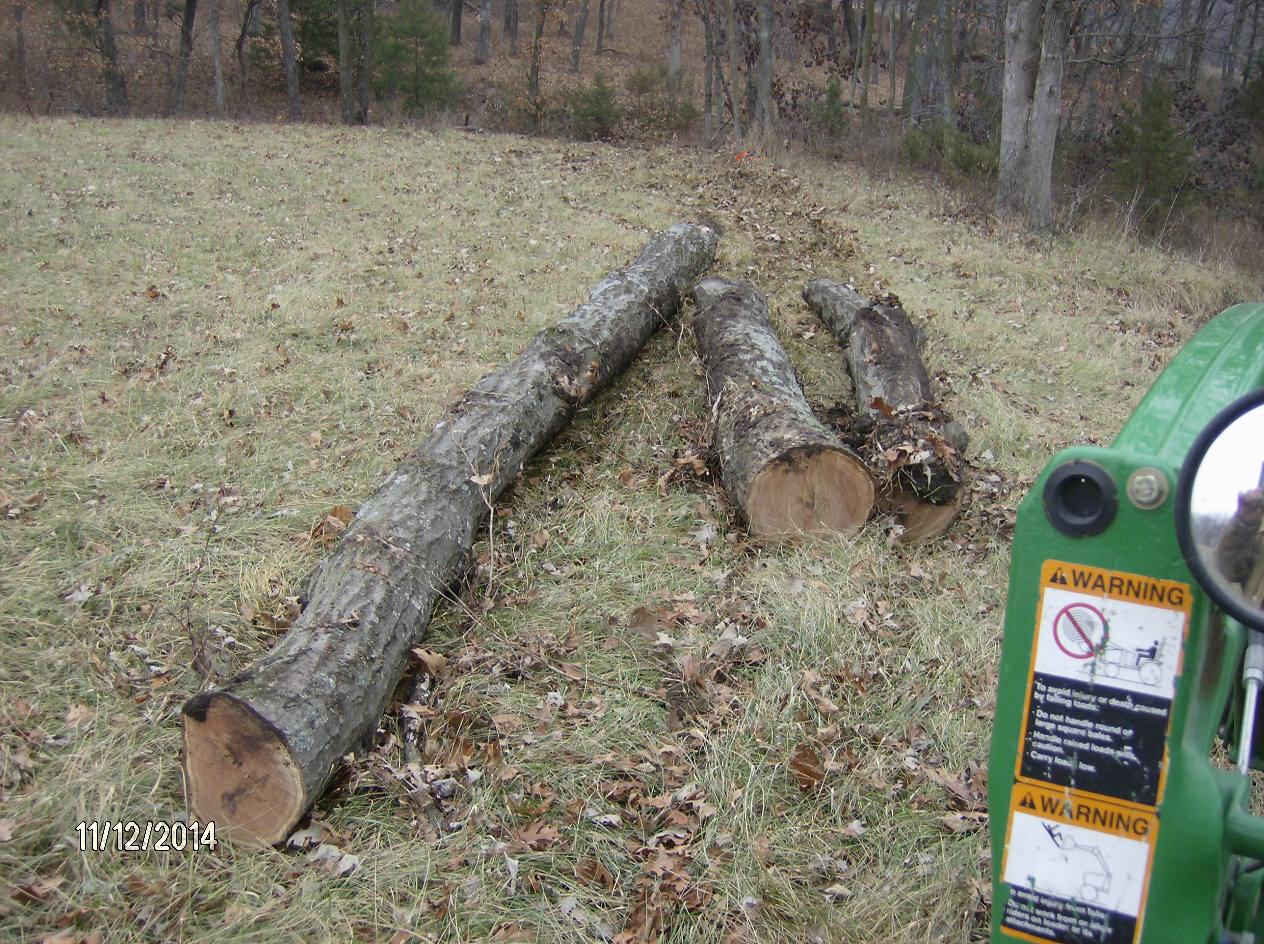

I used the 790 to pull these two (yes there are two) logs out of the ditch yesterday: HPIM3281.JPG 18" x 30' Red Oak, had to cut the second one in half to get it out of the ditch: HPIM3282.JPG Where they crossed the ditch, they were over my head, the second one fell into the bottom & was in a bind because of the length. They're out where I can get to them with the pickup & trailer now!
