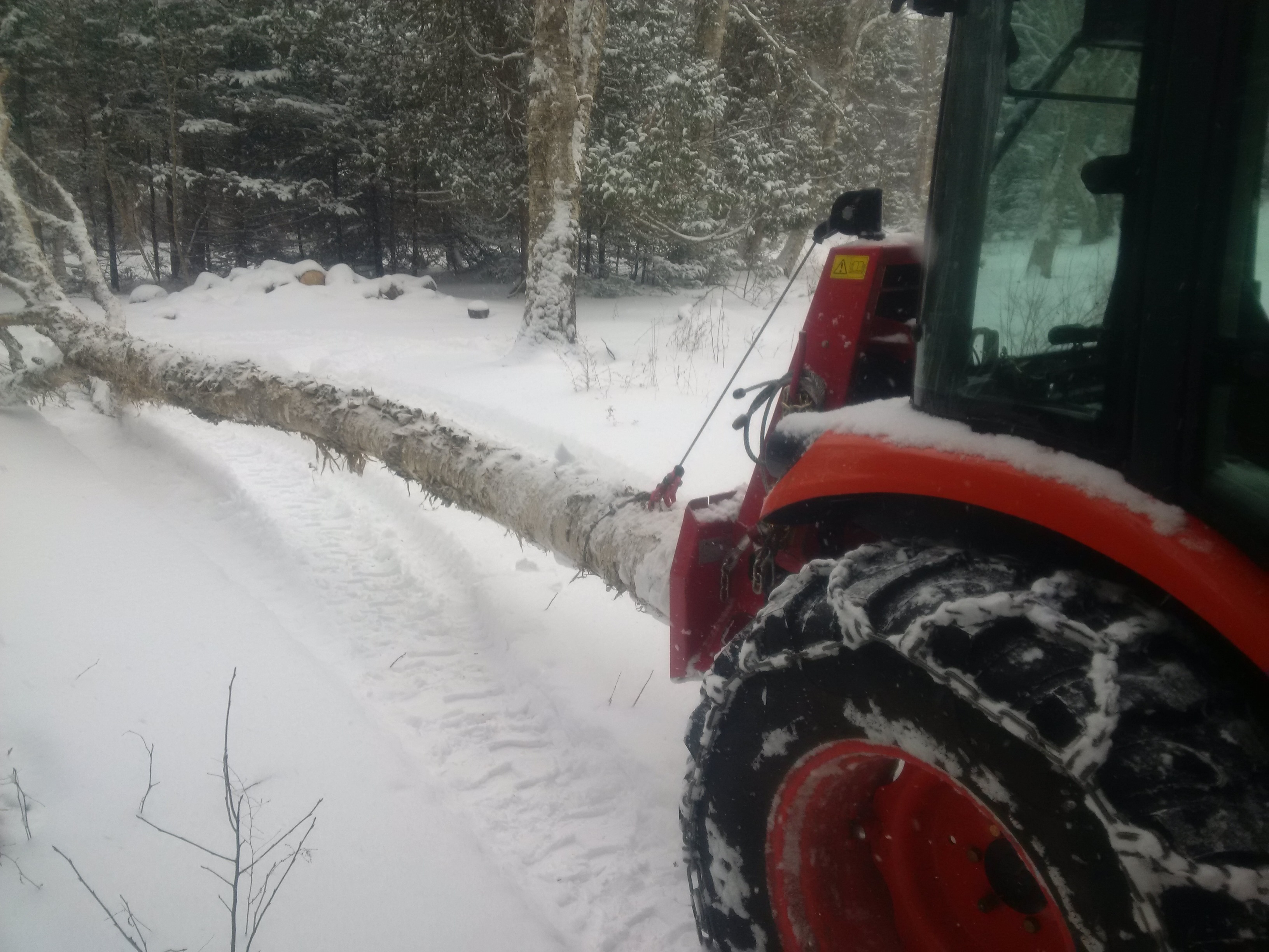

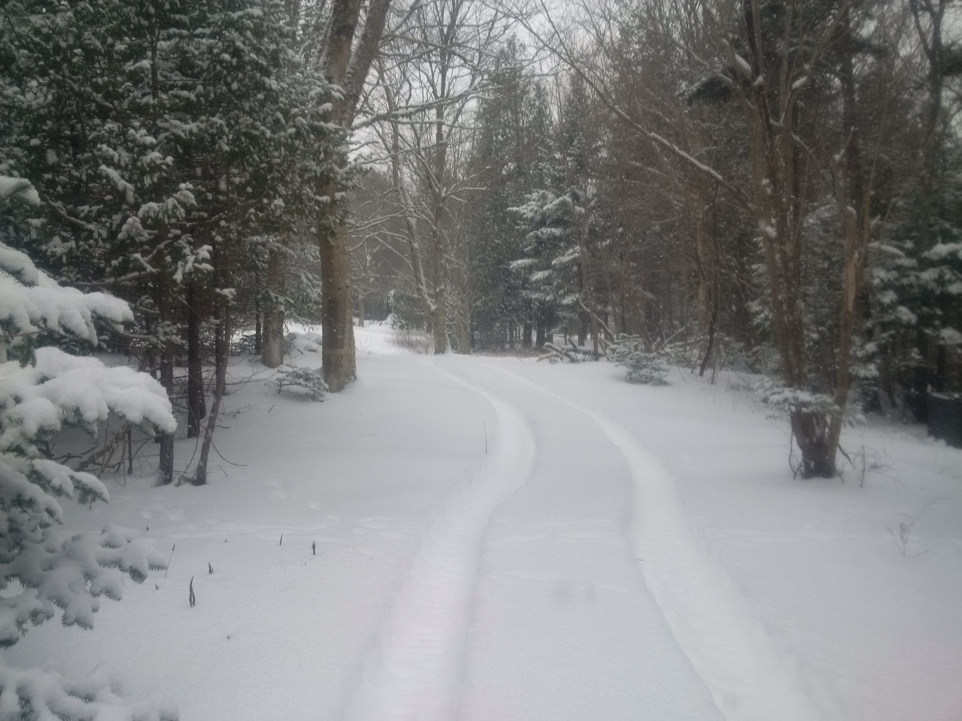

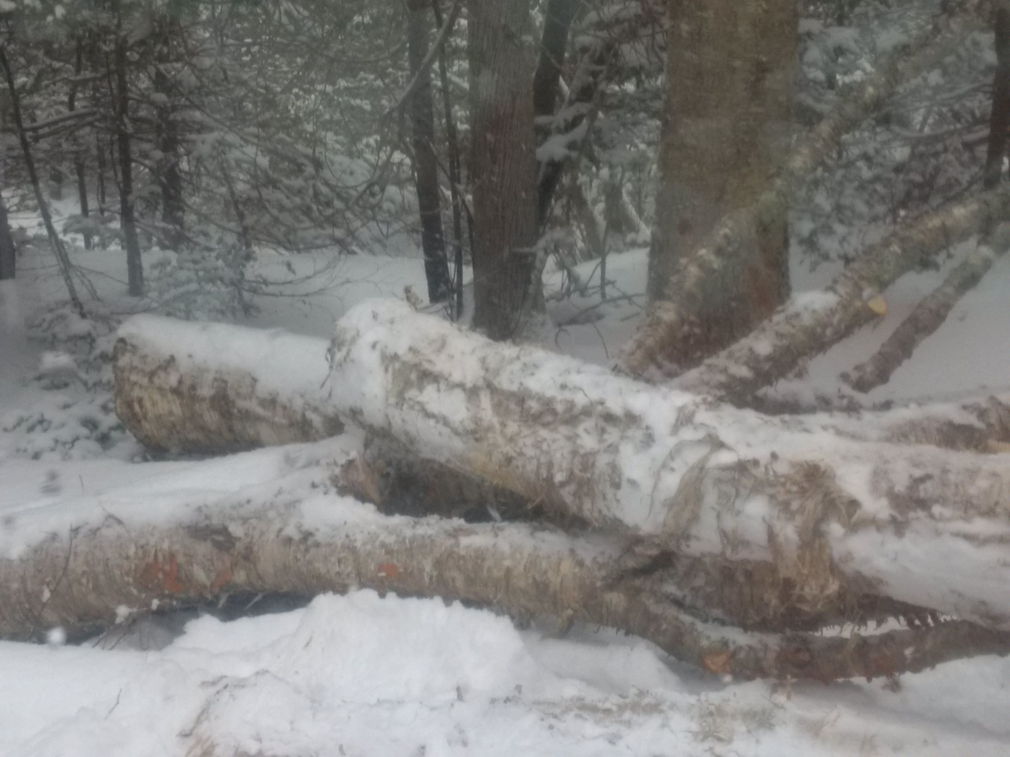

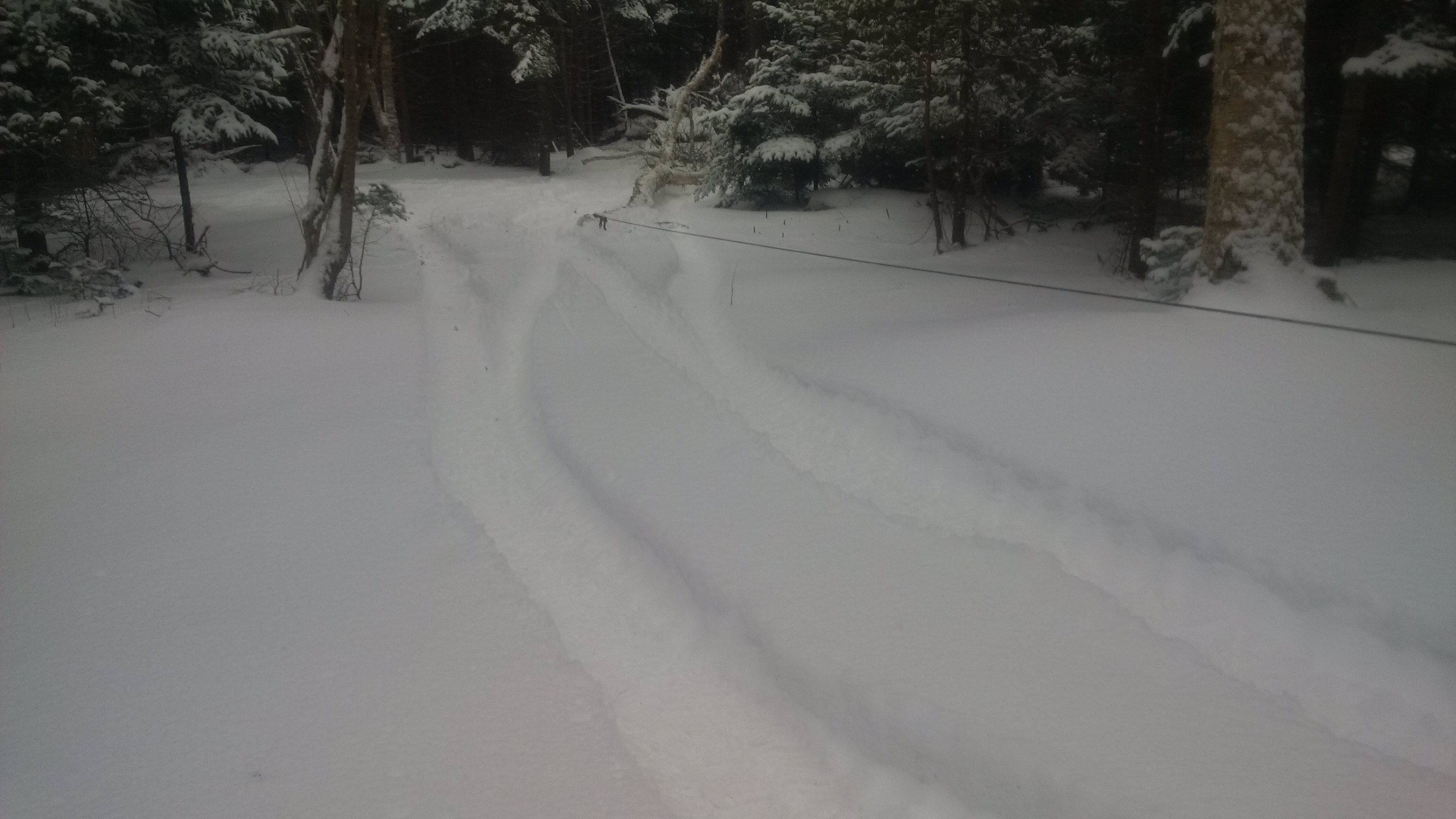

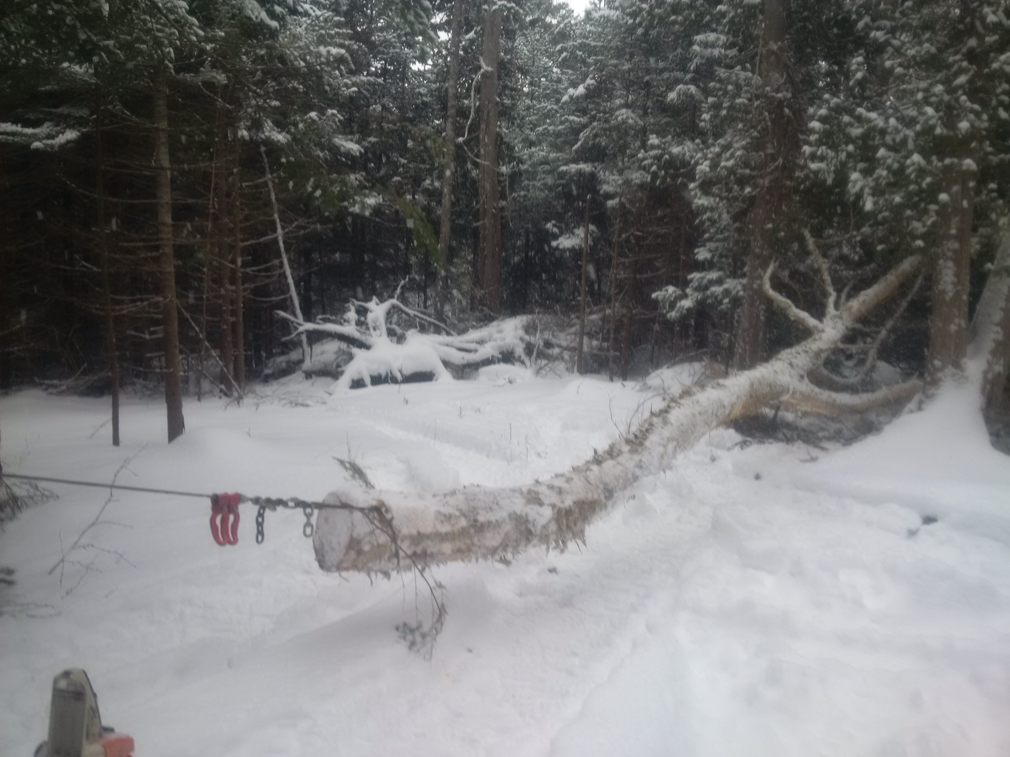

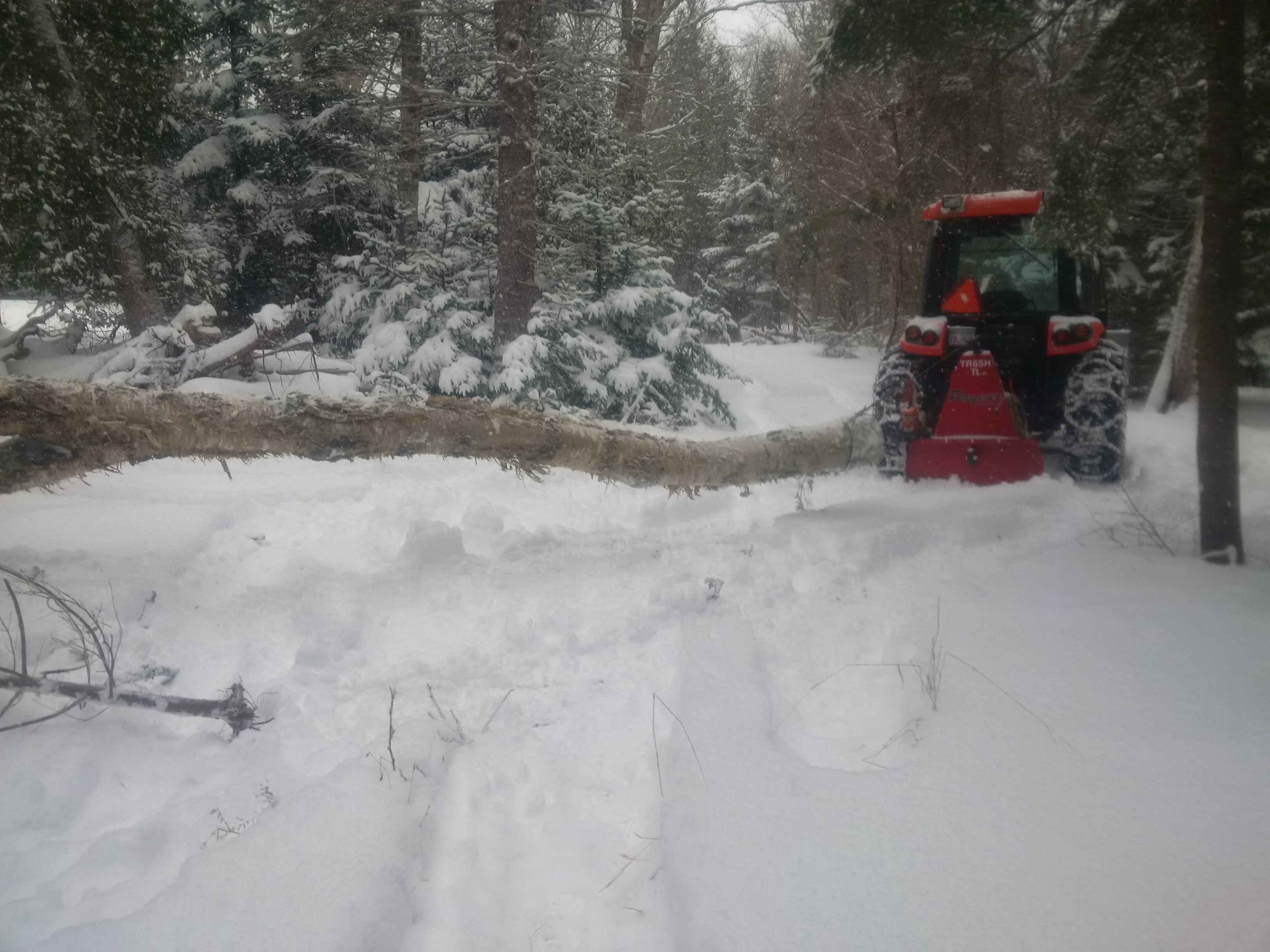

A week ago. We have had two more dumps of snow since then. 2.5 to 3 feet total.
IMG_20170211_153313.jpgIMG_20170211_153325.jpgIMG_20170211_153423.jpgIMG_20170211_155840.jpgIMG_20170211_161013.jpgIMG_20170211_162321.jpg

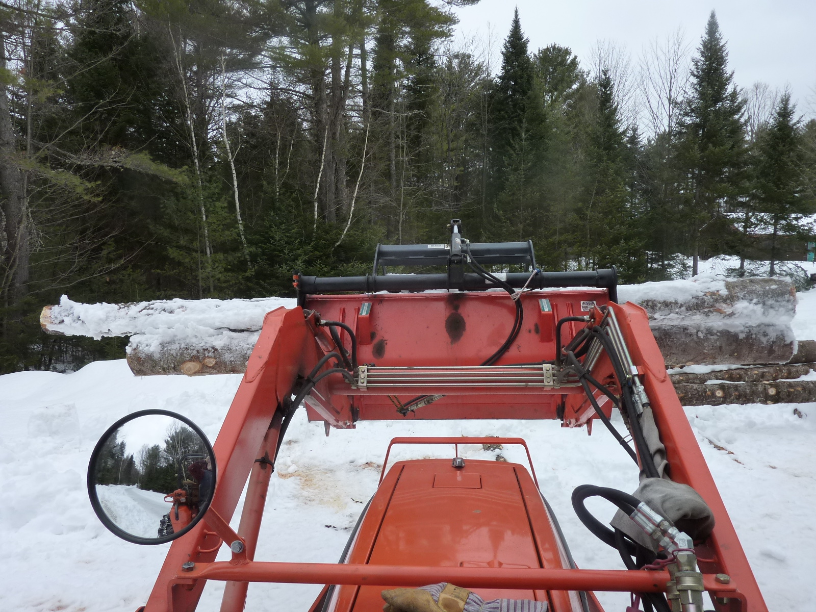

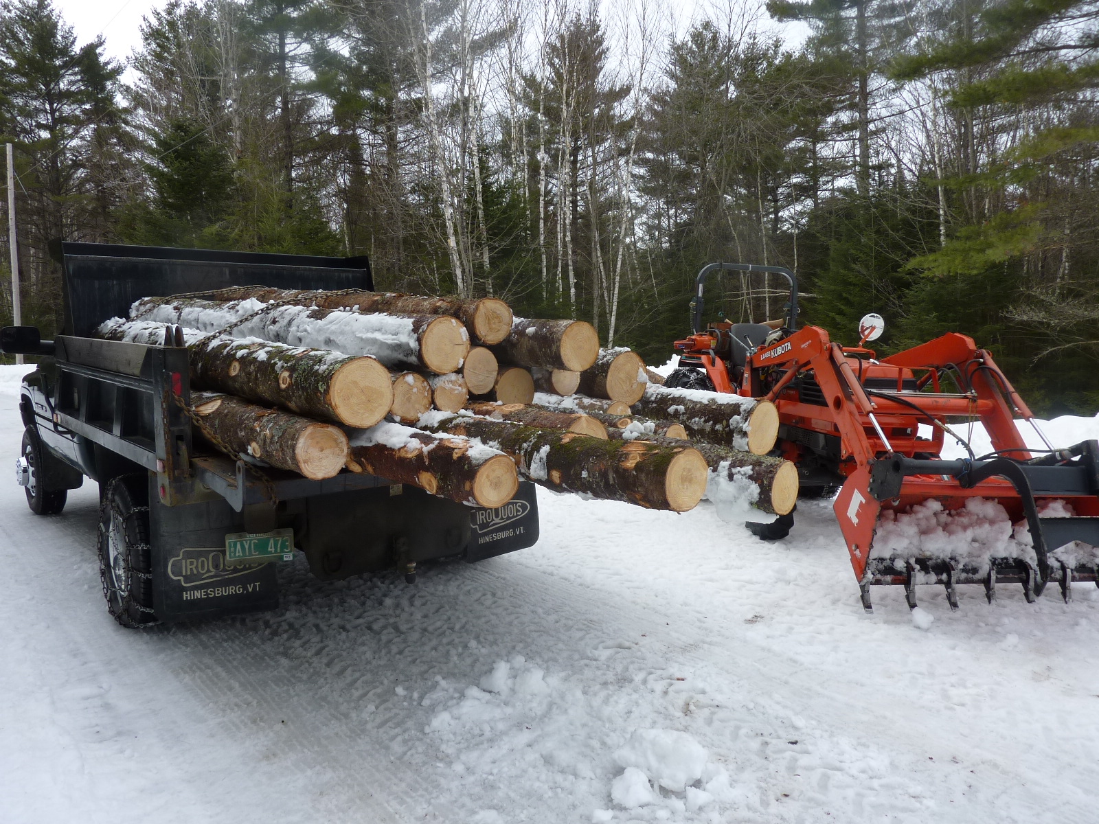

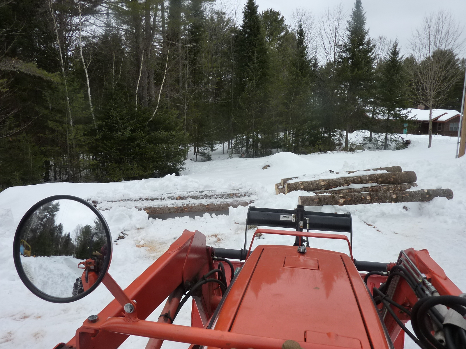

This morning was probably my last trip to the saw mill for a while. We have plenty of snow and ice but it is 50* this afternoon and the roads and trails are falling apart fast. Nothing but warm weather forecast for the next 10 days with a big rain this weekend. So unless winter comes back I am done until the end of mud season.
My half buried log pile.
Grabbing a 12 and 14 footer together
Not a big load but I thought I better get rid of it while I can. The mill yard can get muddy and they shut off.
