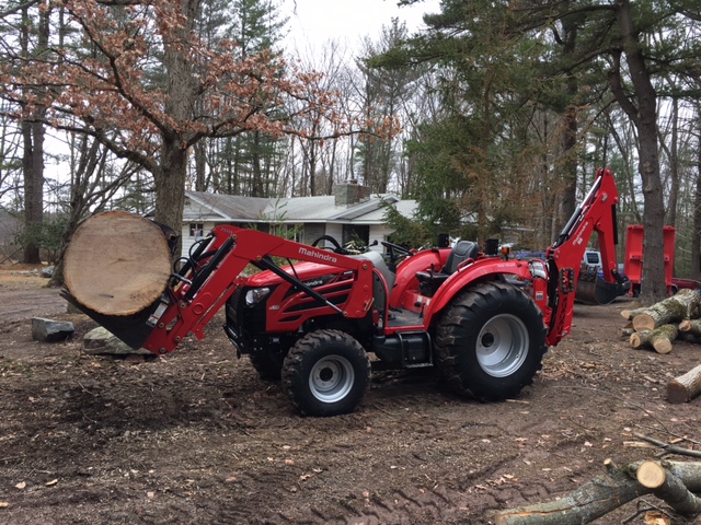

Here's a couple pictures of my old Massey Ferguson. Haven't taken too many pictures moving wood. However I just purchased a 70 acre woodlot, so should be lots of photo opportunities this summer. I'd really like to get a pto winch setup like some of you guys for skidding.

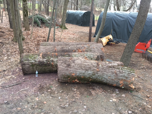

Moving some logs to an area where they can be loaded on the trailer.

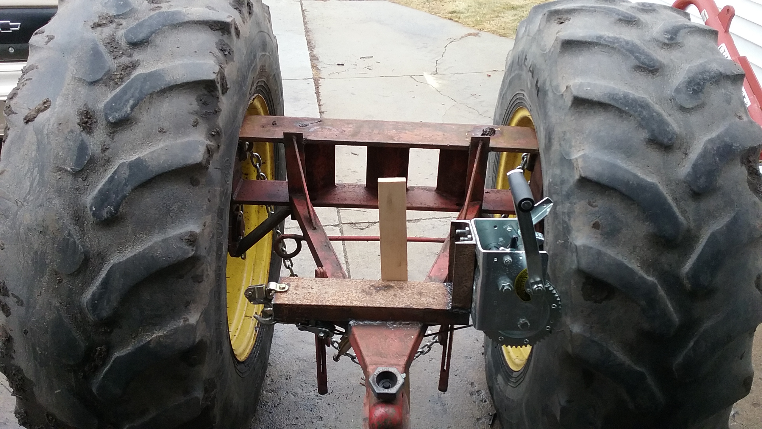

What's that tail? An old tractor rear end with a winch to lift the log? How is the winch powered?

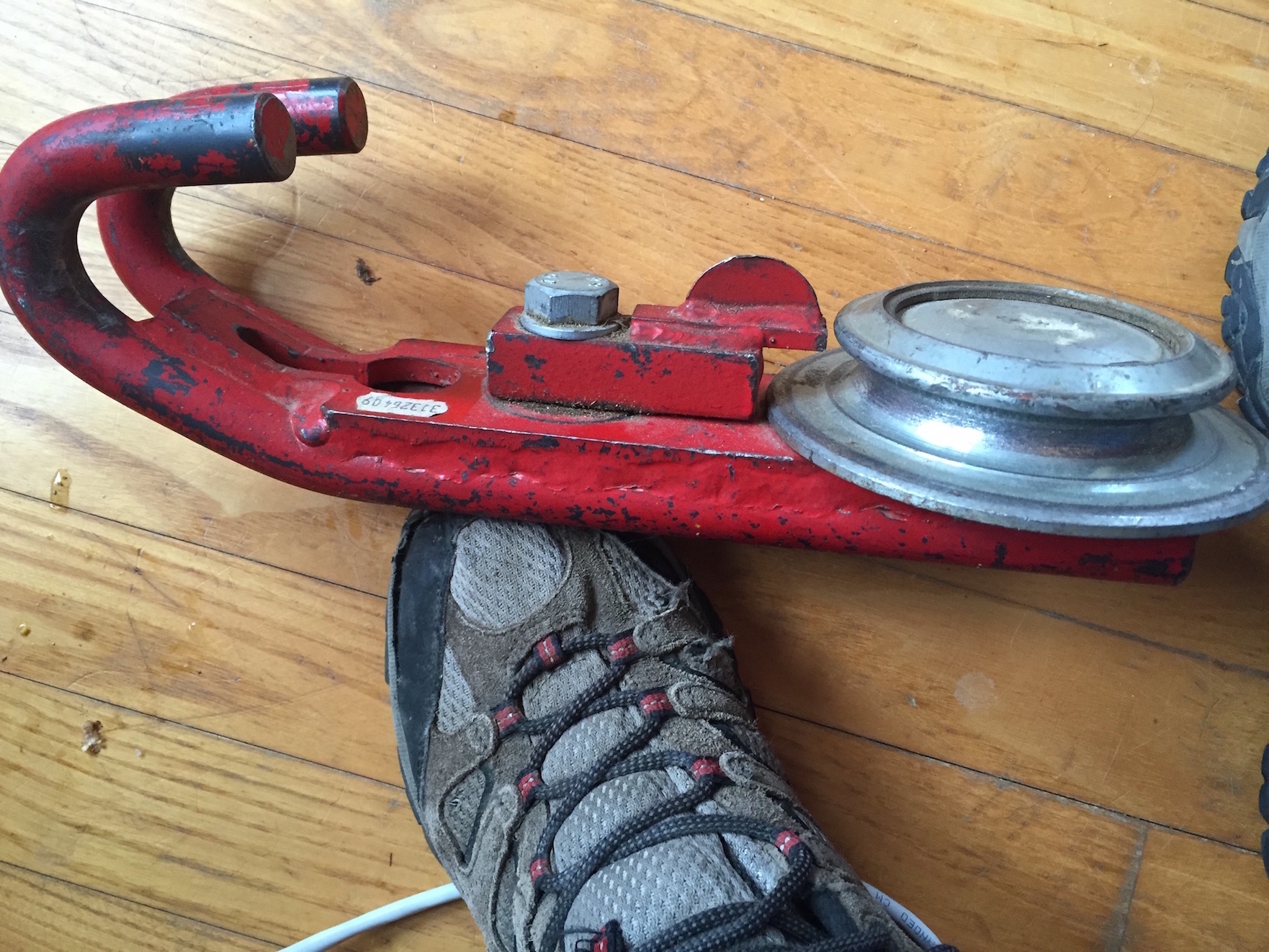

That looks like some nice ground clearance on that MF tractor, Ssrider. The winch has been a winner for me. It has really increased my reach in the woods and lowered the amount of hand labor I need to do to get to the wood. You may also find a self-releasing snatch block a valuable aid: you can pull around corners without having to walk back to release the cable from the pulley.
Here are a couple sources, and a picture of a third design.
Labonville sells this self-releasing snatch block by Igland
This picture shows one I bought from Labonville years ago. They no longer sell this design. I can't remember who the manufacturer of this one is, but it works well:
Here's another style sold by Portable Winch Specialists: US made self-releasing snatch block. I also own one of these. (It's rare I need two of them. At the time it was being sold at about half the price of competing models, and I couldn't resist.) I like it a lot, but I did have one problem with it: my 3/8" cable managed to pull down behind the pulley. It jammed so hard I had a bear of a time getting it back out (and kinked the cable). It's a great design, however, and a simple modification will avoid that problem in the future. See description in this thread: Jammed cable fix.

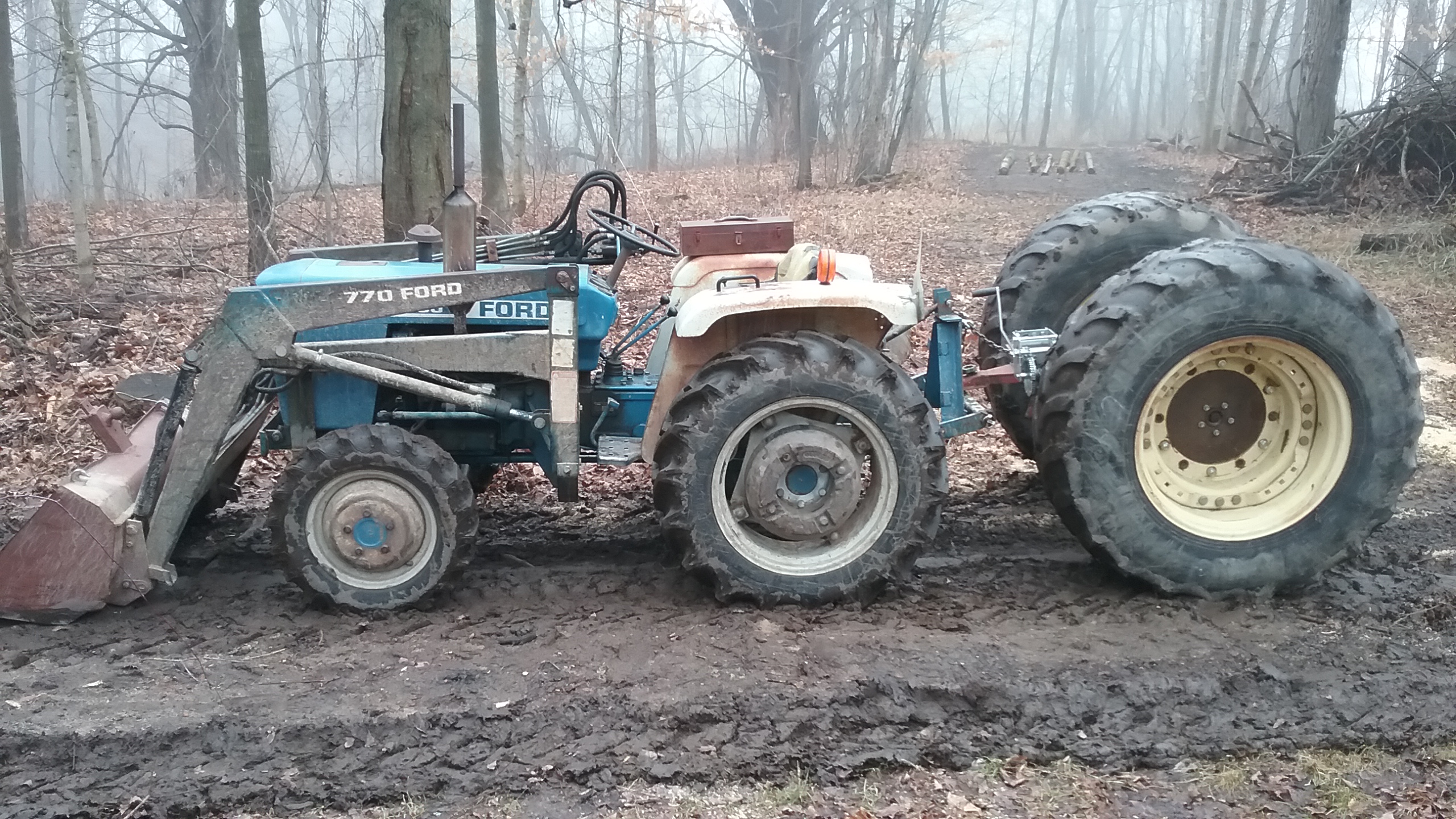

Not much wood, but I would tear up the timber if I got serious about it. I've only had the tractor for 72 hrs so far, and it's muddy and covered with horse manure when I took this wood run just for fun. The axe is kinda special too, for those that care about such things.
It's a hand winch (the only new bought part) mounted on a Frankenstein assembly ;) A 28" wide tractor front weight bracket (auction) serves as the cross piece. It's mounted to the tire/wheel units (same auction) by jeep grand cherokee front wheel bearings, axle stubs, & some custom made adapters. It hooks to the 3 pt. via old style bumper pull car towing hitch (garage sale) to move it into position.
That's slick right there. Like it.

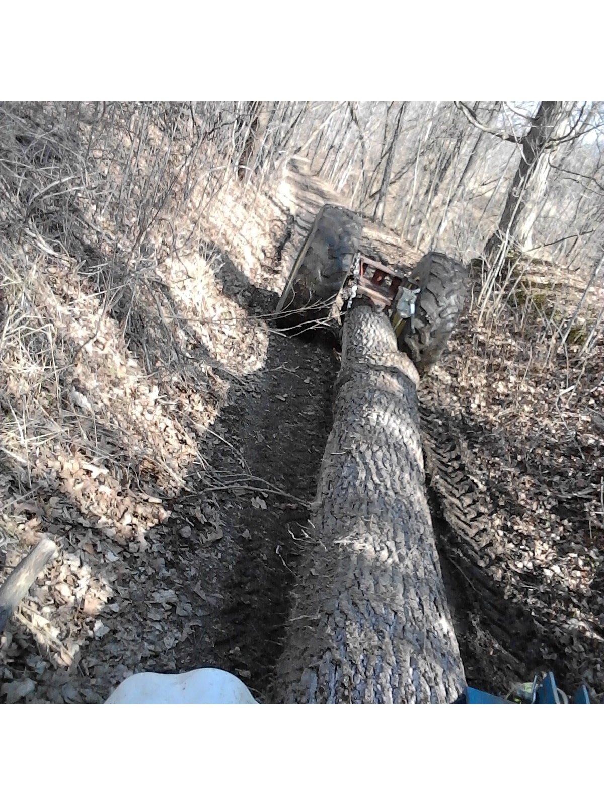

How does the tractor do pulling a load like that?
That log was ~2100 lbs. The log mover is probably another 750 (tires/wheels are 300# each). The little ford moves them, not fast though in range 2 low gear @ 1500~2000 RPM. The front got a little light when pulling the log mover wheels through some thick mud. With one hand playing the throttle and the other in position to dump the 3 pt not much input was going into the steering wheel at that point anyway ;)

Thanks for the comments. Here's a close up of the carrier.
And one short hitched to the tractor.
