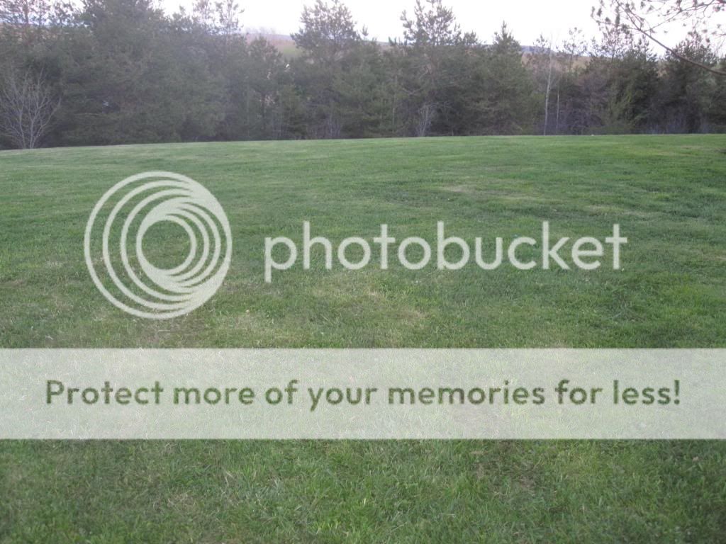

Heres some comparison shots from when I was fighting with cut quality on my BX http://www.tractorbynet.com/forums/...219707-problems-bx-fine-cut-rck54p23bx-9.html
BX pic
ZD pic. Same lawn. As you can see the ZD is much better

I personally mowed with my friends B2620 with 60" deck during the summer. It mows quite well and I was moving fast. However a lot depends on the grass. If you have very fine grass that is damp... The front tires may tend to cause tracking in the grass like shown in photos above.
My ZD mows well no matter what. However it must have the high lift blades. Without the highlight blades it will track just as badly as the B. Scooby, did you try high lift blades on your BX? That's the stock blades on the ZD deck.

How tall is the uncut grass in the BX photo? That's pretty tall grass and you didn't appear to be mowing it down very low. The ZD pic looks like the grass is much shorter.
Height of cut was around 3 to 3.5". Same height was set for both the ZD and the BX. Problem was severe striping (under the path of the tires) on the BX. Start was around 7" in both sets. A pretty heavy cut for sure. But the striping with the BX was there even when cutting 1".
In the BX pics, the "low" grass was approx the cut height setting, while the stripes were a few inches higher. The BX deck doesnt generate enough lift to raise the pushed over grass to allow it to be cut. The ZD is much better in that regard, more lift and much less weight on the front wheels to crush the grass in the first place.
