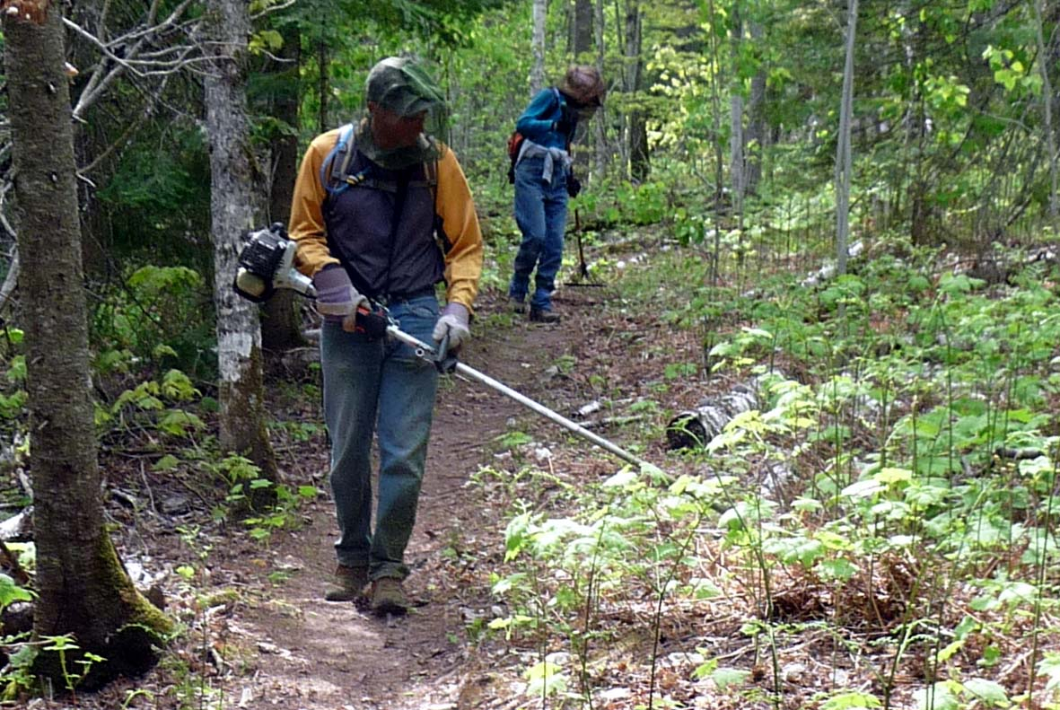

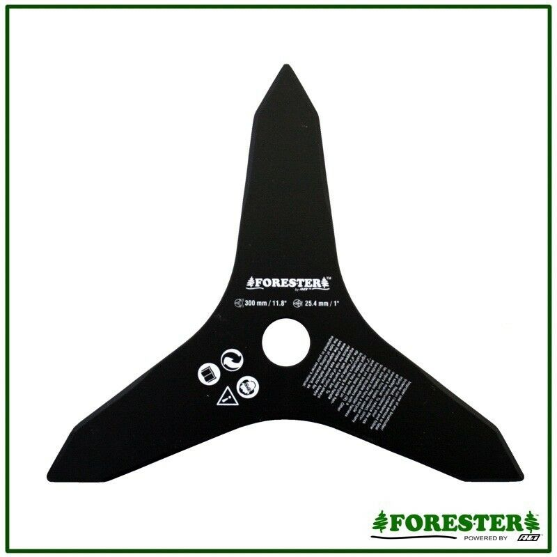

I don't take any string into the trails because I'm dealing with taller grasses, blackberries (thorns) and 3/8" face-slappers.
I found a blade like this for my Echo trimmer and it's extremely helpful. Rocks don't seem to bother it and it will take out stuff just under 1-inch. It's been great for me.
We discontinued the use of steel blades due to the rock problem. Like they are everywhere here! Plus we couldn't run them against the ground and there cutting radius is so small. Today we hope to completely swtich over to .170 string which will take out pretty large shoots and doesn't care if you have rocks or not. We have used .155 for years. This new and larger string really works well on tree shoots and if it doesn't outright cut them off, it beats the life out of them anyway.

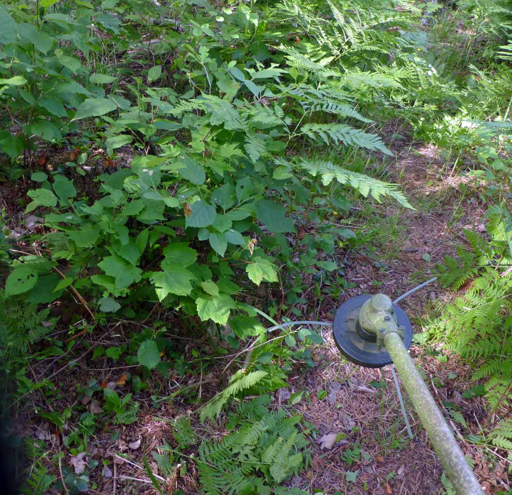

#60

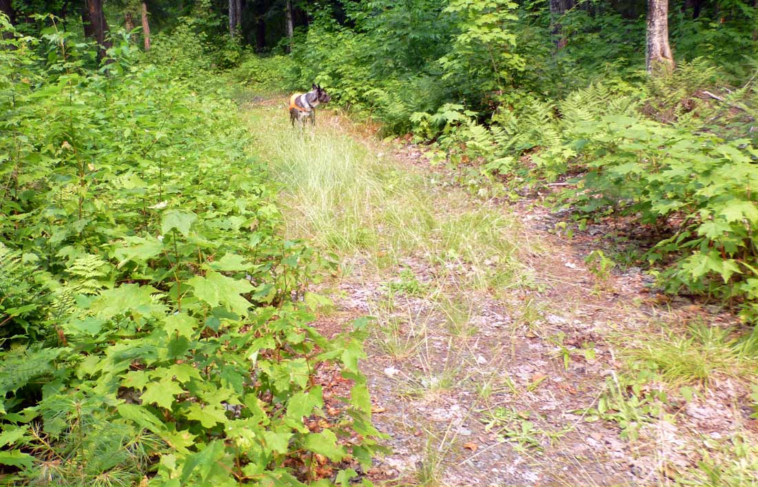

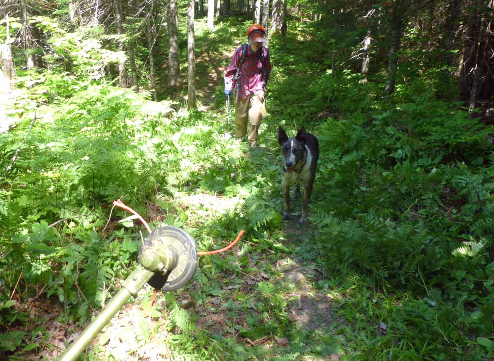

Suggestion for all people who'd like to knock down heavy weeds and tree shoots. Even bushes in some cases. Get a .155 string head for your power head. These cut much quicker and more safely, than steel blades do.
