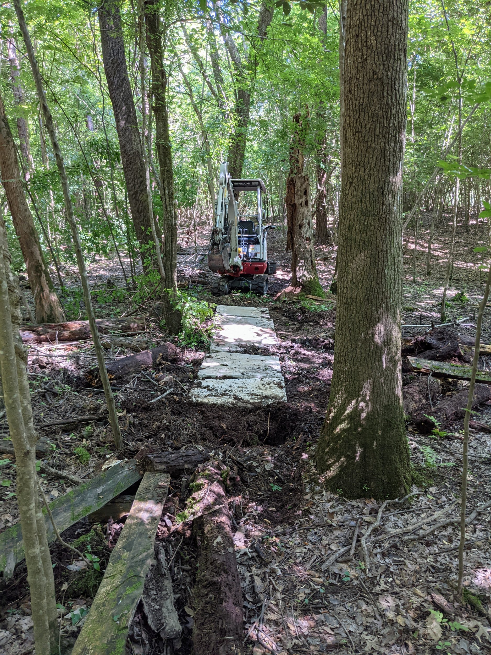

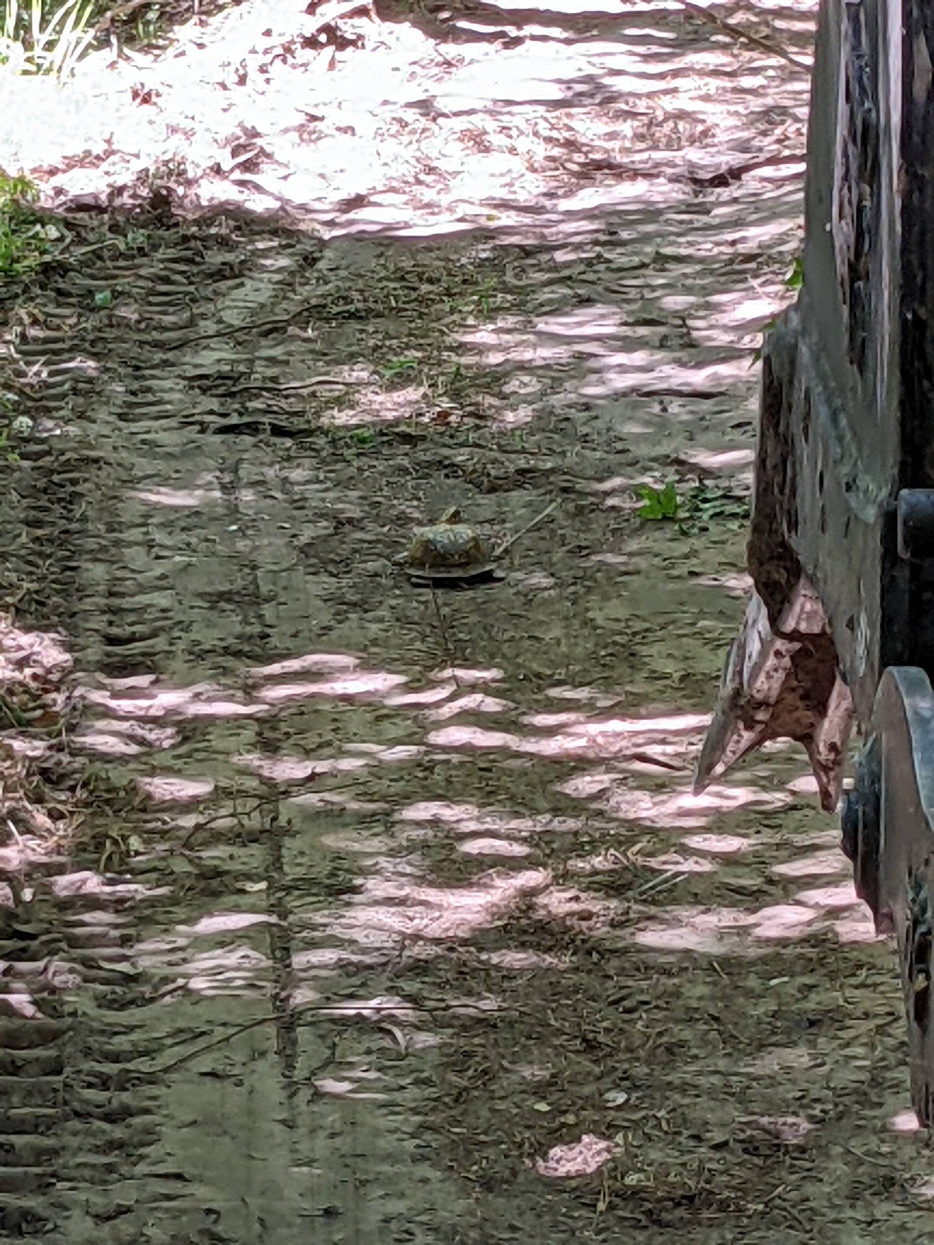

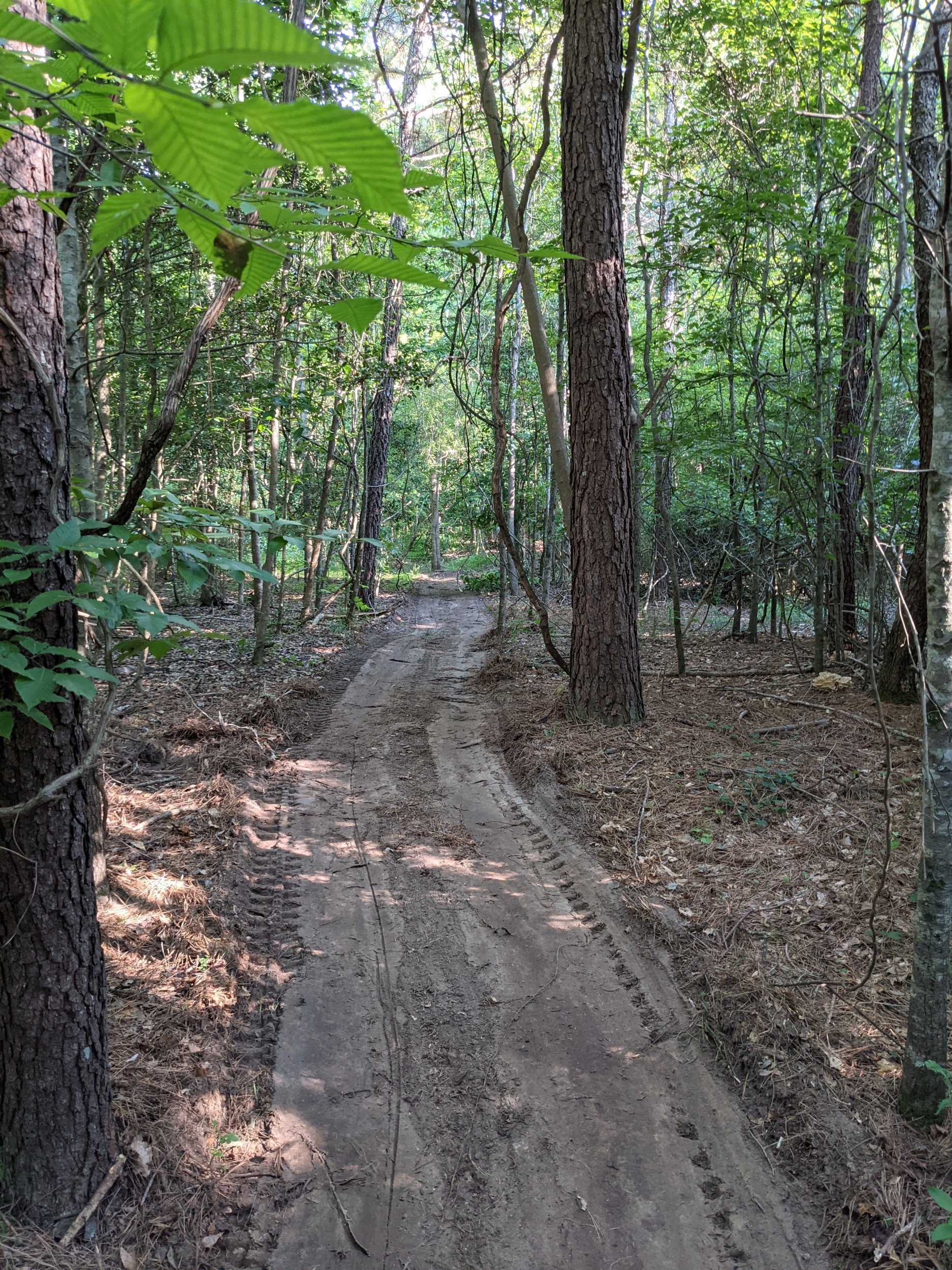

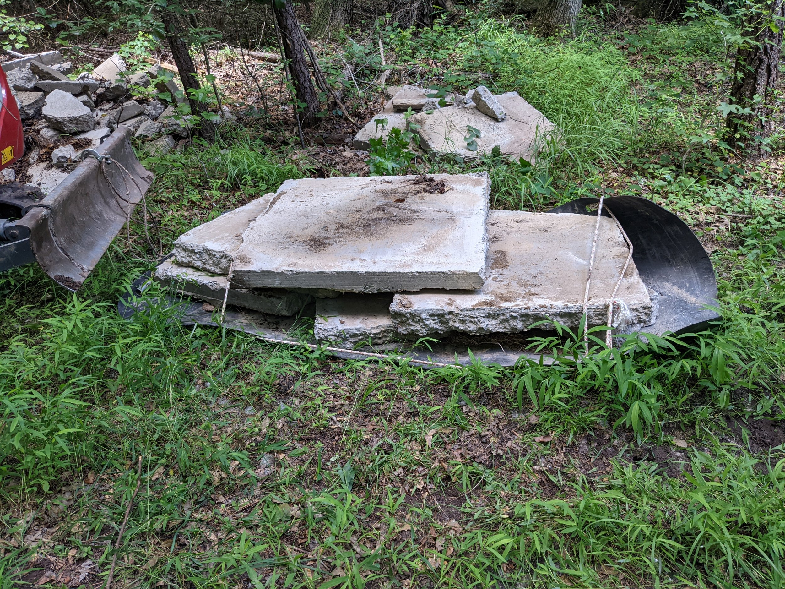

Has anyone else been out clearing trails??? :unsure:

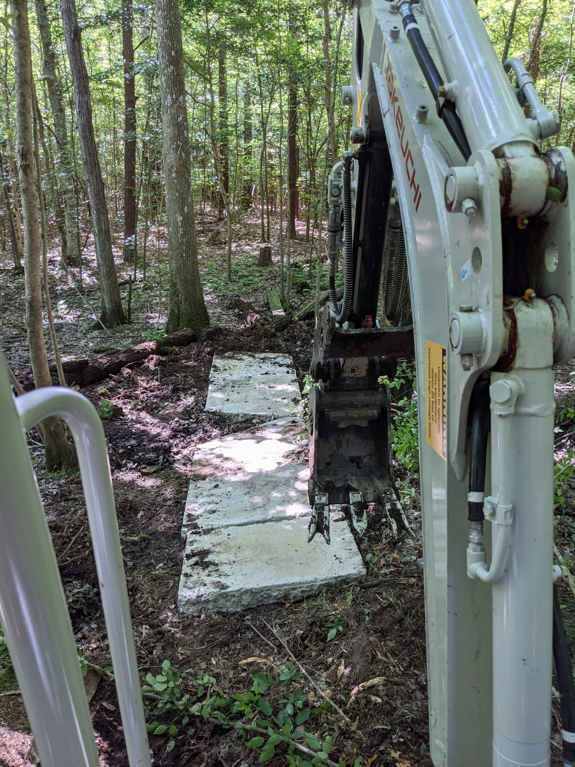

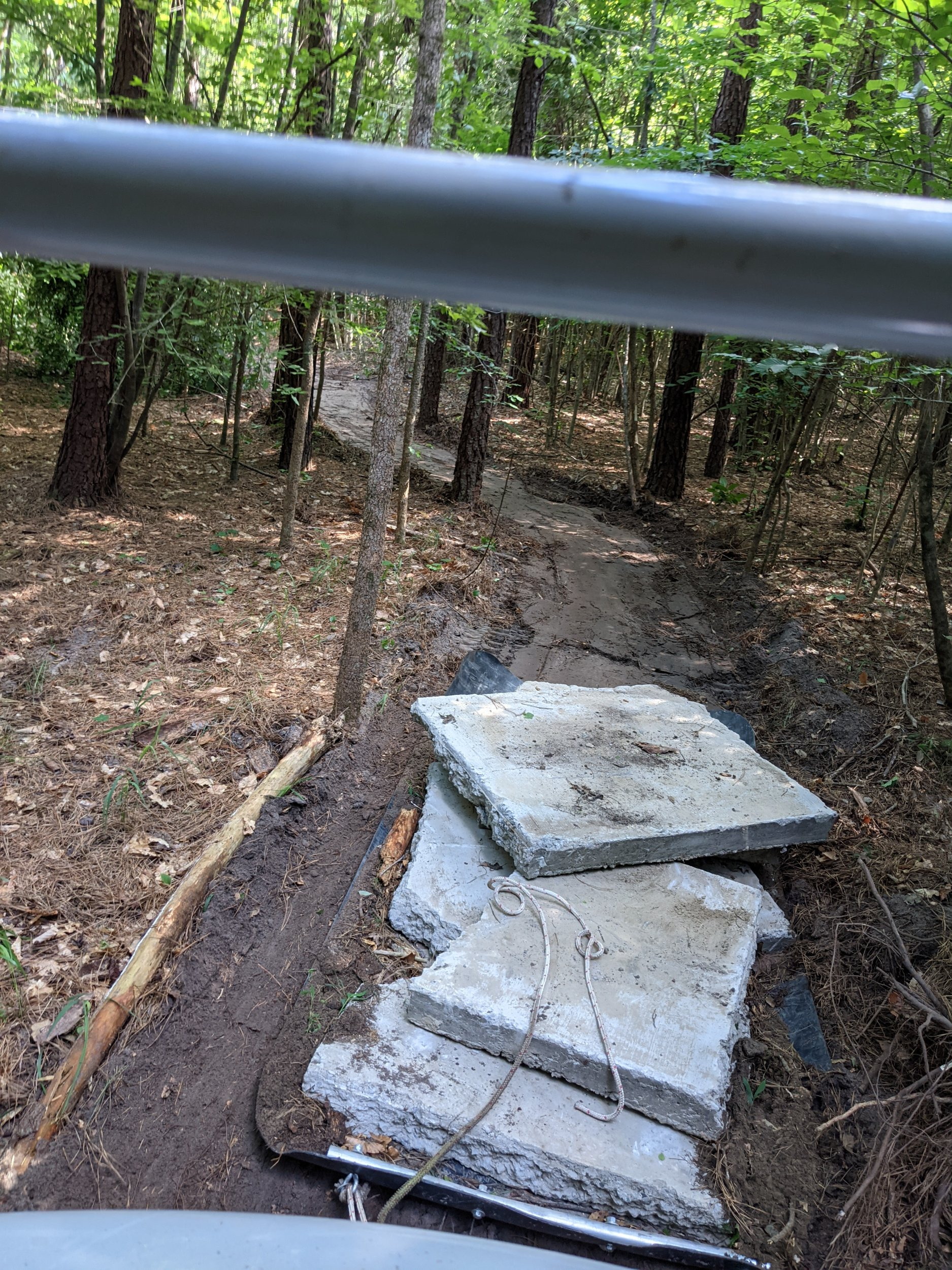

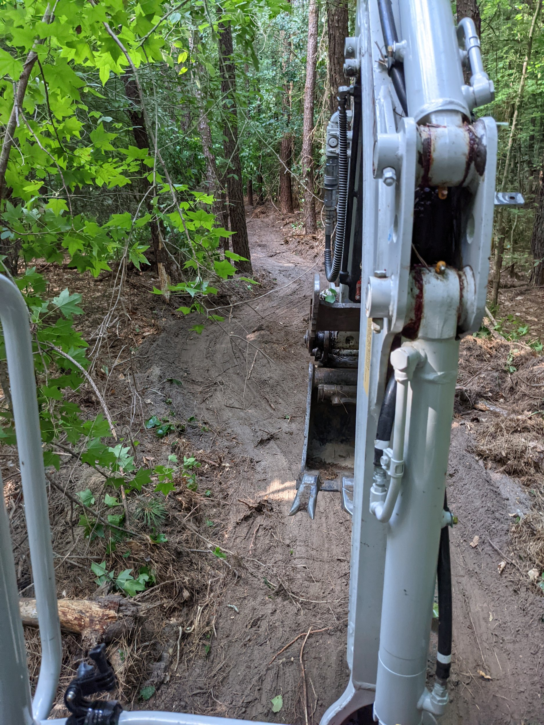

I am slowly widening my old rake and ride trails into something wider/smoother/faster that other people can enjoy. I pulled this sidewalk from a customers job last year and took em home
I finally had time to drag them into a low spot that I didn't want to reroute. It's good all summer but is sometimes wet in the winter.

The cement pads are whats called armor but its anything we put down to control or reduce erosion. Do you ride MB? Thanks for posting.
   / trail clearing technique and tools #125
The cement pads are whats called armor. Do you ride MB? Thanks for posting.
Yeah, no mountains here though. I also use them for dog walks and hunting.
Now you'll have to shovel them.

Nice mini, what's the specs on it? can you run a flail or rotary cutter with it?
Its a tough machine with a big butt.(part of what makes it so good) I just had a Cat 302 at the house for a month demo even though the Cat weights 1500lbs more had has significant more HP it didn't out perform the 216. The boom swing and slew we're the only things better but the lighter Tak could lift more and dig better because of the counterweight of the tailswing.
From the videos I've seen and people talked to it will spin and handle the weight of the smallest Lipa flail no problem, but like most smaller machines it won't track and cut unless you install a priority valve. I've also seen it running Ghendi flail but haven't seen a source to buy that one in the USA.
As much as I liked the AC in the cat I wasn't impressed with anything else. The 216 could lift more even though the bucket on the Cat was much thinner/weaker and probably weighed half as much and the TAG bucket on the 216 + I have a quick hitch adding even more weight.

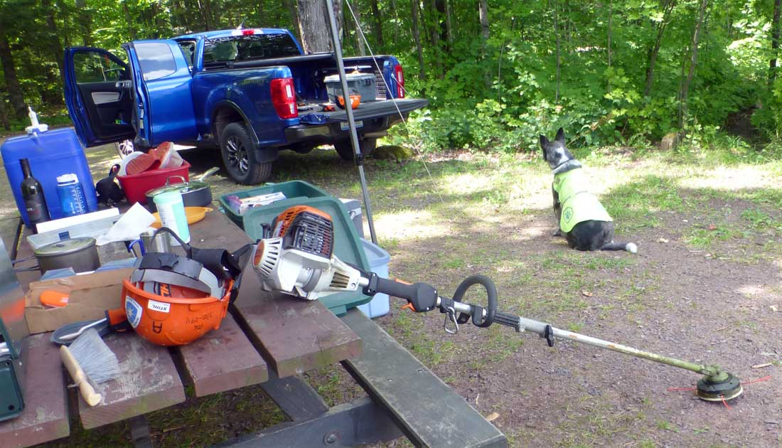

We got back from a weekend of wonderful camping and clearing trails at 2 NFS campgrounds. We had coolish weather which prompted us out.
In this shot, you can see maple whips on both sides will soon be overtaking this trail. They are nearly three feet tall.
I've started to cut them. The .155 string did better on them that I expected and I did not need to change the strings out.
All done! You can see the whip debris everywhere. This is where large string machines rock! (y)

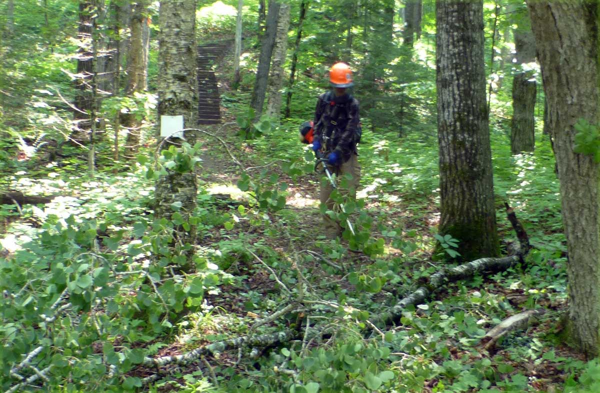

More trail clearing with 155 string. In the background you can see steps already cleared. Of course the pole-saw will be used to remove this dead fall.

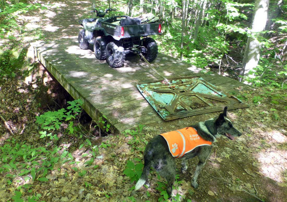

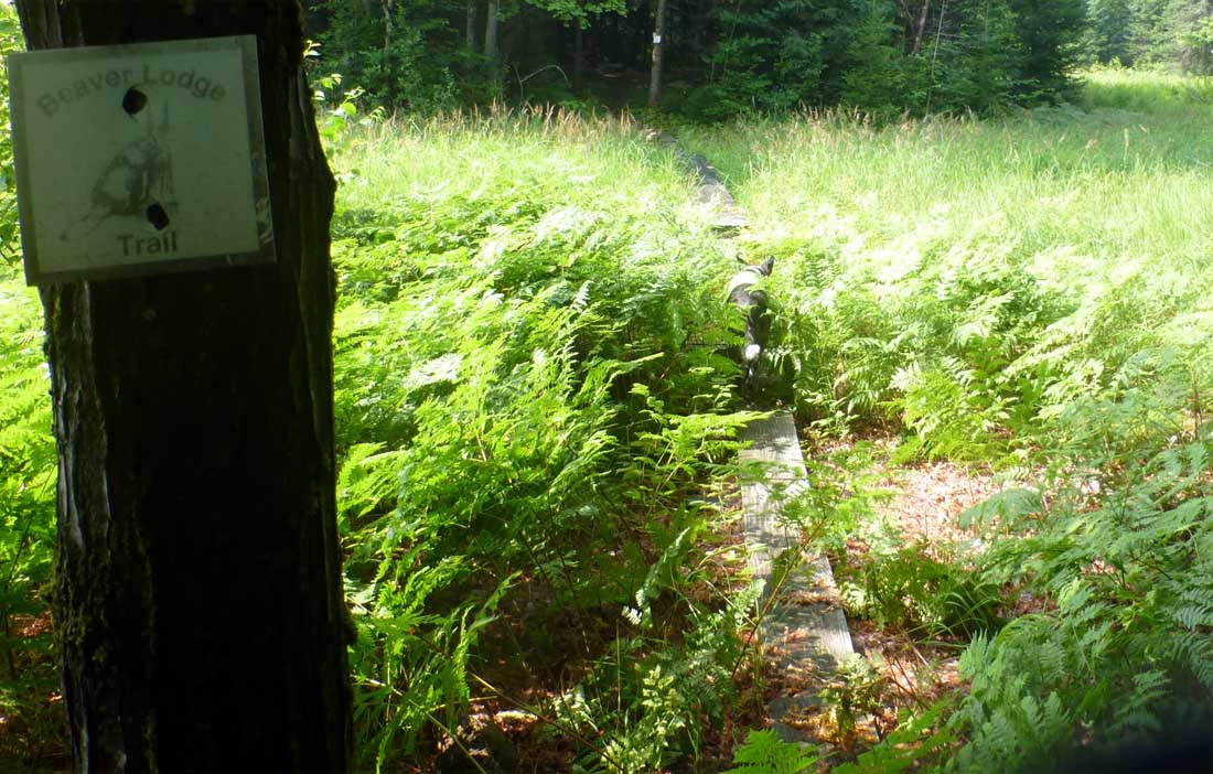

Here is a boardwalk covered with ferns and swamp grass. There is a creek at its middle.

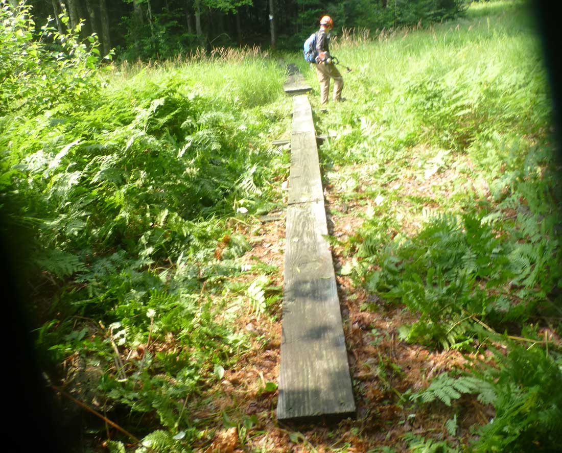

Now we're clearing it.

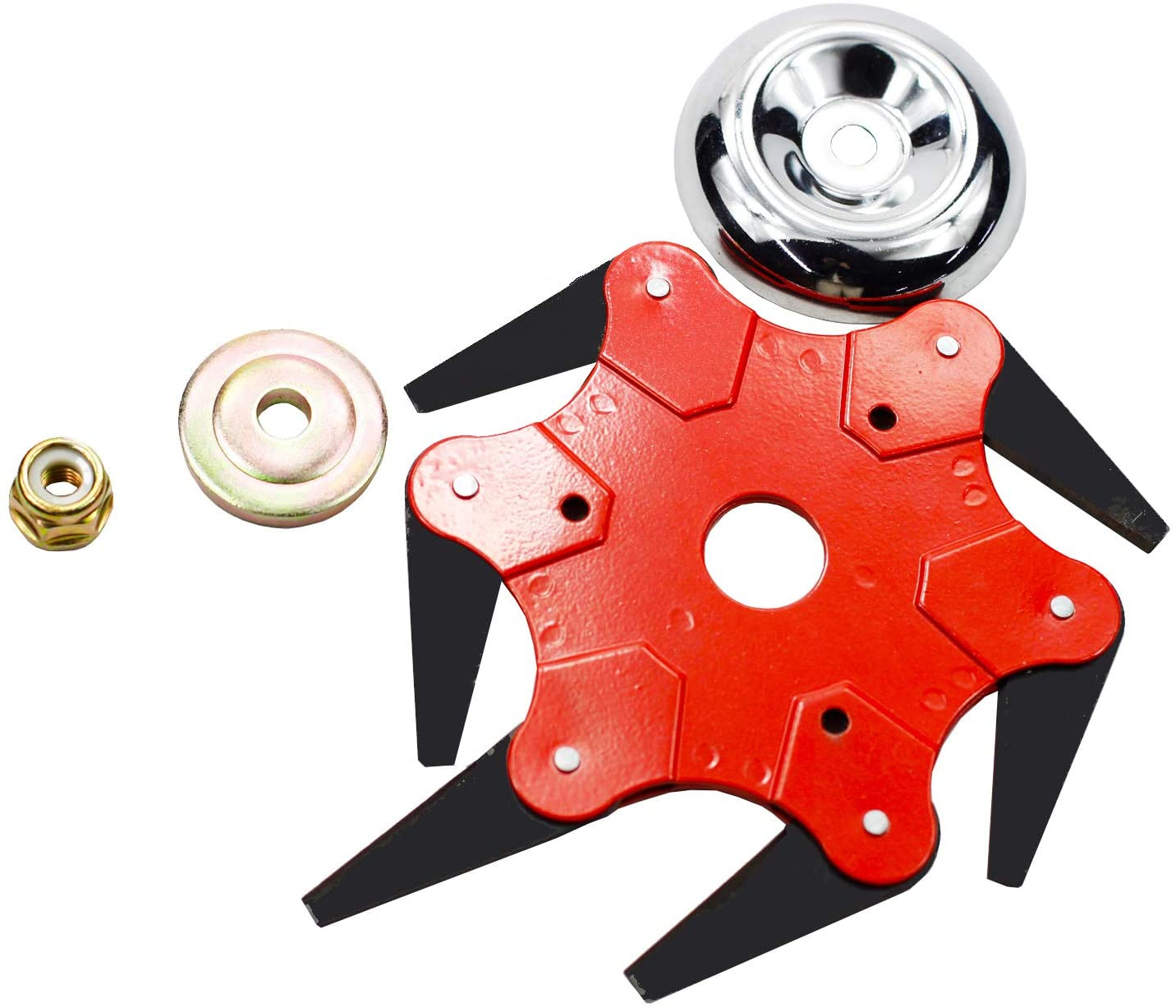

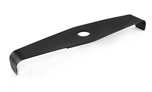

I work like to try one of these blades to cut the shoots down as seen in the above photos. Might be better in the gravel and rocks we work in. :unsure: Has anyone used these?View attachment 699901
I've used something similar with plastic blades. I prefer it to string. Swapping blades is easier than dealing with string problems.. Cheap knockoffs break too easy, so stick to known brands.
#138
We can replace 4 strings in less than 60 seconds. Plastic cutting blades would last us about 60 seconds.
