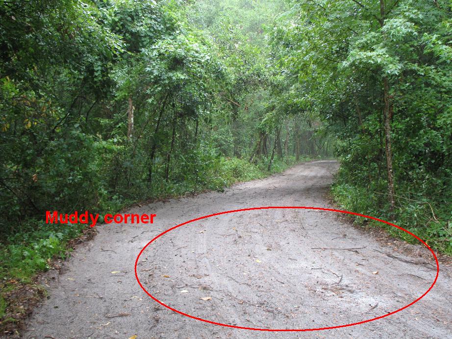

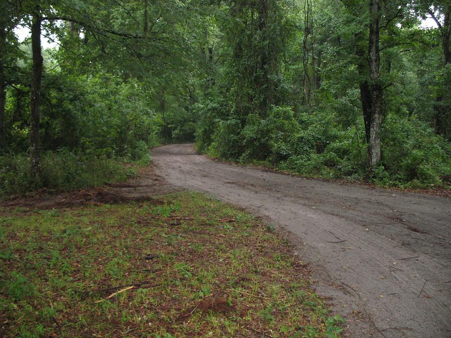

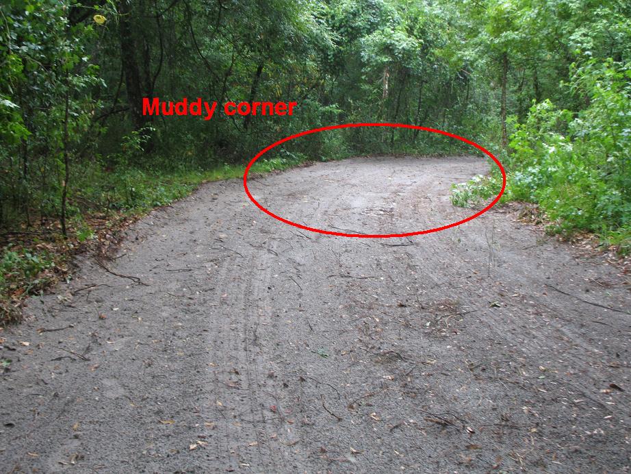

The picture in my original Post #1 is a part of the trail that will not actually end up being part of the driveway, since that area is further back into the property, past where the house will be. But the rest of the trail looked very similar: A somewhat sunken 2-rut trail, sunken from years of the previous owner (farmer) driving on it, splashing the dirt/ mud off the drive up onto the banks ... as many neglected roads have happen (they seem to sink).
So, here are pics of what I did Sunday to the part of the trail that will be the driveway:
First stretch of the driveway, just in off the paved road (facing south in this pic):
attachment.php
First corner, ~400' in from the paved road (facing ~SW in this pic):
attachment.php
Another of that first corner, plus the 2nd straight of the driveway (facing west in this pic):
attachment.php
I spent about 4 hours dragging my new Land Pride GS1572 (6' wide) grading scraper up & down the ~600' long trail. At first I put the shanks all the way down & ripped up the whole thing real good, at a minimum width of 12' to about 14' in others (the 12' wide sections are where I'm limited due to large trees). I was able to remove many, many roots of all sizes from the trail this way. I also discovered that most of the trail is sand, which I think is good. And I was able to drag the clay areas into the sandy areas, to sort of mix them together so the clay is not all at just two concentrated problem areas. Thankfully there's much more sand than there is clay.
I was able to bring the higher road sides back onto the road itself so the trail & surrounding terrain is close to the same level now.
We finally got a little rain Monday, & I drove on this newly ripped up trail, & it seemed better, although the rain was somewhat light & it's been dry here for a long while now.
My plan now is to return this Saturday to establish a circle drive in front of the house location, rip that all up so it looks like these new pics, smooth the whole driveway out one last time, & then have a $437, 21-ton load of the scrap rock delivered, which I'll then spread with the GS.
Any thoughts?
