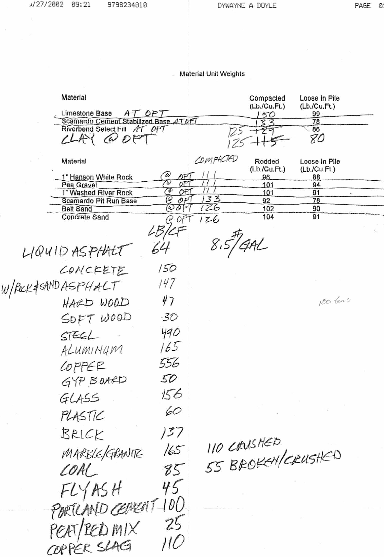

Here is some usefull information on material weights to convert tons to yards. Just do the math based on length width and depth. One cy=27cf

So, if I use some parts of your math with mine, & say I spread the material at only 2" thick (since some of the trail seems OK as-is), & assuming the truck really holds 21 tons (42,000 lbs - Can that be???), by your math I'd get only 60 linear feet at 12.5' wide ... Meaning with my 600' driveway length & a paltry 2" thickness, it's gonna take ten $437 truck loads = $4,370 total ... for a pretty darn thin layer.
OK my math was wrong. I made up an Excel spreadsheet to be able to fiddle with the figures:
When I enter 1.5 tons (aka 1 cubic yard), a driveway width of 12.5' & a driveway thickness of 12", I get the 2' of driveway length Dan stated (2.16' to be more precise). So, a 21-ton truckload should provide about a 30' long stretch using these figures (30.24' to be more precise), & to do my entire 600' driveway would require 19.8 21-ton truckloads, so 20 :), & would cost $8,740.00 ... :(
When I change the thickness to just 2", I calculate that I should get about 180' of driveway length (181.44' to be more precise), which would require only 3.3 21-ton truckloads, so 4 :), & would cost $1,748.00 ... :eek:
That's also helpful - Thanks!
Using the materials from your 1" Hanson White Rock thru Concrete Sand, it looks like 111 pounds per cubic foot is reasonable for these guesstimates, which would be 3,000 lbs per cubic yard ... same as Dan stated.
