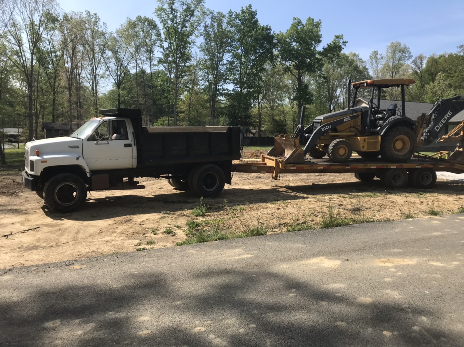

I tow my Kioti nx5010 with a 14,000 lb. 20 ft bumper pull. U will need a weight distribution hitch.

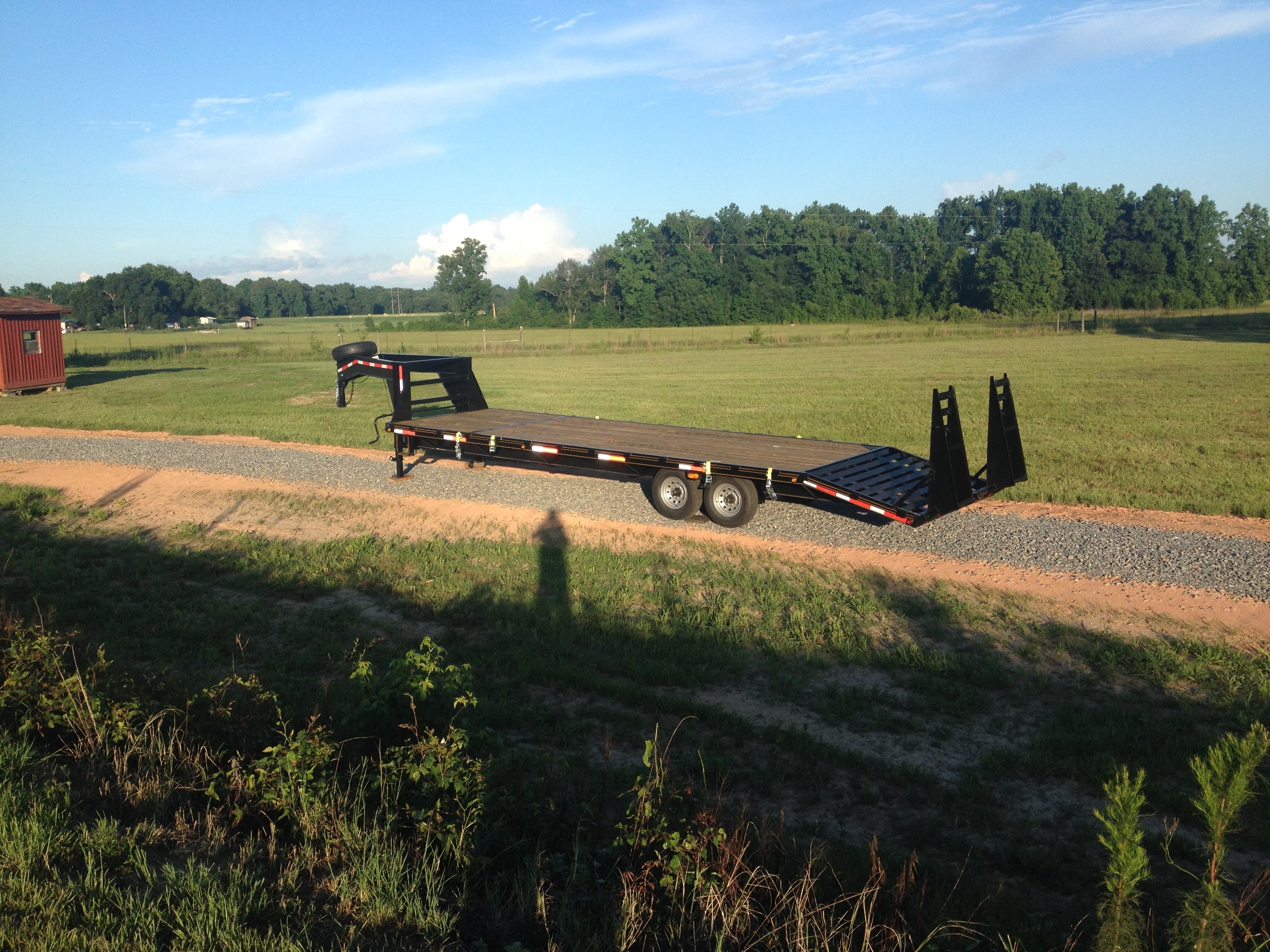

A GN trailer would be way better especially using a half ton.
/ Trailer Advice #23
Trailer capacities also figure in tongue or pin weight. So its possible for a 5200lb dual axle trailer to be tagged at 10,000 lbs capacity as they are expecting like 1200 lbs of tongue weight (1200lbs+400 lbs = 1600lbs the trailer weighs giving you 10,000 lb capacity on dual 5200lb axles) You typically dont see this extend into the 14K bumper pull trailers as they weigh more and it becomes a difficult task to tongue weight 1800lbs on a pickup. (however 2000+lbs pin weight for GN is common)
