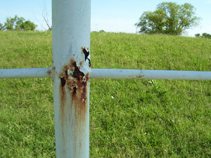

OK I got out to look the steel pipes over. They are used pipes (I knew that) I think from drilling rigs. The ones I was interested in are 2 3/8" OD with 3/16" wall thickness and 31ft in length for $39 each. So those doubled up ought to be pretty darn strong, I would think. I still need to compare rectangular tubing in 2"x4", but unsure of what wall thickness I would need. I guess price out the 3/16" to be as close to a true comparison.
Question; If I went with the ladder style truss, with only vertical sections of pipe welded between the 2 horizontal pipes, about every 12" or so, would the vertical pipes need to be the same thickness or could I get by with .090" wall?

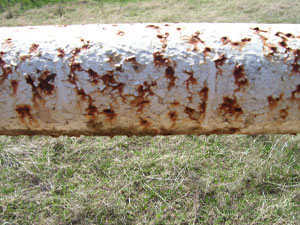

Be very sure of what you are getting. Oilfield pipe that has had saltwater run through it will rust through from the inside and difficult to keep painted: How to Buy Pipe - A Guide to Pipe Buying - GoBob Pipe and Steel
   / Trailer build question #37
Strength depends on how far apart the horizontal are ( how long you make the verricals.) But being 2-3/8, even with no separation they should be as strong or stronger than the 2x4 tube. But heavier also.
For $400 I think you can get some channel from a supplier and be done. Round us a PITA to work with.
There is a reason you don't see tube of.any kind used on most trailers. That's because the concern of rusting inside out as mentioned. Especially with used material. Channel, angle, and i-beams can be painted all the way around.
