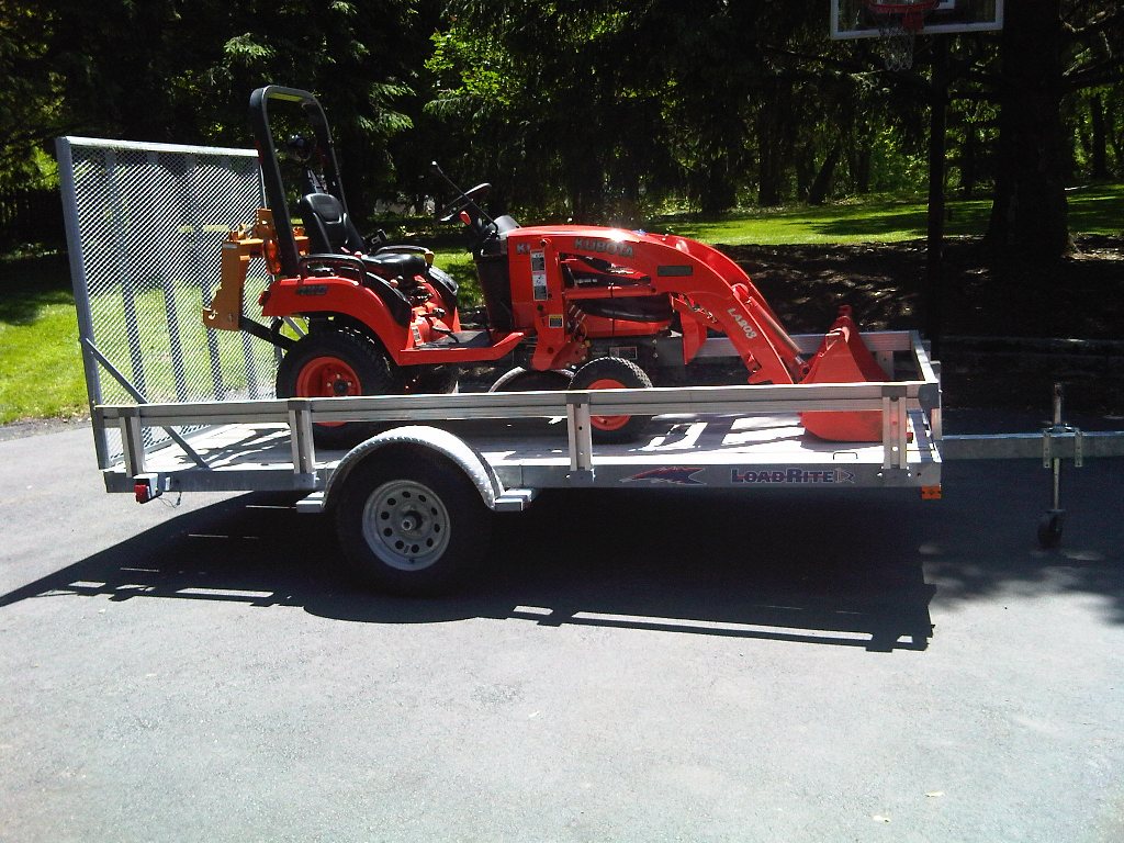

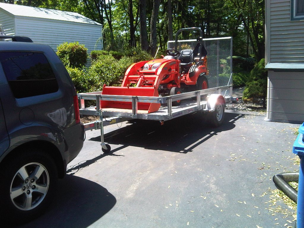

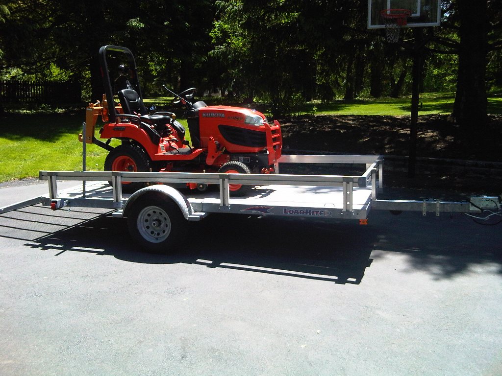

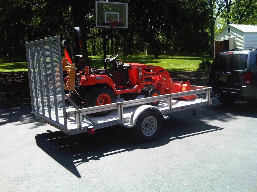

Here it is, took for a ride and it rides and hauls very nice. I still need to figure a better way to tie and secure the tractor, I am using the strap type to secure it but thinking to get a chaine setup.

Looks to fit on there fine. The front rail looks to be removable via a few bolts, I'm betting if removed the tractor could be moved forward enough to get the chipper on too or just put the loader over the rail. Weight distribution may be off though.
Have you checked the tongue weight with the present positioning?

All railings are aluminum and are removable with few bolts. I didn't get a chance to weigh the tongue, I read some directions on it.
Any thoughts on best way to do it?
What would the weight mean when done?

Conventional wisdom claims the weight should be 10-15% of the gross weight, so assuming you are pretty much near the trailers 3500GVWR the tongue should be 350-525#'s. If a bathroom scale doesn't go that high there's a method using the scale, a block and a board which can get you close.
I personally find it easier just to determine what tongue weight you want then have yourself, your wife,and/or kids (whatever approximates the total weight) sit on the bumper then measure the ball height. Hook up the trailer and position the tractor until the ball is at the same height minus an inch for good measure.

Straps are fine... I have used both over the years.
I have 5K straps that are more than strong enough for your use and easier thank chains /binders... Just place some chafing gear if running over a sharp edge. Check with local fire dept, Old 1 3/4 hose in 2foot seconds works great split down one side...
You'll find a huge strap vs chains arguement ...but whjat ever works for you...
Like I said I have uised both...
