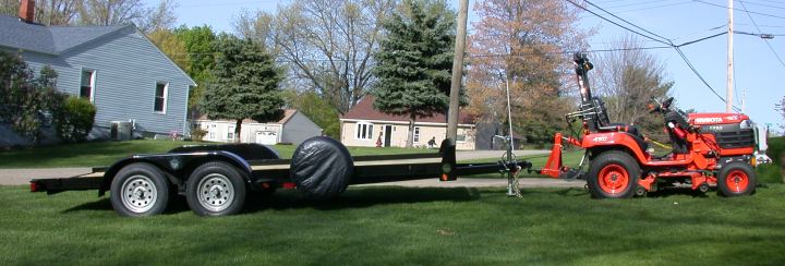

mow4fun, I had a 3K (3500# axle) 6X12' with no brakes and the BX2230 fit and hauled fine with my F150. Then I added a loader and counterweight to it and backing the tractor onto the trailer I could not set the bucket on the floor of the trailer, it had to sit against the ramp gate. With the BX it seems to be a matter of length not really the capacity of the trailers (talking about 3500# axle trailers). I just sold that trailer and bought a 16' tandem with four wheel brakes. Bottom line the BX with a loader and anything on the back will not fit well on a 12' trailer. I like having the brakes much more than not having them. The old 12' trailer was well built and weighted around 900# the new one weights 1650# so it is not that much heavier for what you are gaining. Having owned both I recommend a 16' dual axle with brakes, mine is a Gatormade and it only cost $1850 + tax, they are allways on E-Bay. It seems like a well built 6'-4" X 14' trailer with one 5200# brake axle would fit our needs, but I have never seen one?
